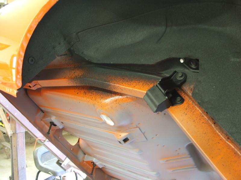

I don't recall where I got this (restoration) photo, but it shows a fairly production-typical rear wheel well undercoat/sound-deadener application. The Assembly Manual only shows the front wheel well application - the rear was done by Fisher Body.

Mine looks the same as JohnZ wheelwell,the entire well is undercoated and so are my front wheelwells.
It is mine COPO I restored a few years ago.
