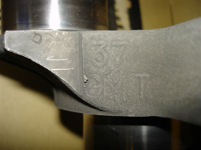

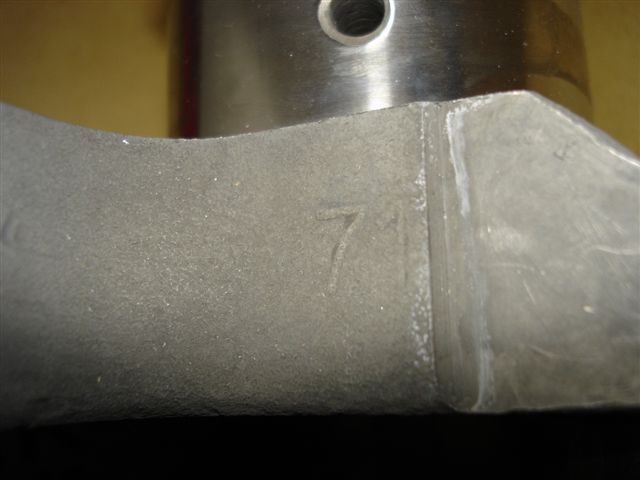

Is it possible to identify the crank I bought together with a #512 block, just by these numbers ?
First pic: 71..

Second pic: ..37 GMT

That's a '7115 ( L-88 -or- ZL-1 ) crankshaft. I have one
just like it. Nice prize if it's std./std.

One more thought. If that crank belongs to the '512 block
it came out of, well then you know what you may have.
Is there a code on the stamping pad?

They didn´t make any L-88´s using the #512 biock, did they ?
The block was cast in November 1969. And it has been decked so there are no codes anywhere.
Are there more things on that crank that would identify it as a #7115 ?

I just compared this crank with a 6223 I have in a shortblock, and the counterweights are the same size. The third one from the front is 3/4" (slightly less than 20 mm) on both cranks. Don´t know about the 6223, but the 7115 is crossdrilled. It has an X on the foremost counterweight that looks like it was made at the factory. The X is very deep into the crank.
Still think it´s an L-88/ZL-1 crank ?

I have '6223 cranks with the '6223 and 3856223 part designations.
I have '7115 cranks with the '7115 and '71 part designations.
Honestly, the width of the counterweights on your '7115 crank has me confused
You may wish to expand this thread over on the NCRS.ORG site
as those guys can tell you for sure. Please keep us posted
in you learn more.
Steve

Alan Colvin's book on page 81 explains that the 3rd counter weight in the 427 is bigger than the 396 because of the weight of piston. he states the 396 is 7/16" and 427 is 7/8".

So they must have made `7115 cranks for 396 engines then ?

6223 is the 396 crank and the 7115 is the 427 crank.
