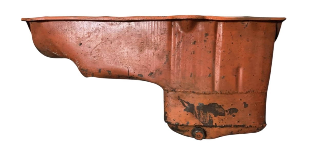

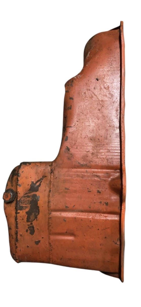

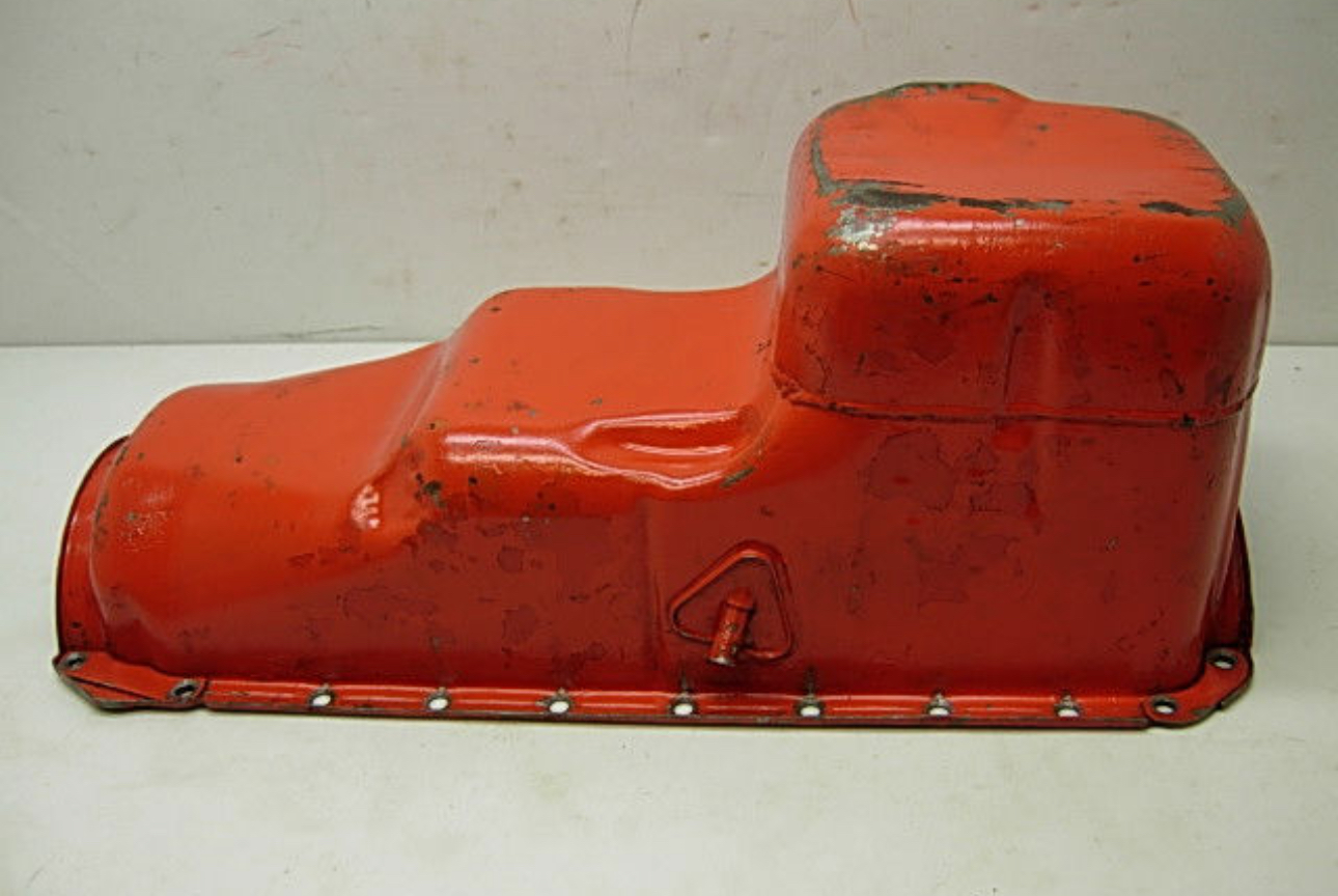

Any chance this is a over the counter gm pan simular to the l88 pan ?

No, it is not! The factory deep sump oil pans have only one weld line going around the sump. It is close but not exact. Impala pan modified by owner by adding a strip of metal between the sump and the upper part of the pan.

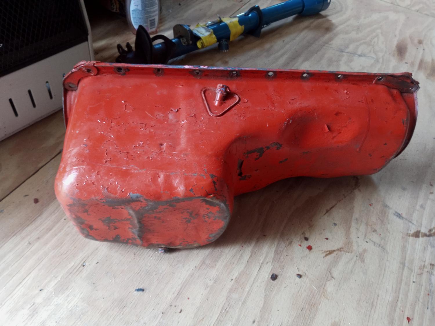

Here is the one i have

jl8z28... What is that supposed to fit? 67-69 BB Impala?

Im trying to find out what it's for

I believe this oil pan was fabricated by someone.
