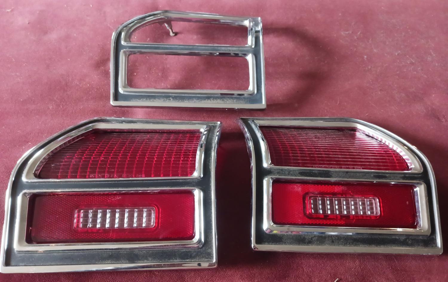

A little helpful hint for anyone using repop 69 Chevelle taillight bezels.
Got these with a stash of NOS 69 sheet metal and other things.

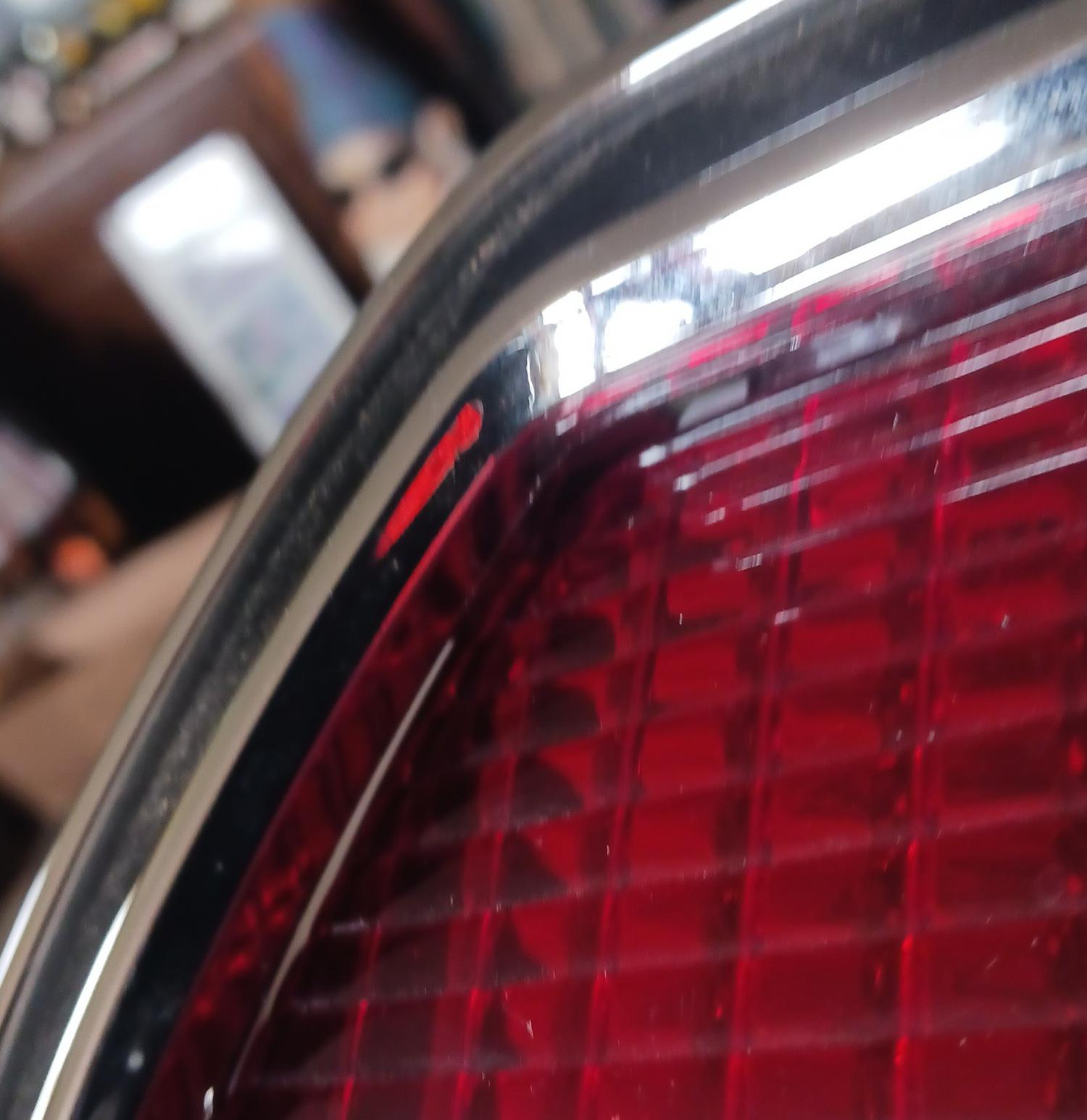

Biggest issue is the lens [repop] does not fit flush on upper outer corners of repop bezels.
Pic 1 is repop both and you can see gap between lens- bezel upper- outer corner.

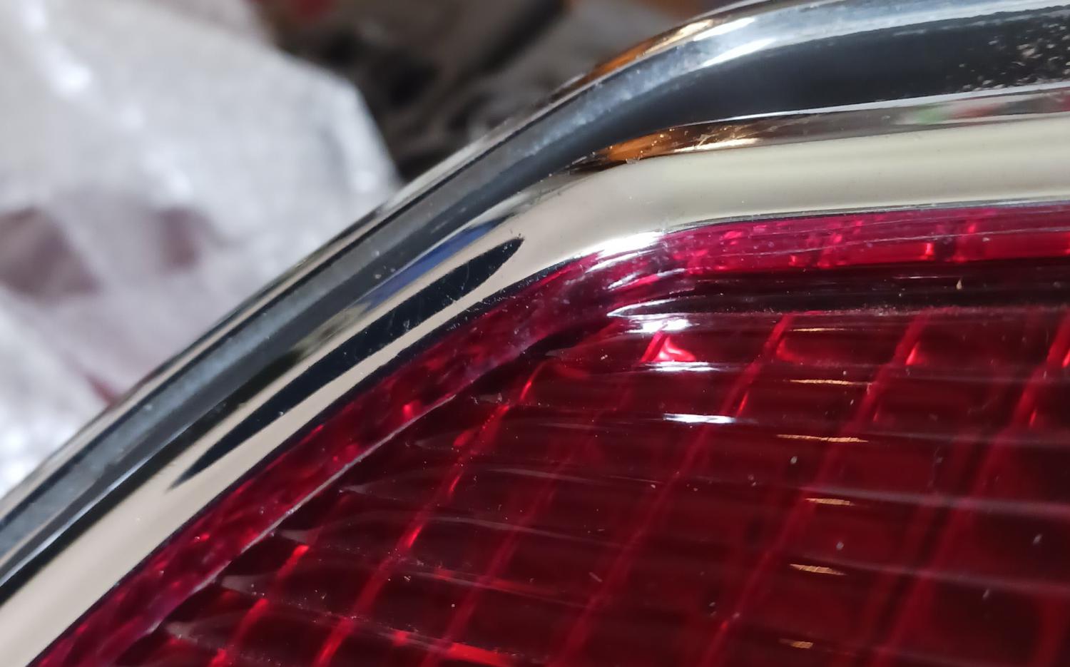

pic 2 is original bezel with same lens and it fits fine

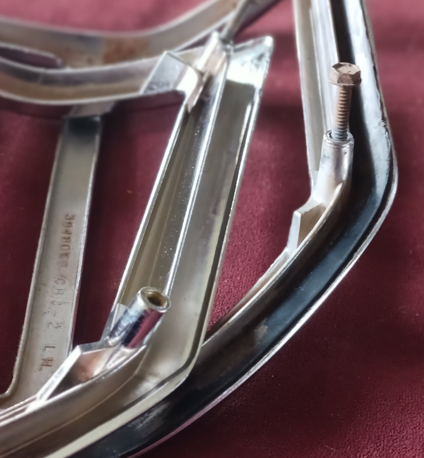

Pic 3 shows the upper outer ledge the lens sits against is too tall on the repop.
It is on top of the original bezel.
Last pic is overall with original above repops.
With a little grinding on that ledge they are not bad.
