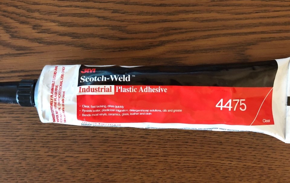

I used this on the dash of my El Camino and it's held up real well. You might try it. 3M Scotch-Weld Industrial Plastic Adhesive #4475.

I've used that 3M #4475 Industrial Plastic Adhesive and have no complaints.It's flexible to some degree too.
