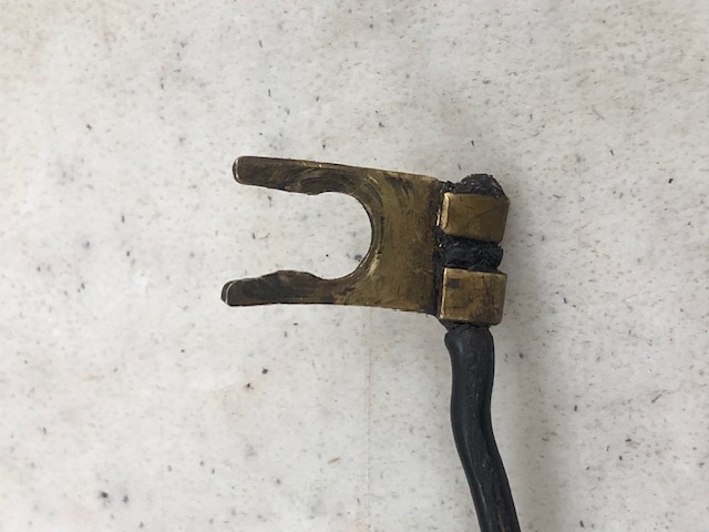

Anyone know a source for these? Not having any luck opening the wire contact tab, soldered maybe?? I've been on AAW's site and others, no luck. The dist. lead wire the Corvette vendors sell is a cheezy joke.

Forked-Flag terminal.
I missed out on a large NOS Delco qty on ebay
Agree the generic replacements look nothing like geni items

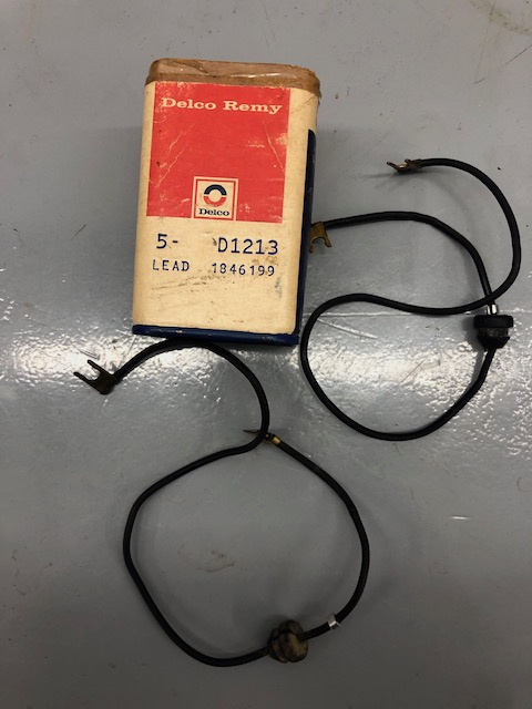

A big thanks to my friend Bob Jones (L79 Chevelle) from PA! Bob sent me these NOS leads that he had on his shelf, thanks Bob, I owe you one!! - Bill W
