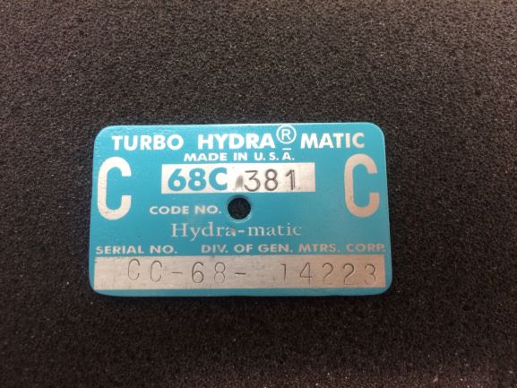

Does anyone know where I can get a TH400 transmisson tag background restored. I have an original TH400 trans tag but the only thing left on the tag is the stamped items.The background is gone and I want to have it reapplied around the original tags stamped data. I dont want an reproduction tag. Has anyone done or know of anyone who does this?Thanks

I was in the same boat as you a couple of years ago. My tag was pretty beat up. After unsuccessfully trying to find a company that could restore my tag I decided to recreate the artwork myself. The problem I ran into was that a silkscreen type process was not capable of achieving the resolution of the letters and lines from my artwork.
I was fortunate in that the company I worked for had the capability to take my artwork and create a cliche from it. Once the cliche was made (essentially a negative from my artwork) and the bare metal cleaned up a bit, a specialized machine (almost like a pad printer) was used to lay down the ink in the negative. The end result was a restored tag that is nearly identical to the original. I've attached a couple of before and after pictures of the tag.
I'd be happy to provide you (or anyone else) the artwork I created but I no longer work for the company that helped restore the tag so I'm afraid I can't help in creating additional tags. Armed with the artwork, you should however, be able to find a company that can make a cliche and lay down the ink on your tag. BTW...the rivet that holds the tag to the transmission is still available from GM using part number 8622361.
