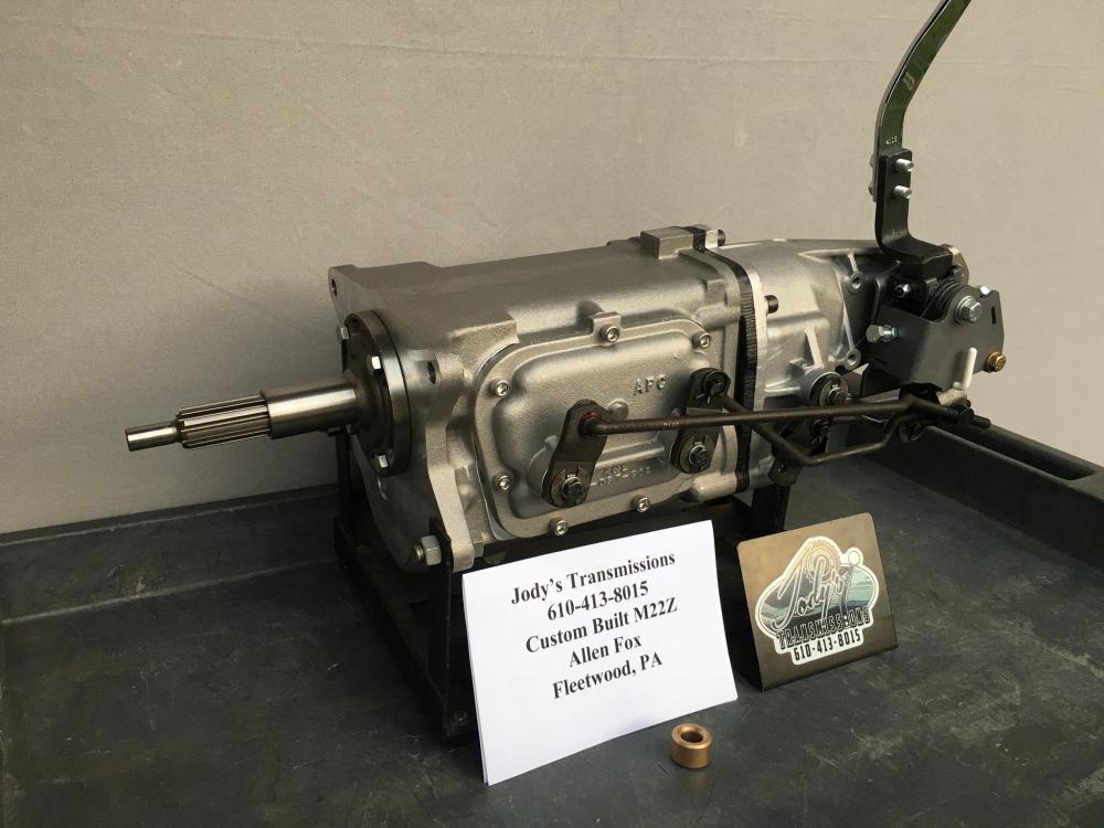

I just went through this debacle with our '69 Nova SS, and none of these will work without modification. I bought the Camaro unit that the mail order companies list for Novas, lucky for me, we have a '67 Camaro - it's now going to receive a 4 speed conversion with the Hurst shifter & install kit that didn't work in the Nova!
What you need is the 'Special Build' shifter that Hurst makes specifically for this application. We used it, and it fit perfectly. I met a guy from this site years ago, Jody Haag, and he has bailed me out several times on stuff like this....
Marlin
Old 04-04-2017, 03:00 PM
JoeC JoeC is offline
Location: ri

I intially ordered 391-4339 because I know that there are no significant differences between the '68 & '69 Nova trans & shifter mounts. What I actually received was the Camaro shifter, and it was immediately clear that it would not work! The shifter arm will hit the tunnel and console opening in 1st & 2nd gears.
The Special Build unit has an 1.5" offset at the base of the shifter arm that allows it to work with console Novas.
Marlin

that looks like a nice HD trans
not sure why they call the 391-7875 a special build shifter it looks the same as the one that that has been used for many years. Same 90 deg offset design used in the 69-72 Chevelle Hurst shifter.
391-7875 is listed under that same number in my 1987 Hurst catalog for the 1969 and 1970 Nova with console
did it come with the 4106 chrome stick?
the 67-68 Camaro shifter used the 4106 stick
