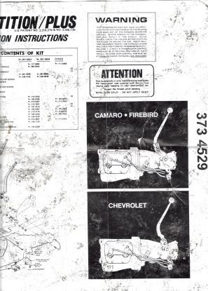

YENKO DEUCE REGISTRY 04-04-2017 03:19 PM
1 Attachment(s)
I think they just never changed the listing.
I intially ordered 391-4339 because I know that there are no significant differences between the '68 & '69 Nova trans & shifter mounts. What I actually received was the Camaro shifter, and it was immediately clear that it would not work! The shifter arm will hit the tunnel and console opening in 1st & 2nd gears.
The Special Build unit has an 1.5" offset at the base of the shifter arm that allows it to work with console Novas.

the Hurst 391-4339 is the shifter and chrome stick
the install kit is separate and has the rods and levers mt plate etc.
the install kit is different from 68 to 69 because 63-68 Muncie used small slot levers and 69-74 Muncie was changed to larger slot also rev light and steering wheel lock out rod change
JoeC 04-04-2017 05:17 PM
that looks like a nice HD trans
not sure why they call the 391-7875 a special build shifter it looks the same as the one that that has been used for many years. Same 90 deg offset design used in the 69-72 Chevelle Hurst shifter.
391-7875 is listed under that same number in my 1987 Hurst catalog for the 1969 and 1970 Nova with console
did it come with the 4106 chrome stick?
the 67-68 Camaro shifter used the 4106 stick
