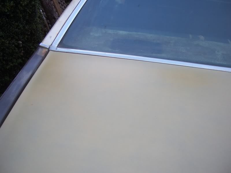

I bought Rainer's '66 396 Caprice 2dr HT, and its an original M-M Aztec Bronze/Bronze car. Its apparent to me that this is one of those colors with a lot going on, color and sunlight wise, and probably is hard to duplicate properly. If anyone has some insight on a good modern BC/CC mix that does it justice, please post or PM me.

Contact AutoColorLibrary.com for the paint. Good people over there. Ask for Jimmy Chips...Joe

I guess it depends on what you are expecting. Paint formulas have changed a lot over the last 40+ years and then there is the base coat clear coat thing. I personally like the look of the way they were when new rather than the two stage paints of today that has the wet look.
Unfortunately many places won't sell lacqure (sp) paint anymore and many shops won't spray it if you have it.
If you are trying to match the actual color the car WAS from the factory, find some paint that was not effected by the sun from under the trunk or carpet, etc. for a color match. I recently talked to a guy that had 5 different factory showroom color books and the color he was looking at was slightly different shades in each book. That is what we saw on the cars too back in the day.

Tom, I just ordered some Olympic Gold here; http://www.automotivetouchup.com/auto_paint.asp

I received the paint from the company listed above. I dusted a light coat over light gray primer just to see how it looks. It is fairly close to the inside of trunk and door jambs. I will use a darker primer and test another area. Don't mean to hijack the thread but does anyone know the correct primer color that would be under Olympic Gold on a 69 nova ?
