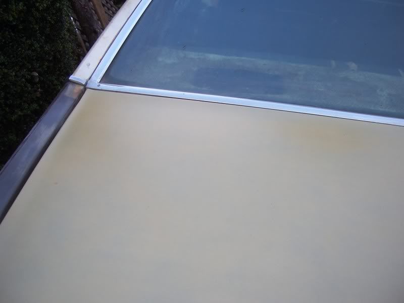

x Baldwin Motion 11-05-2009 01:31 AM
Re: Best modern paint mix -'66 Aztec Bronze -"M"?
http://i134.photobucket.com/albums/q...3/102_9959.jpg
I received the paint from the company listed above. I dusted a light coat over light gray primer just to see how it looks. It is fairly close to the inside of trunk and door jambs. I will use a darker primer and test another area. Don't mean to hijack the thread but does anyone know the correct primer color that would be under Olympic Gold on a 69 nova ?
Thanks in advance. https://www.yenko.net/ubbthreads/imag...lins/smile.gif
