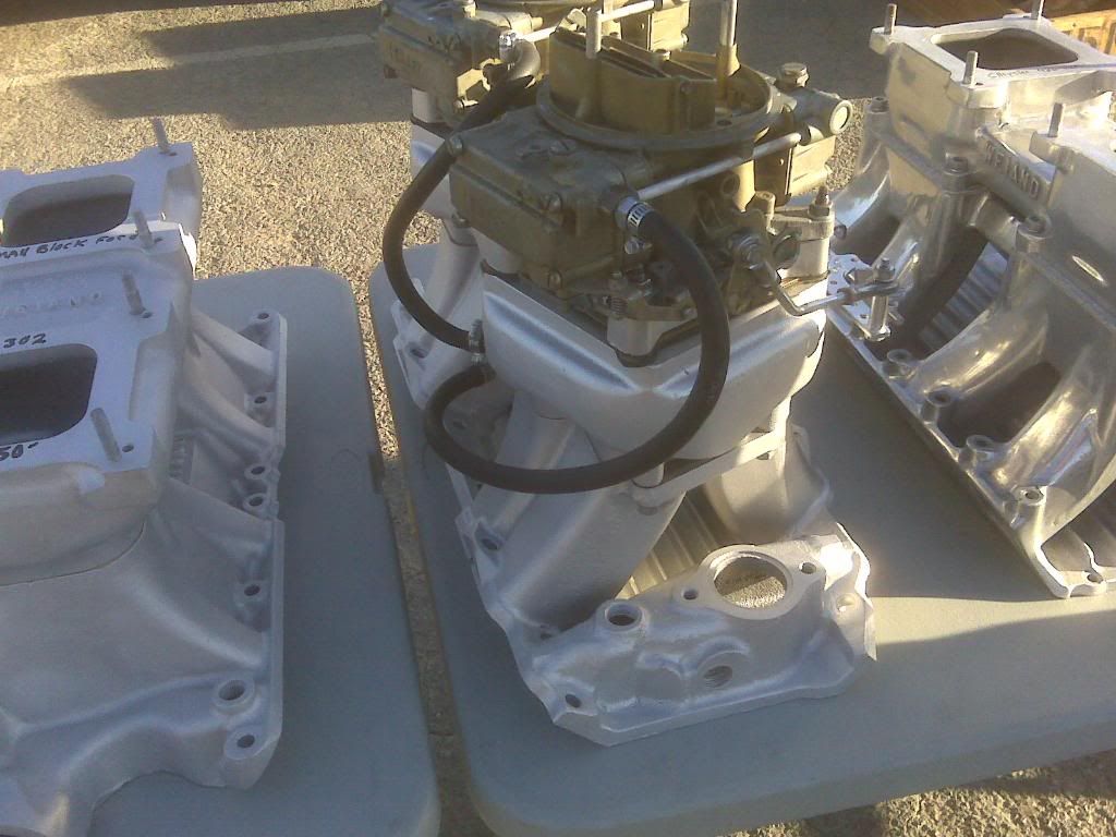

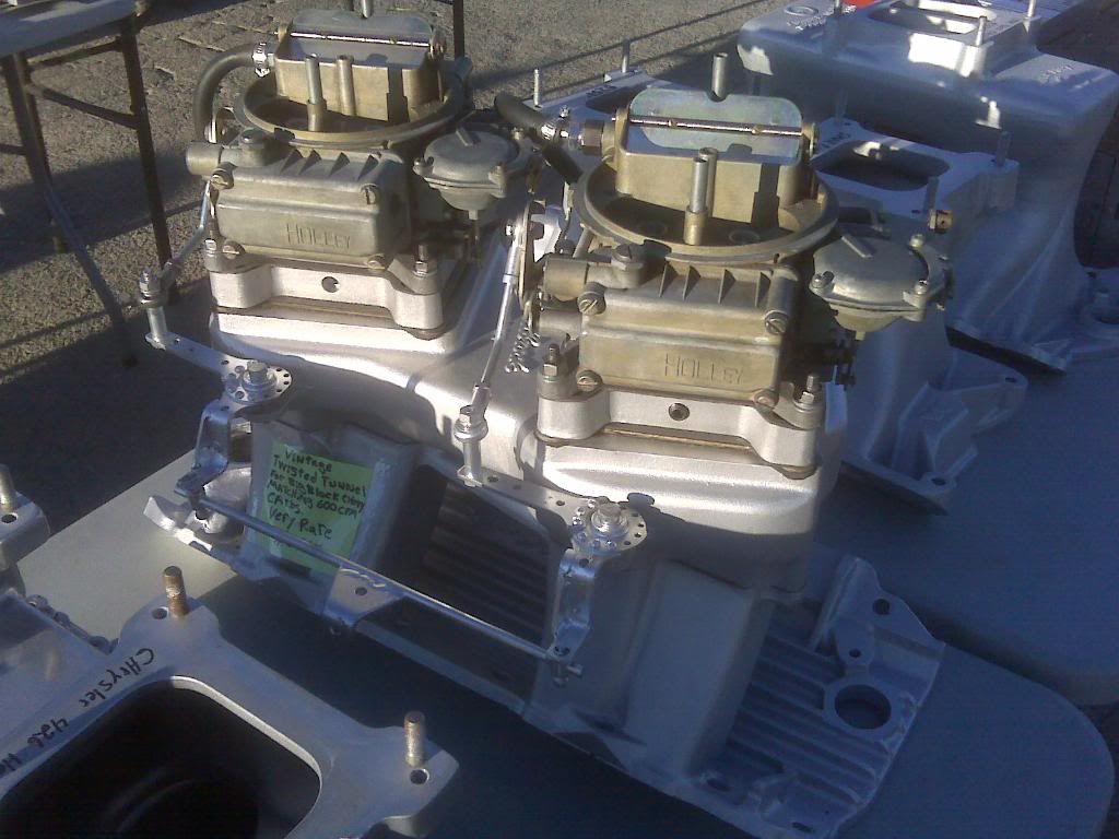

ssl78396 09-17-2012 04:38 AM
Re: period correct tunnel rams
<span style="color: #3333FF">Wow..this was a first.
What's the time period on this one ? </span>
http://i745.photobucket.com/albums/x...2-09-16001.jpg
http://i745.photobucket.com/albums/x...2-09-16002.jpg

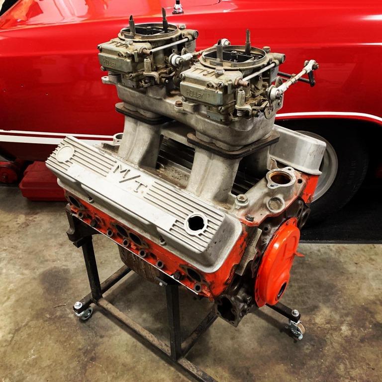

Glenn70 09-17-2012 12:40 PM
Looks like Joe Sherman used that manifold back in the mid 70's to run well into the 9 second range with his 70 chevelle. Was made for dominators looks like adapter plates on the one shown.
