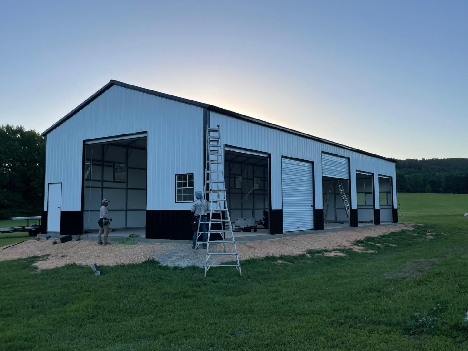

I just had a 2,100 SF shop built with 14 foot sidewalls and 19 feet at the peak and currently researching options for cooling / heat without breaking the bank. I did go with insulation during the install, but potentially will supplement that. Shop is in North GA, so not too concerned about heating it, more so cooling. Looking at using several mini splits as I don't think I'd get enough air circulation from a single wall unit. Think I need at least 40,000-50,000 btu. Curious what others have done.

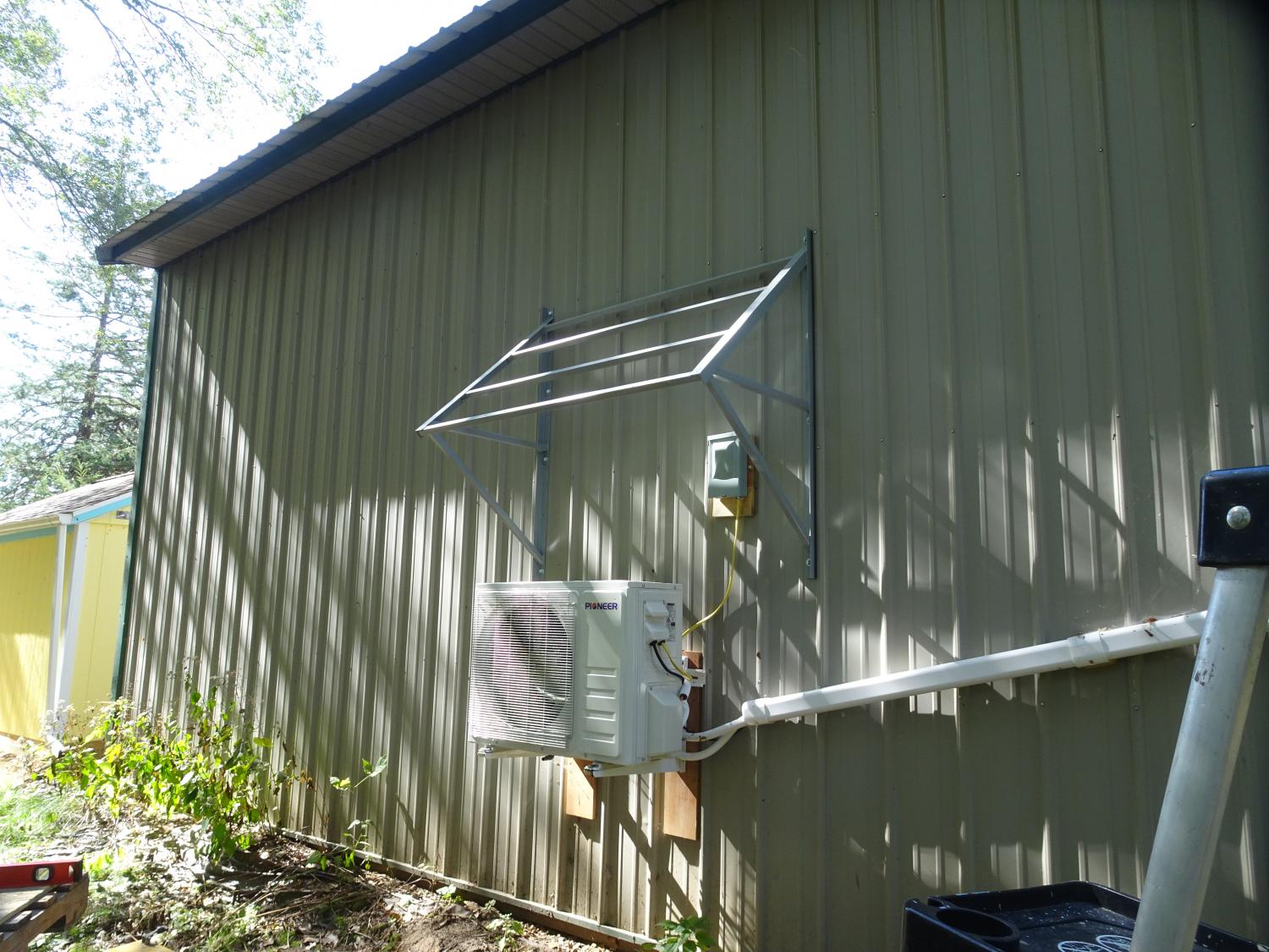

It does cool well, but I still haven't figured out how to set a steady temp. It seems to pull warm air off the ceiling and keep cooling long after the temp I want has been met at 6', BUT the unit is 10' off the floor...
Hole in the wall is 2 1/2" and angled down slightly to provide slope for the condensate drain, which does go out the wall, not to the floor. No power needed at the inside unit. Mine is the 240 single phase and all power goes to the compressor and then follows the coolant lines into the wall unit.
It is quiet !! The blower can be heard on the higher speeds, but it's nothing worse than a floor fan would be. The fan speed can be set lower and then I can barely hear it, but I'm half deaf too... LOL The compressor is nearly silent standing near it outside. I never know it's running in the building.

While installing mine, I found 2 steps that weren't clear and called support. They agreed the manual wasn't as good as it could be and have had many inquires about those steps and had a ready answer. So far, excellent support to keep the install moving too. I need to call them about the set temp not being met. Again the manual isn't helpful to know if the temp sensor is on the evap unit or in the hand held remote. I've tried setting the remote closer and at 7' above the floor and it still runs beyond the set temp. They probably have a ready answer for that too, but I just haven't asked.

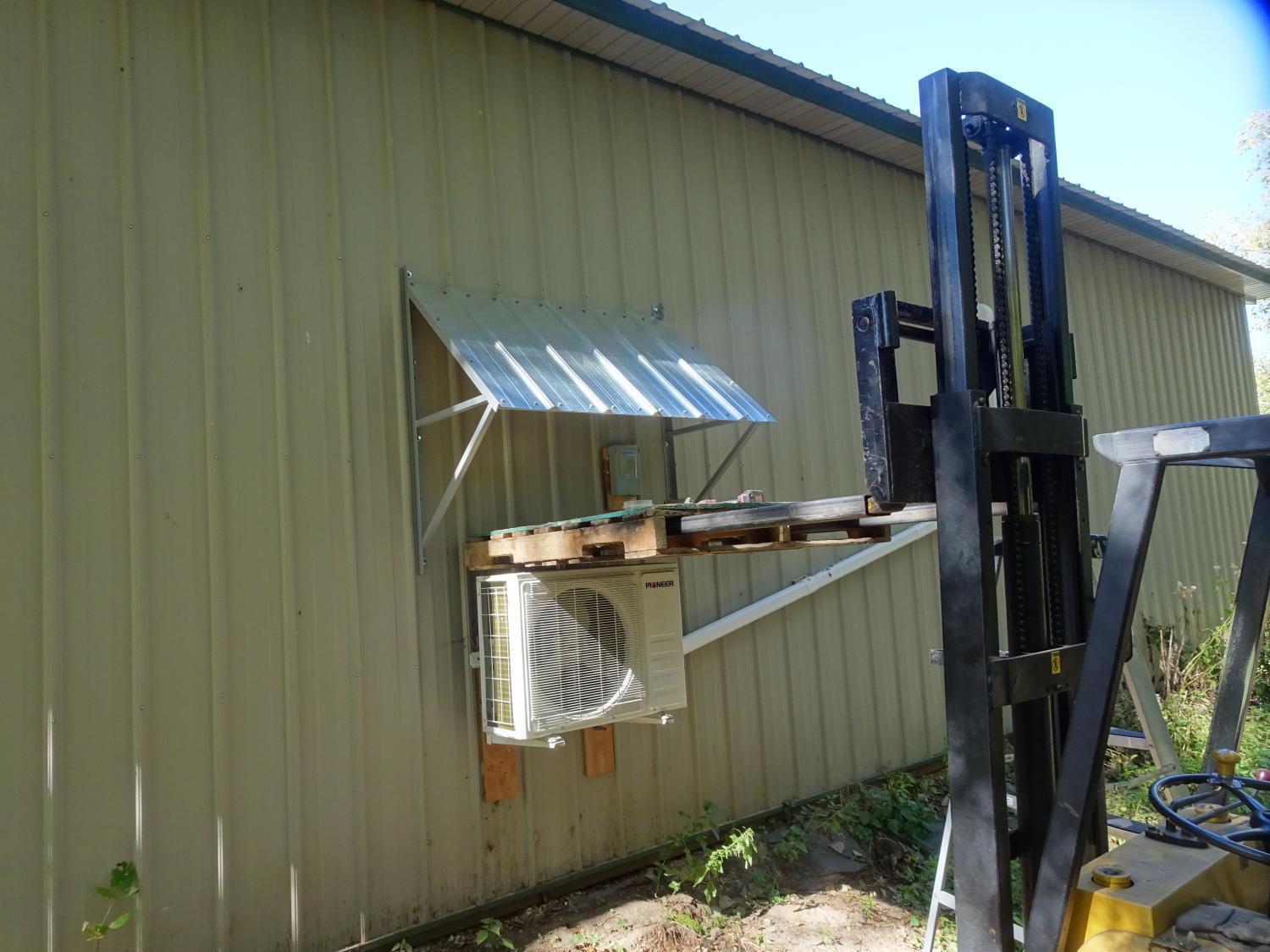

I built a heavy duty awning to deflect heavy snow when it slides off the roof.
Mitch
