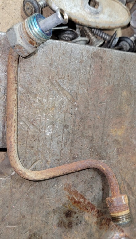

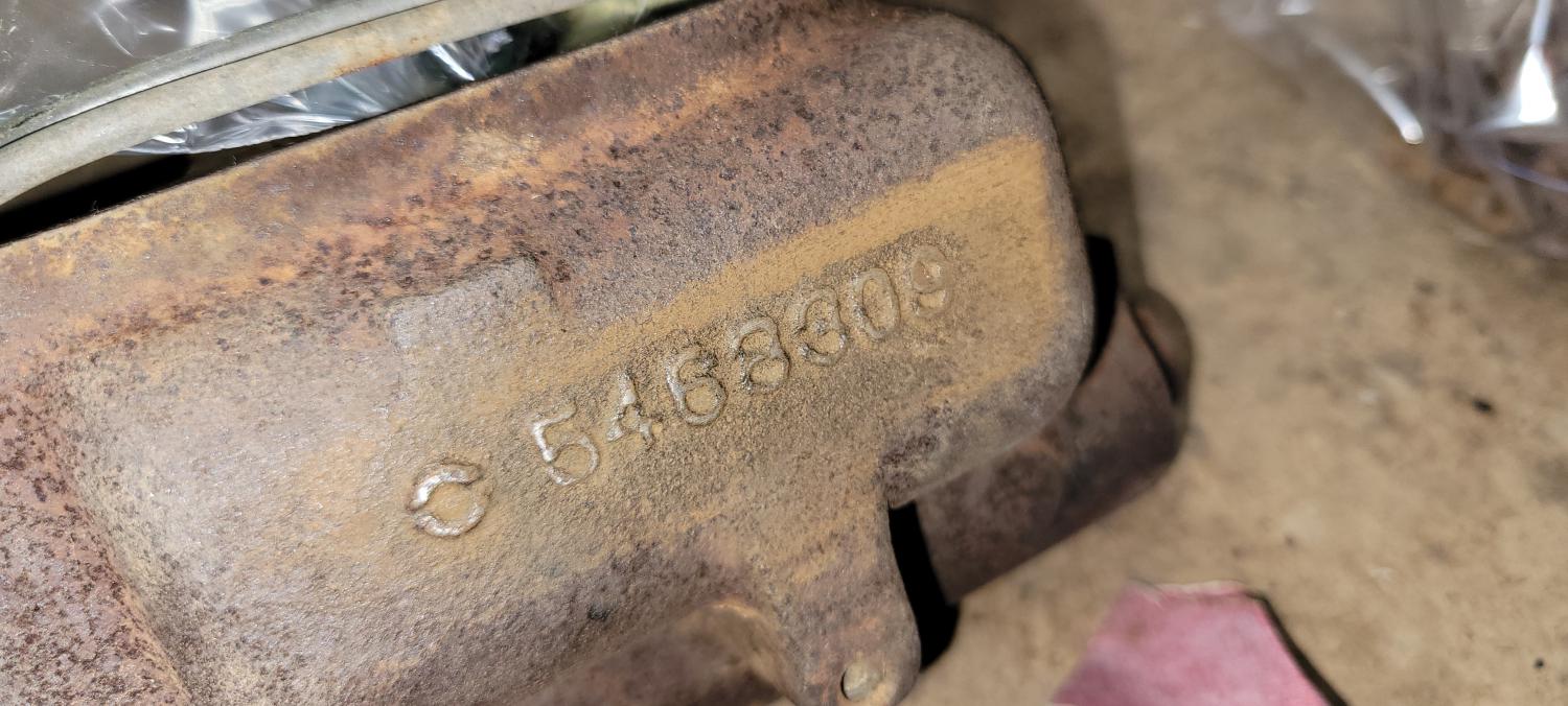

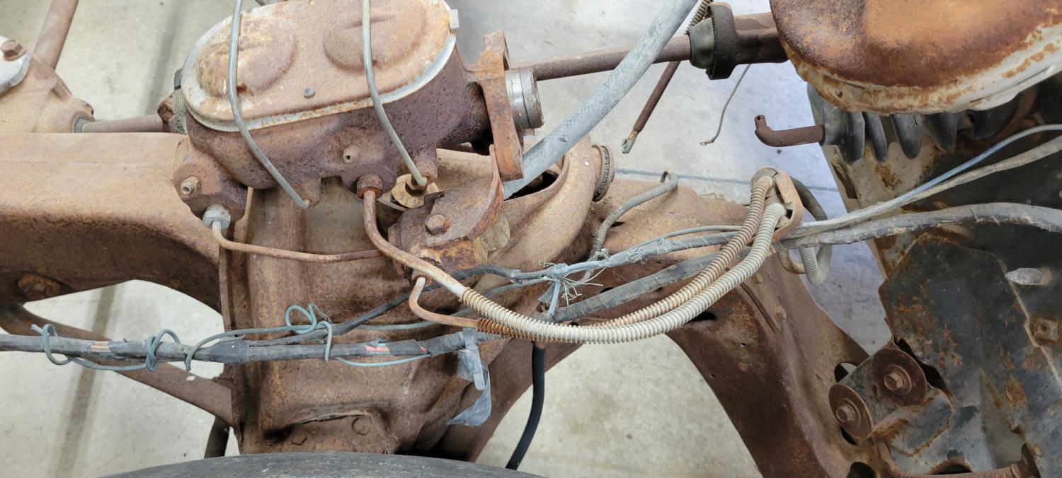

Default Brake Fitting Colors
Time to get into some details. Ive seen many restored cars with colored brake line fittings. Ive never been able to actually see the colors on the original parts as I took them apart till now. All lines appear very rust free and original. Brake booster is dated late 68 which matches the car and the master cylinder is cast 341 i assume of 68 to match the car

Both fittings at the master cylinder are colored Blue, while the remainder of the fittings appear plated in zinc/gold. The other fitting that is colored in purple is the rear line down at the frames distribution block.

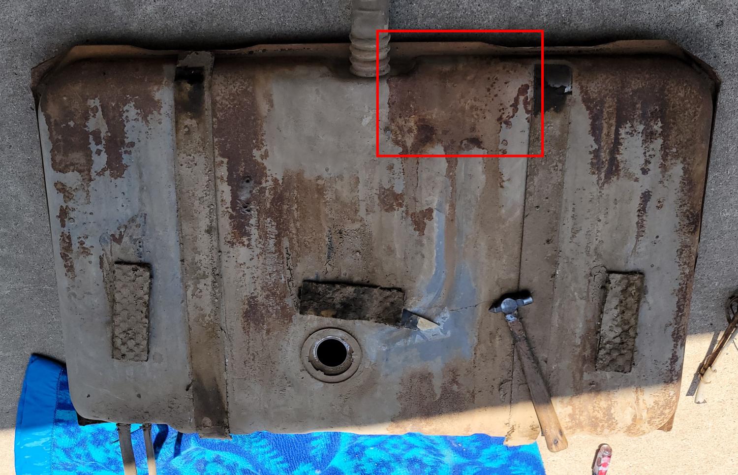

Default Gas Tank Sequence Number
A little bit tough to see the number on the tank but it was still there in black marker. I had noticed the number and location on Ricks Yenko. If there is one thing that everyone can take away from my restoration its the picture of the gas tank. Nothing irritates me more than to see a restored car and the fact that someone put the isolation felt on the underside of the tank between the strap and tank. As you can clearly see in the pic the straps go between the tank and bottom of the trunk.
