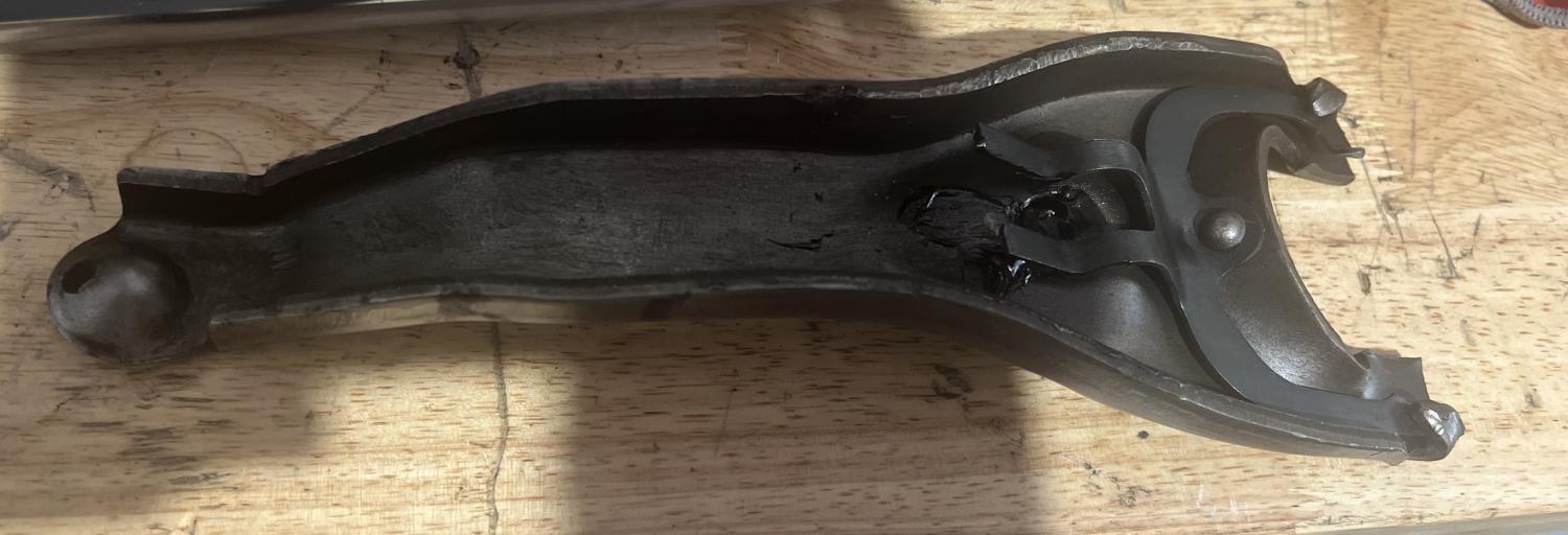

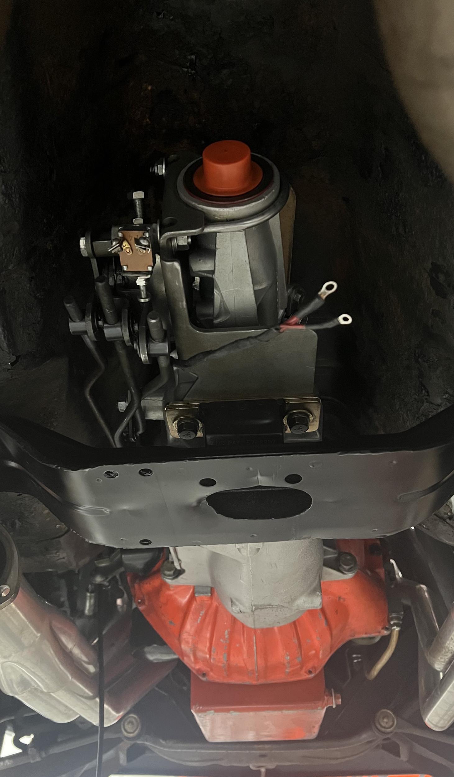

Progress! My crossmember was looking pretty rough, so I wire wheeled it, and shot it with some primer and paint to clean it up. I was able to get the flywheel resurfaced and balanced with the pressure plate. I started putting it back together, but one of the tabs on the clutch fork was broken and I thought I was done for the day at that point, but since I'm only 20 minutes from Auto Metal Direct I was able to source a new one and get the transmission back in. They had a sweet 69 Camaro SS350 automatic in the lobby, so it was a good excuse to go!
Still have to get the reverse lights hooked up, shifter handle/console plate reinstalled, driveshaft in, exhaust reconnected, and plug the distributor back in and re-time the engine, but I'm getting close now!

Your throwout bearing is sitting on the fork wrong.
That it is. Nothing like a piece of humble pie in the morning. Better to know that now that after the car is running. Thanks for pointing it out.
And that starter bolt... can't believe that doesn't let the starter move and slip on the flywheel teeth.
