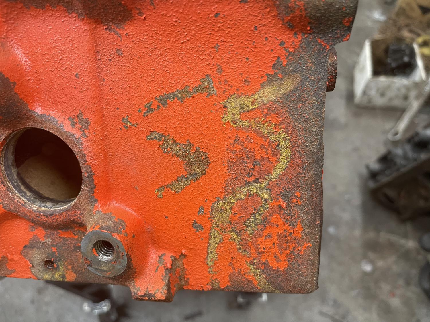

I thought I would share some photos of my 69Z I’m rebuilding my born with drive train and after cleaning up the block ,suspension, I found some interesting factory markings. As more parts are cleaned I’ll post more photos.
69Z X77 03D Lamans Blue

I can make out the DZ which is quite typical to see scrawled on the side of the block...
FWIW one of the corvette parts houses has freeze plugs without anything stamped in the centers (like originals) same with the correct intake manifold gaskets with the "tab".

You can see how thin the original engine paint was(the bright orange is a later addition) it really doesn't fill the grain of the casting - IT allows the heat to dissipate without blistering the paint.
I love the dripping yellow down the side of the pitman arm - I use an eyedropper to replicate runs like that.
Beautiful--
I responded to your pvt msg - you may see this first Corvette Central is where I last purchased my no mark freeze plugs. Another person told me that they picked some up on ebay - but they came out of Great Britain.
