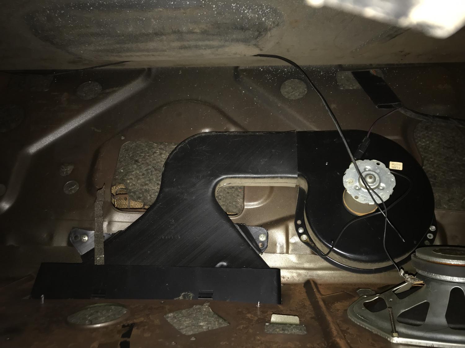

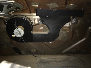

Here is the pic of the original system in the 1969 I was referring to...

Sorry, Flipped the pic before it was uploaded...

Trying Again...Note the Speaker shown here is added on later...
