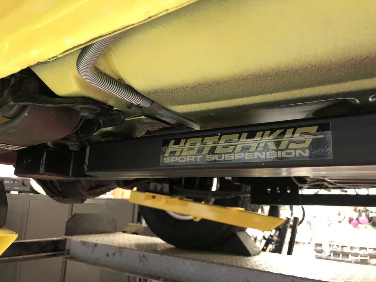

Adding to the restoration pics and the storyline of the undersides, I had Ron apply some overspray and satin black paint to the primer sealed underbody. While much of the rear section and tunnel area is prominently sealed in grey primer, the lower floorboards were painted black with the heaviest emphasis being up near the toeboards before painting the satin black firewall.
He then painted the lower rockers and rear wheel openings in yellow without being overly protective of getting any overspray onto the floor edges or the areas beyond the targeted pattern in an attempt to mimic what the factory did. Yellow overspray can now be seen where typically found on the factory painted cars including some overspray of the black sound deadener applied to the wheel well areas. I'm fairly happy with the end results and didn't want to over restore the car or get too carried away with overspray.
Yellow overspray seen on the lower floors here. The label still needs to be removed from the added subframe connectors and they need some welding at the rears.
Restored original 12 bolt rear with Cal Custom Cover and vintage Lakewood Trac Bars (Decal was a fun touch to be added)
Here you can see the yellow overspray in the tunnel area from the outer frame rails being sprayed.
The same overspray patterns are found on both sides of the rear tunnel.
Lots of overspray under the tank mounting areas and on the leading edges of the lower trunk pan. Fuel lines were added after the fact.
Here you can see yellow overspray and some sound deadener residue over the black on the rear of the floor pans. (non-deliberate effect)

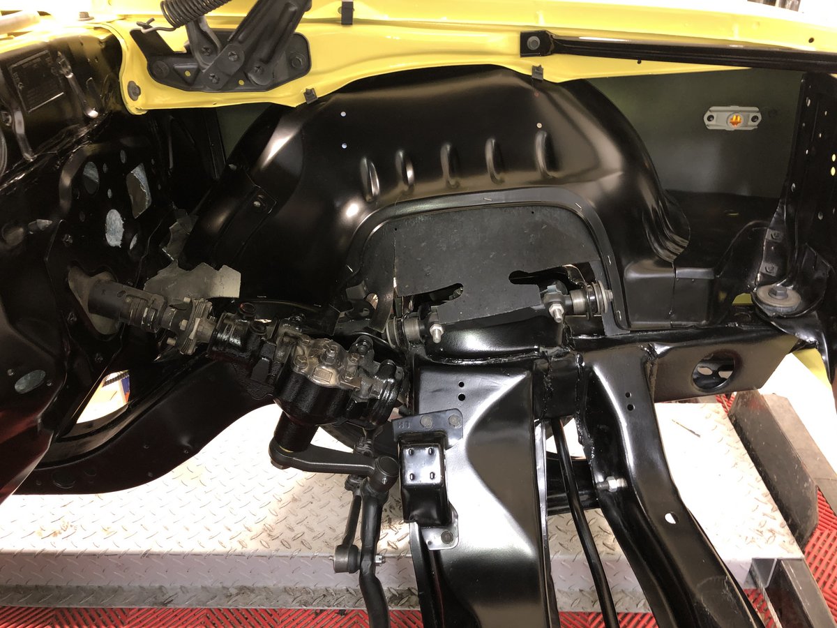

I was out hanging some emblems and badging on the car last night and thought I'd better get some engine bay shots now that it's home and everything has been cleaned up. Aside from my powder coater getting the wrong color on the fender support bars (gloss black rather than satin) I would say it's looking pretty good under the hood. Once the wiring and front lighting is completed, I'll plumb the brake lines, add the pedal carrier, the tilt column, and the restored booster with the master cylinder.
