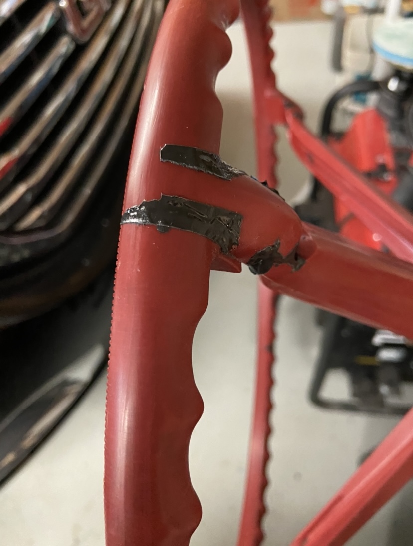

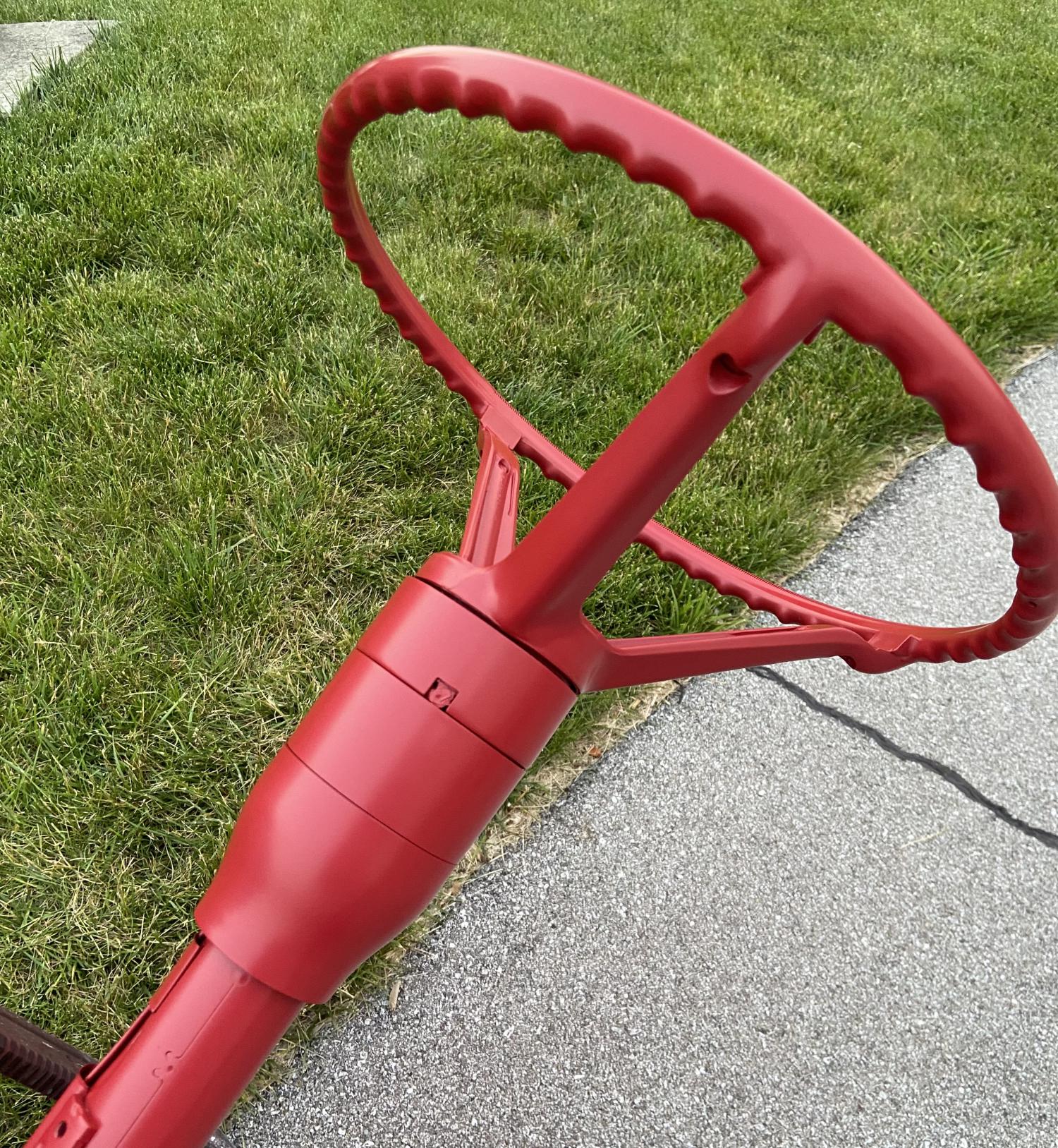

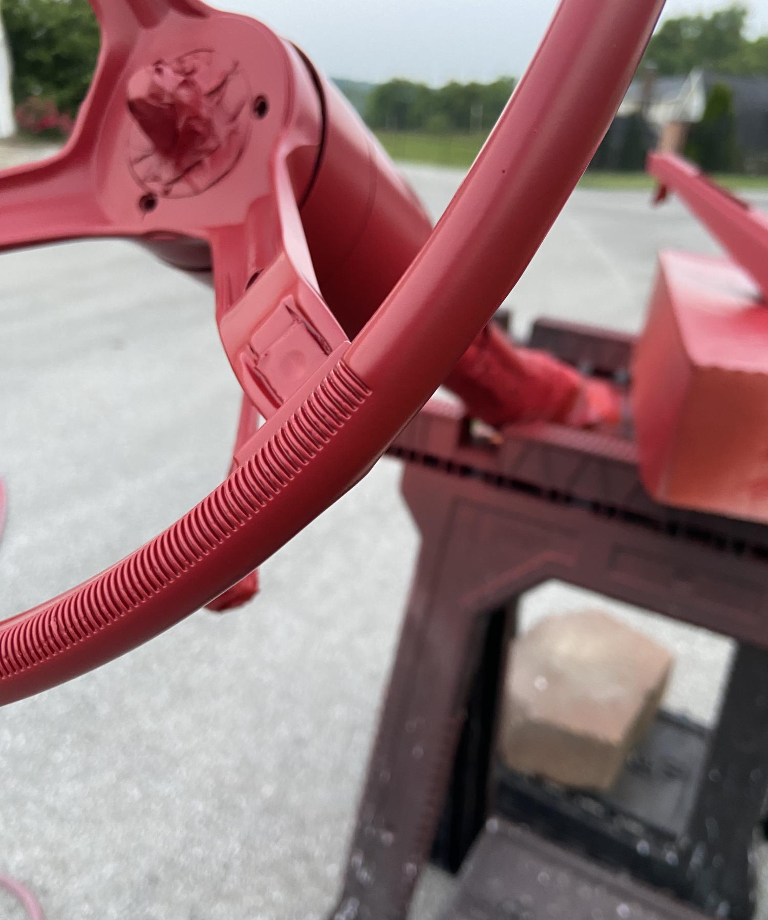

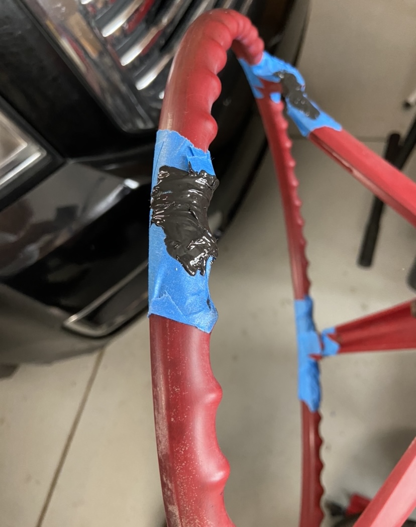

I haven’t done much on the car this past week but did rough out the steering wheel crack filling. The MarineTek epoxy worked great. Flowed into the cracks nicely after I routed them out a little bit, but full bodied enough to stay in place. And shaped easily with a file and then sandpaper.

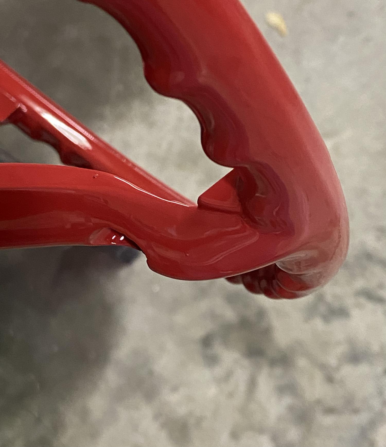

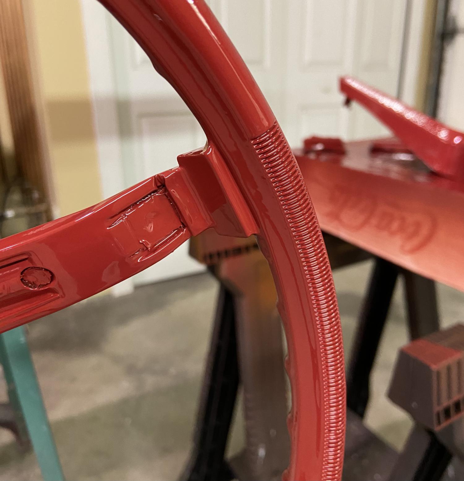

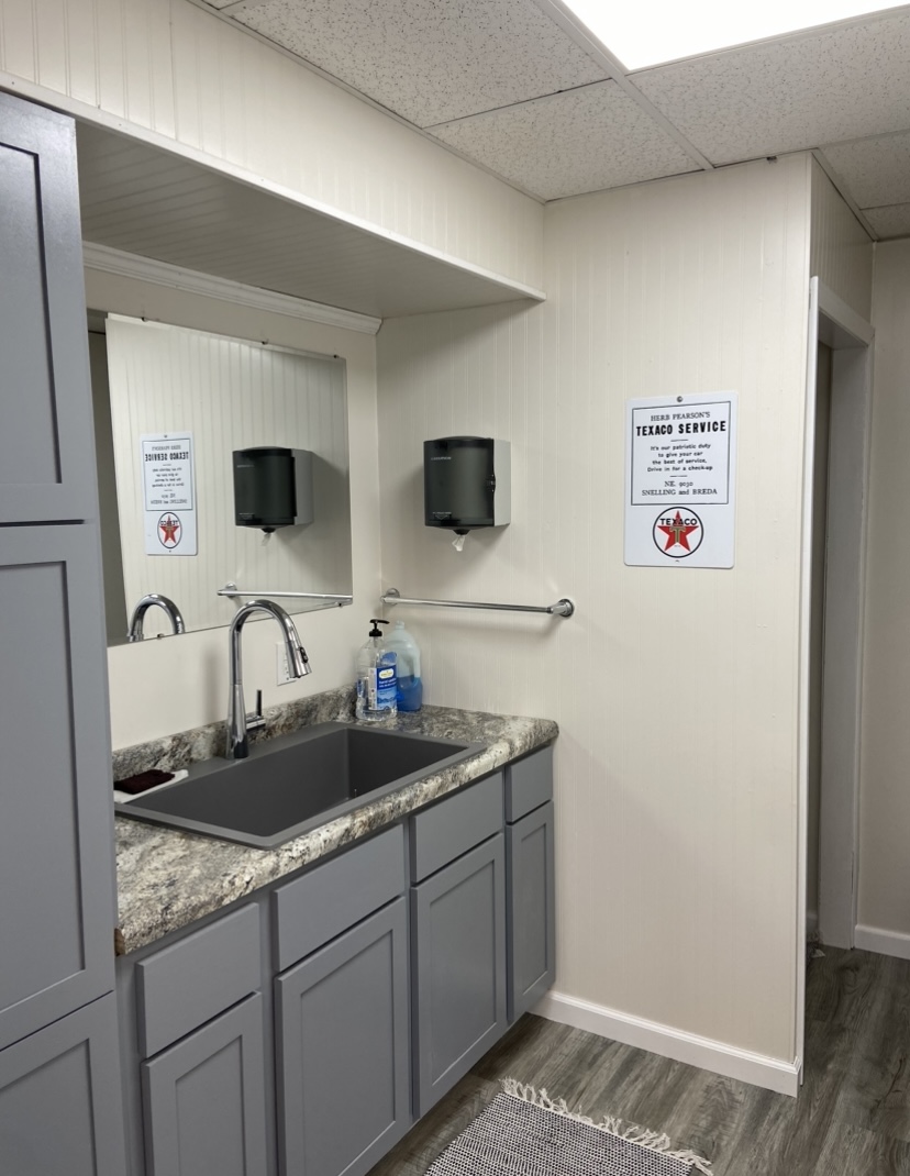

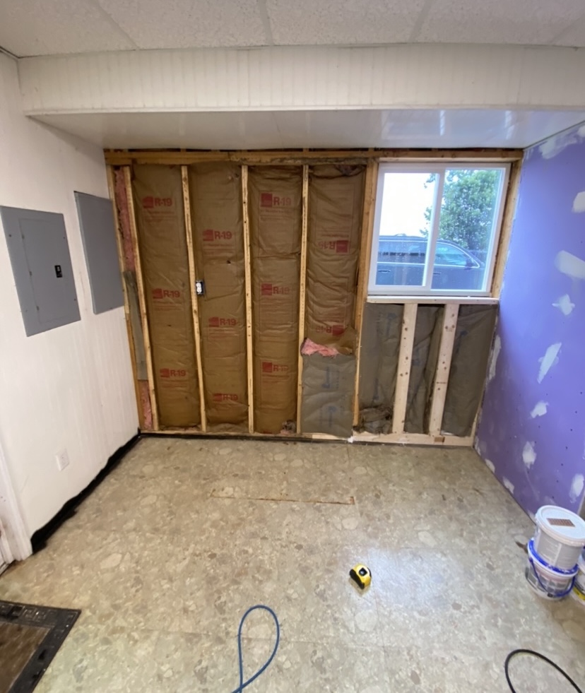

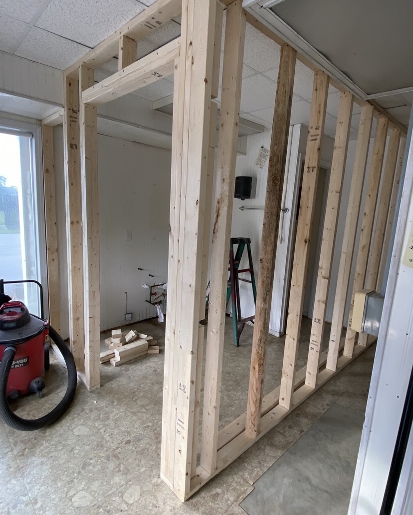

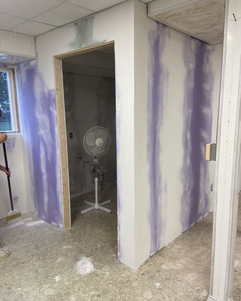

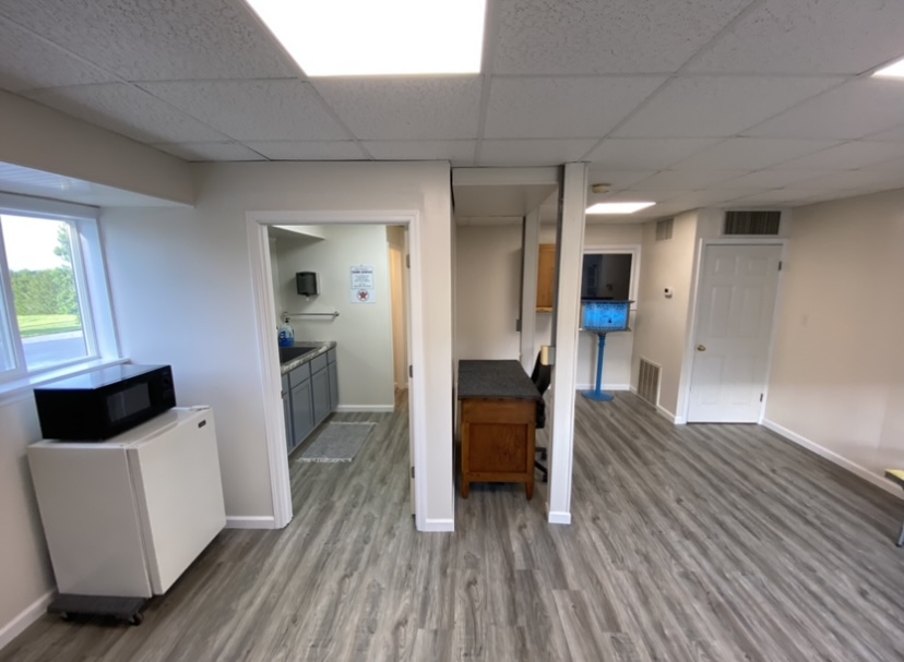

Its been awhile since last update. Mostly because I haven't worked on the car much. After a June post, Mrs SMS gave me a budget to remodel the office in my shop. Room within a room kind of set up so I can keep the water on during the winter without having to heat the whole building. Plus better windows, flooring, lighting etc. The service station sign is a reprint of a 1940's newspaper ad my Grandfather ran in St Paul, Mn for his service station.
Got started on that around Father's day with demo. Then went in to the hospital for awhile. Resumed the remodel in mid July and got it mostly knocked out to where I could resume multi-tasking.

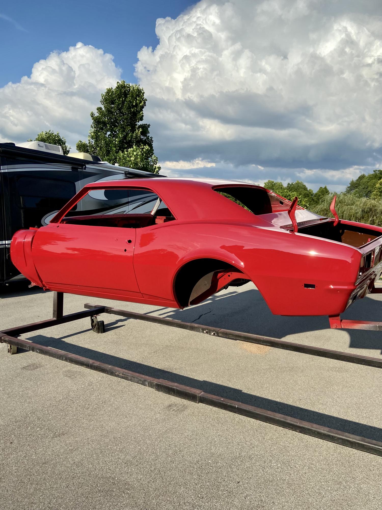

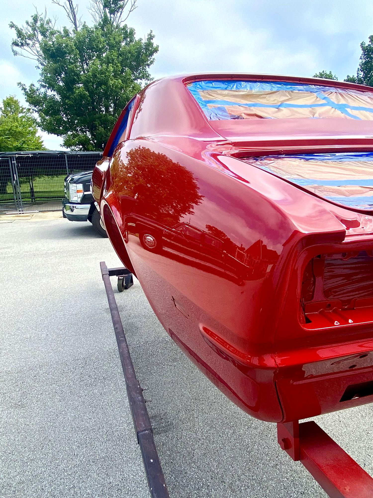

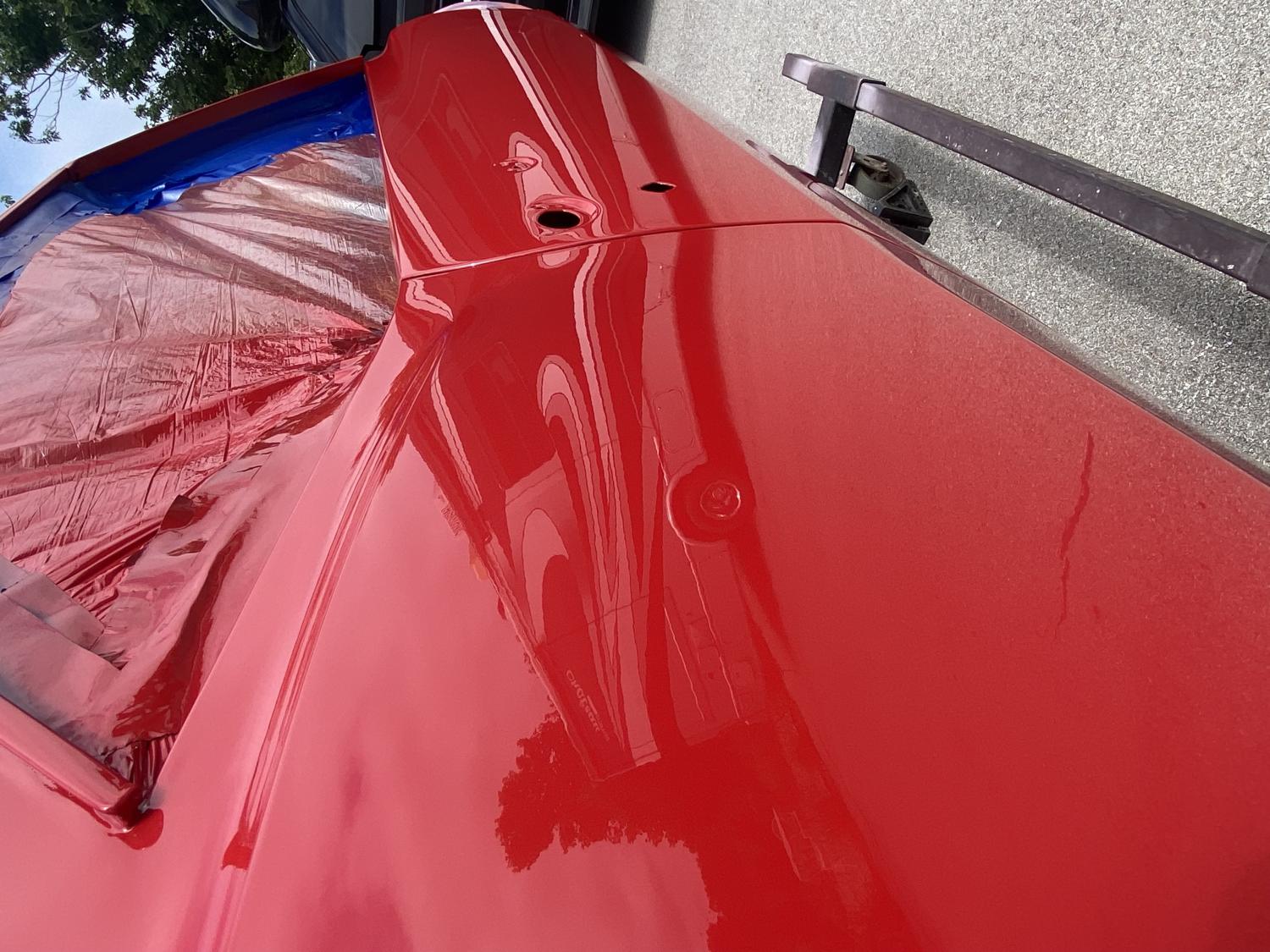

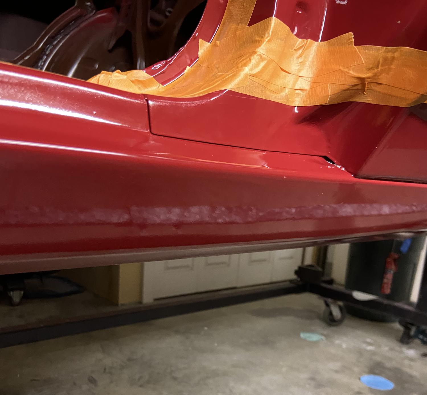

The car had been sitting there half blocked for flow coat. Finished that up and hit it with 3 more coats of clear two days ago. Its not quite as flat as I wanted, but the cut and buff protocol will be deployed next. Also I have the Matte Black single stage for the Rally Sport rocker black out treatment I'll probably do while its still on the rotisserie.
Pics of both projects now.

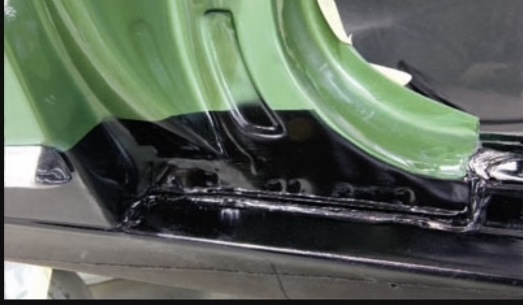

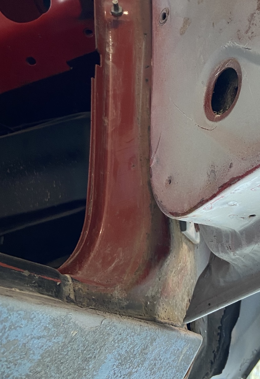

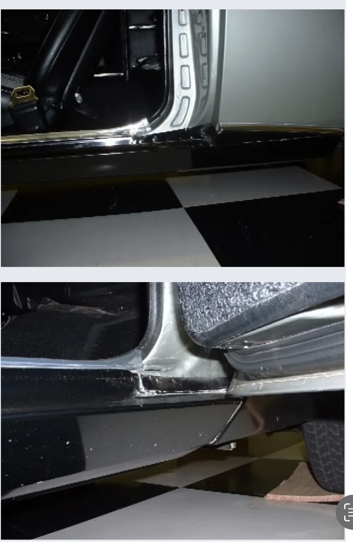

I amused myself this week, after spending months looking at original paint 68 RS cars and the masking profile of the door jamb blackout. Since the factory was all over the place with layout and consistency I finally decided how I would average the tape line and use the examples closest to my May Norwood car.
Started masking to shoot black this weekend. I was flipping thru my old pics yesterday and had my ah-ha moment. Long ago I took pics of my original jamb lines and the detail survived two paint jobs in history because they never painted the jambs when it had two color changes in the 1970s. (Flat black then white)
Glad I realized I had this info before I got the paint gun out!! Now I know exactly how my car was done at Fisher Body.

Blackout done. This is SPI Matte Black single stage paint. Mixed 4:1. The mix ratio controls the level of flatness. From 4:1 to 8:1 which is totally flat zero gloss. This should dry to a nice semi gloss eggshell.
