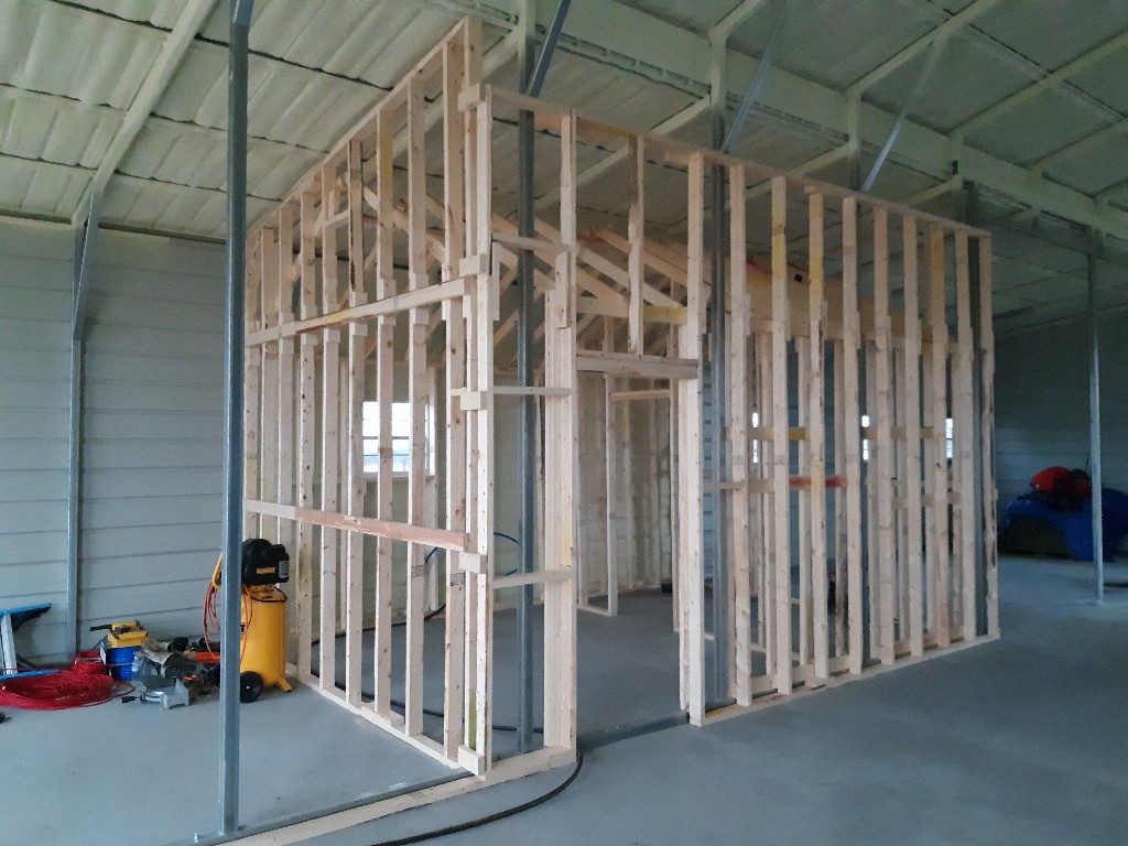

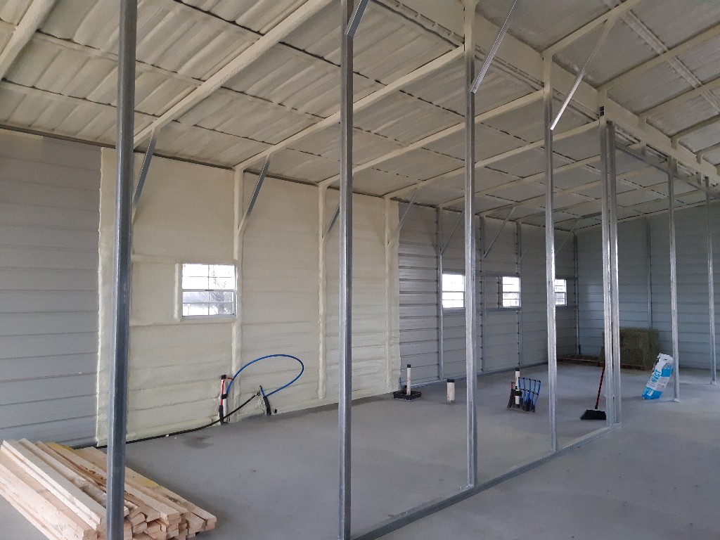

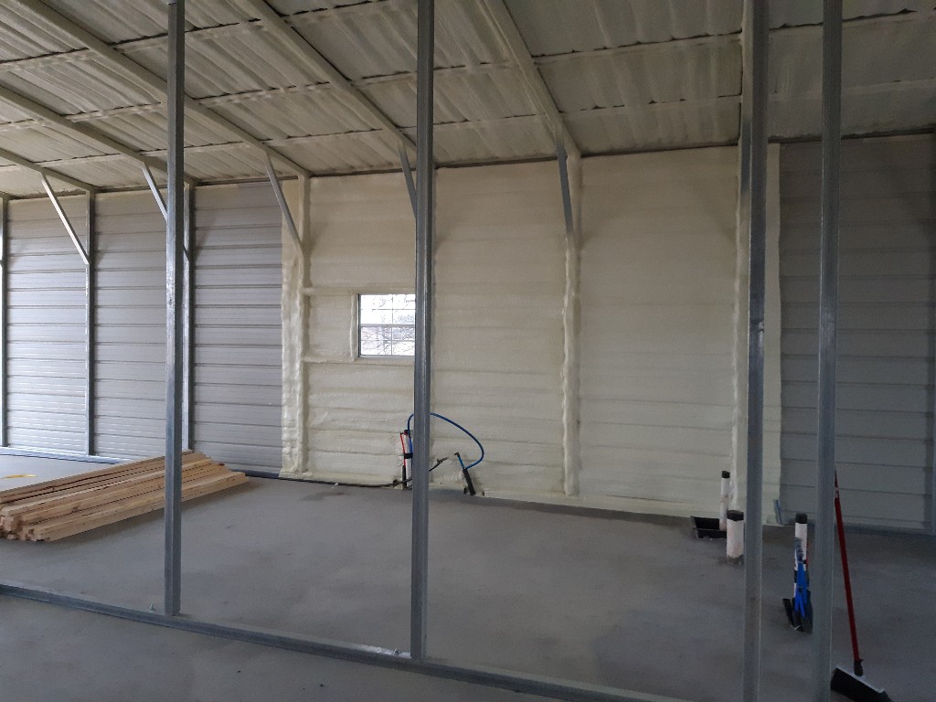

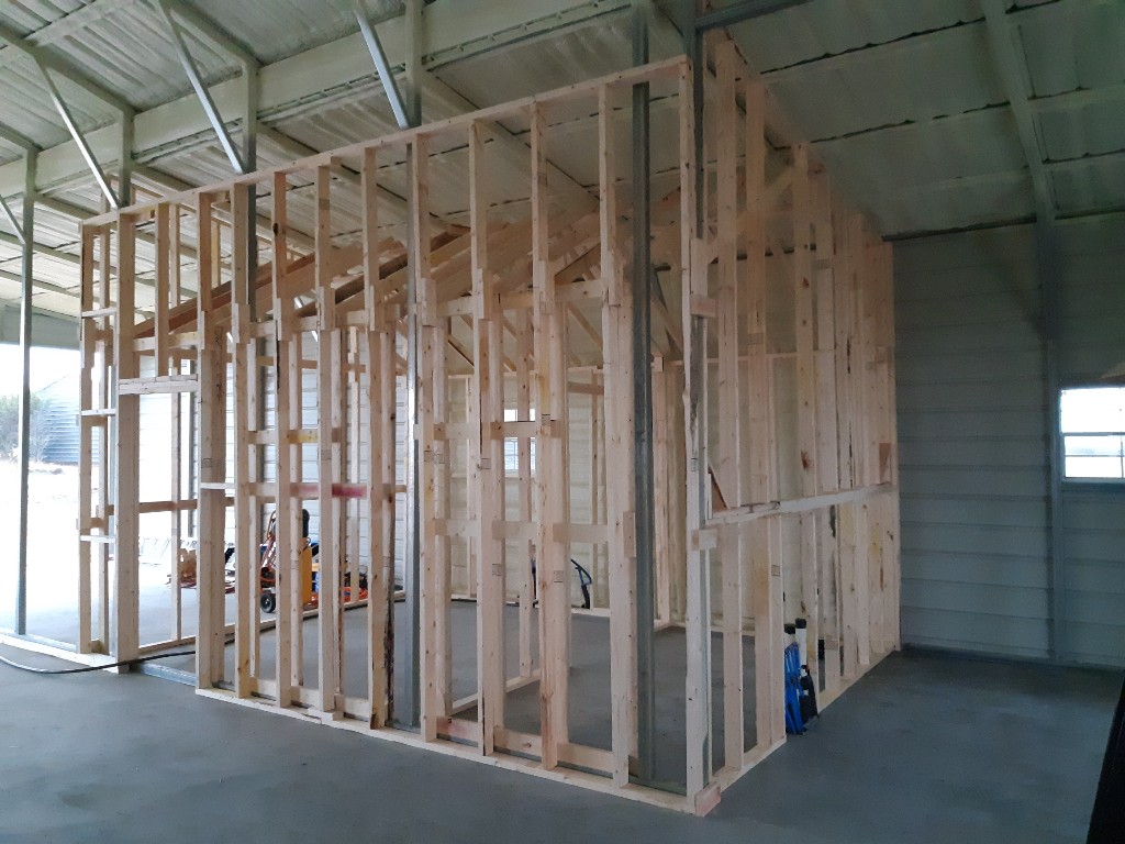

With rain moving in, not a good day to pound the remainder of the fence posts in. So what's someone like myself do when it rains? Watch a few movies? Play Candy Crush? Write fake scathing reviews for things I've never used on Google? Nah, although that fake review thing does sound fun! Nope... you move inside the barn and frame out the wife's tack room! The first shots show the sprayed insulation installed on the wall where the room goes. I had both of my entire shops done (walls and ceiling) and just the ceiling and the tack room wall done in the barn. To the left of that room will be horse trailer storage, and located across the main aisle from that will be tractor storage. The whole interior will be trimmed with tongue and groove clear pine stained cedar color with any exposed metal poles wrapped in cedar. Think Budweiser's Clydesdales hangout!! Well.... in my mind that's what it's going to look like. Realistically, I'm just going to put in a few beer taps. Man, speaking of that, go out and try Bud's new beer aged in Jack Daniel's whiskey barrels. OH...EMMM...GEE..... it's freaking good (and I don't like Budweiser) Anywho, where was I?

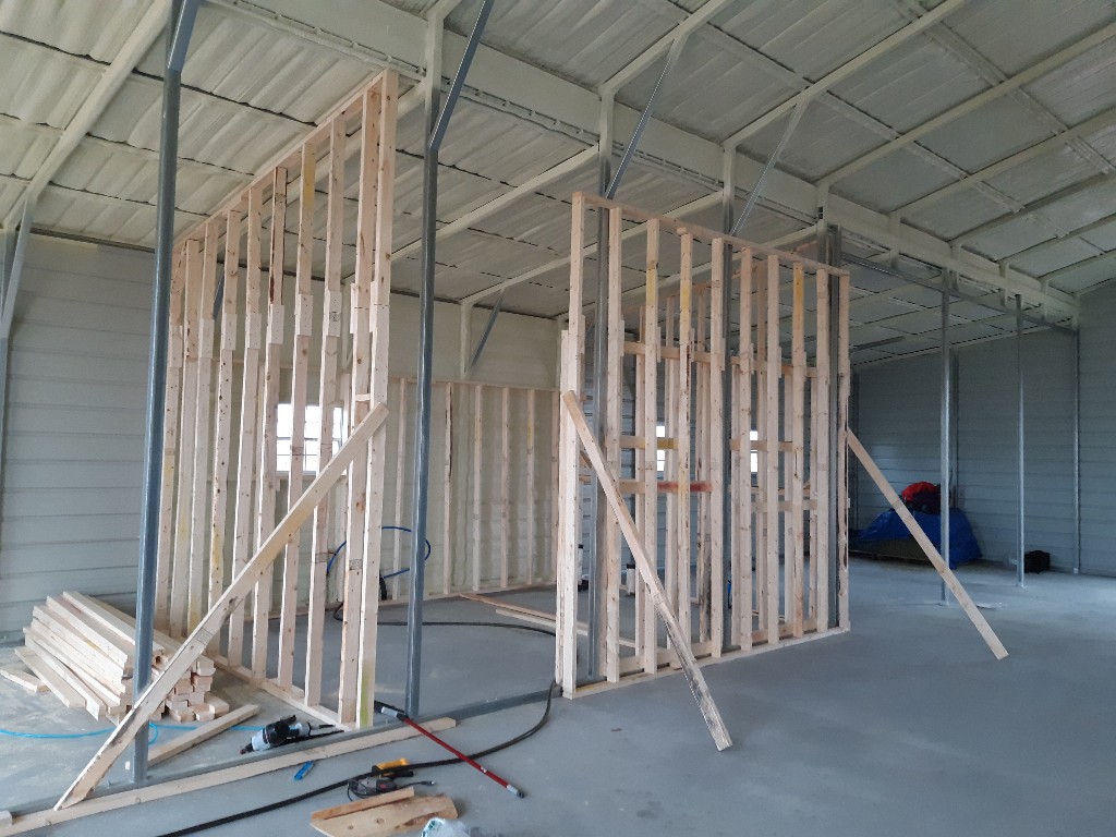

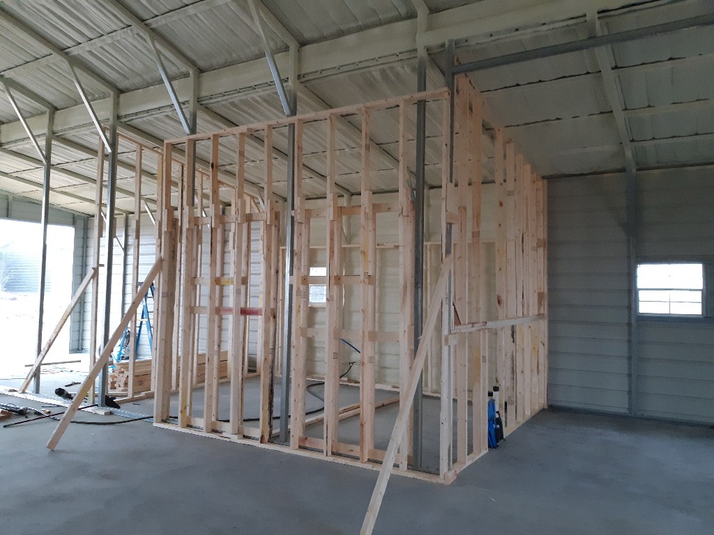

These are the outer walls and the ends are 14ft high. Pretty scary pushing that wall up there by myself, but where there's a will there's an idiot refusing to ask for help! I got this all done yesterday and today I'll finish by adding the divider wall and vaulted ceiling. A vaulted ceiling you say, huh? Why, yes! I mean, why not? The ceiling will be 8" wide tongue and groove clear pine trimmed with a large center cedar beam and two beams spanned across. I'm going for the "Tack Room of the Year" award from Tack Room Monthly digest!

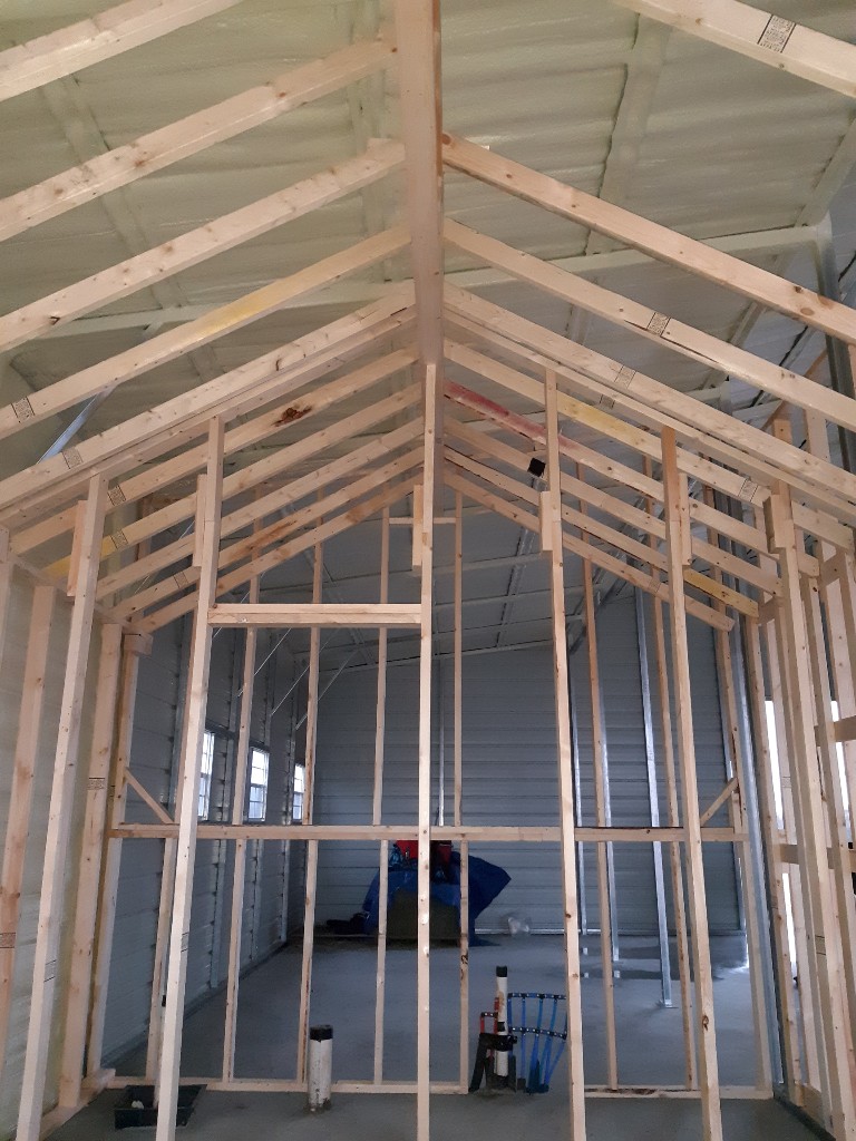

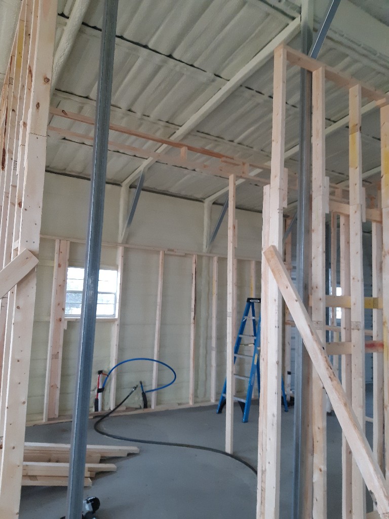

Thanks men! Yes, lots going on here. Before I left on this trip I did finish out the tack room. You'll notice the vaulted ceiling in there and it's sort of a structure insidea structure. Either outer side of the tack room is a solid wall floor to ceiling. The back wall will be a stable, and the front wall is the backside of the trailer storage area. Both will be insulated where it meets the room's outline and then sheeted with plywood. The back where the stall will be will also has 2x6 boards for added protection against that errant horse kick. So next week the plumber and electrician are coming out so I can move this along and then finish out the interior.
Yes, there is a missing rafter up there, which is intended so I can roll out insulation on the roof once that half gets the ceiling installed. I can get access to the front though the open wall. The whole exterior of the tack room, tractor and trailer storage areas, as well as the ceiling will be tongue and groove pine with cedar trim. I should have that done by Tuesday!

Thanked 493 Times in 228 Posts
If your bottom plate isn't a green plate(doesn't appear to be) I would recommend squirting some bug juice under there to keep carpenter ants and termites at bay.

Yes, good point! I'll be doing that for sure. The whole thing will be sealed around the walls, floor to ceiling, to prevent anything from flying in and making a nest as well. The exterior wall of the barn adjacent to the interior wall of the tack room will be sealed too.
