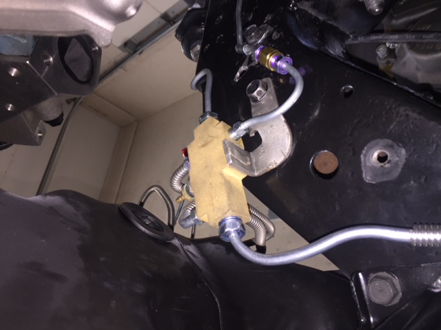

The motor has been installed. The owner wanted aluminum heads. Little did he know the edelbrock heads must be a little wider because both headers needed modifications to fit. First problem was on the driver side. The header was hitting the brake line distribution block. I had to move it back and up to get it away from the heat of the header. Next was the Zbar it’s going to be real close won’t know until I get the pedals back into the car and engage the clutch. The passenger side header had to be dimpled where the lower control arm bolt head is. These Doug headers are a tight fit this for sure!

Are those headers designed for the Edelbrock heads? Those heads have their own unique port layouts from what I recall.

Yes these are the correct Doug’s headers for these heads. Some special D port head I guess. All I know is everything is tight.
