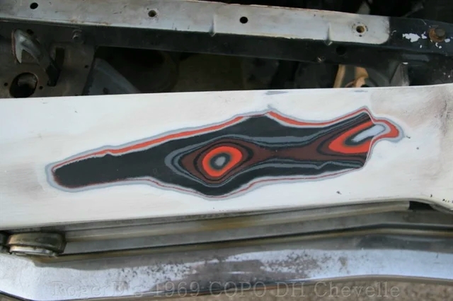

There were NO SS emblems outside (except the wheel caps) or inside the car & no decals on the engine or air cleaner.
Black stripes on the hood, hood locks, large crossed flags on the front fenders, black tail panel as depicted in the photo shopped picture and a single "Dick Harrell" emblem on the deck lid . . .
  #80
Old 08-22-2009, 06:11 AM
RogerD's Avatar
RogerD RogerD is offline
Join Date: Apr 2009
Location: North Texas
Posts: 289
Thanks: 257
Thanked 88 Times in 25 Posts
Default Re: RogerD's 1969 Dick Harrell Chevelle
More documents to Val today . . .
There were no SS emblems in the center of the rear panel - no, nada, nothing . . .
One of the previous owners stuck an SS emblem on the grill in front and also an SS 396 emblem in the center of the rear panel - they are now gone ...

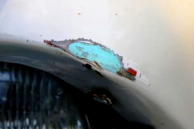

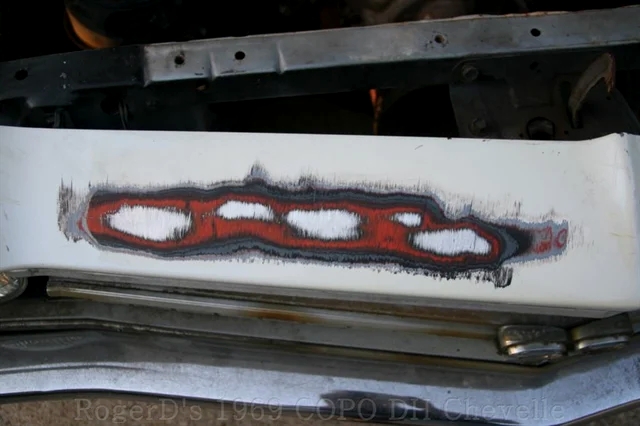

I've related an incident to certain DHPC folks that occurred during the first 12K miles - while the car was at Bill Allen Chevrolet for warranty work, they banged up the hood, top and rear deck lid (without telling me). They repaired them, repainted with a coat of primer + a coat of orange + black hood stripes (without telling me). I noticed the stripes on the hood were flat black when I picked it up but it didn't register - just thought they gave it a good wash and took all of the wax (I waxed it almost every weekend) off and now it was fresh. About two weeks later, I noticed the black stripes were cracking and the orange on the hood, top and deck lid was doing the same. Took it back, asked the service writer about it - he says "we didn't do that" - I escalated to the shop manager and he says "we had an accident - the hood was laying on the top and slid off - had to repaint it, the top and deck lid"! I was furious but to no avail - they offered to clean it off, furnish me a 'free' rent car and repaint it - I had no choice but to accept.
Tonight, I sanded through the cross piece in front of the hood and bingo - multiple layers of paint . . .
More confirmation, like the barrel I clipped in Nov 69 and put a flat spot on the LF fender . . .
