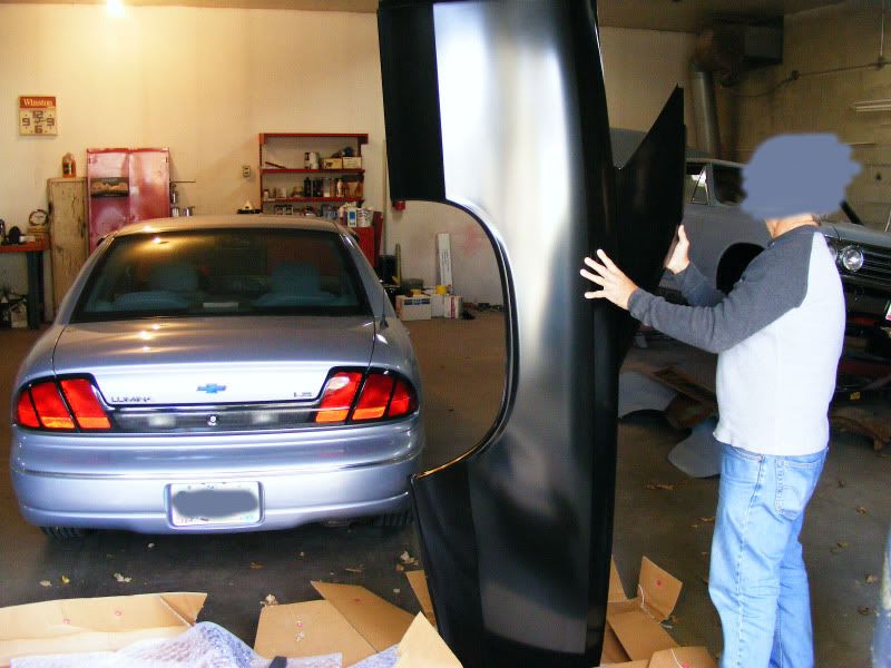

The new quarters arrived today. We loaded them up and dropped them off at the body shop. For once during this debacle, I can honestly say I'm <span style="font-weight: bold">very</span> happy with the quality of the panels upon initial inspection. Nary a dent nor blemish was found, and all the lines were very clean and crisp.
If the quarters fit as good as they look, they will definitely be one of the high points on this project.
(One of the two body shop gurus inspecting a quarter)

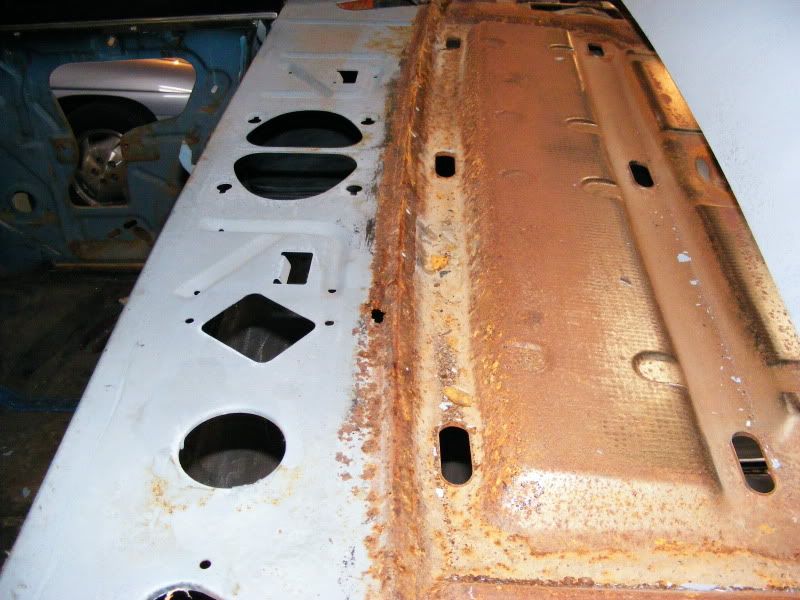

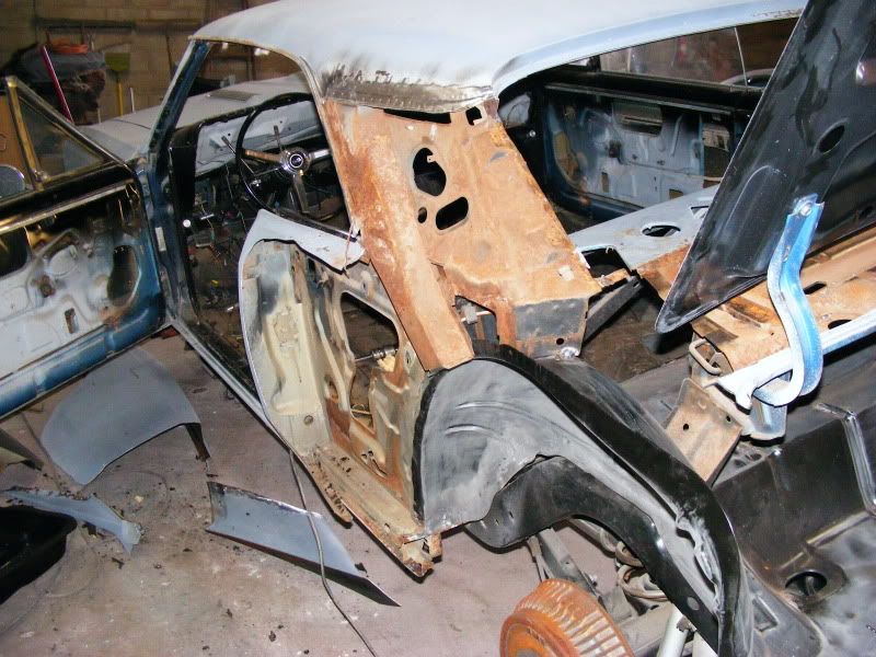

Most of the remnants of the old quarters have been removed; the only remaining sections were the door striker panels as we weren't sure where they needed to be trimmed until the new quarters were on hand. There is a reinforcement plate which will need to be retained from the original quarters.
More &quot;rust free&quot;....er.... &quot;free rust&quot;

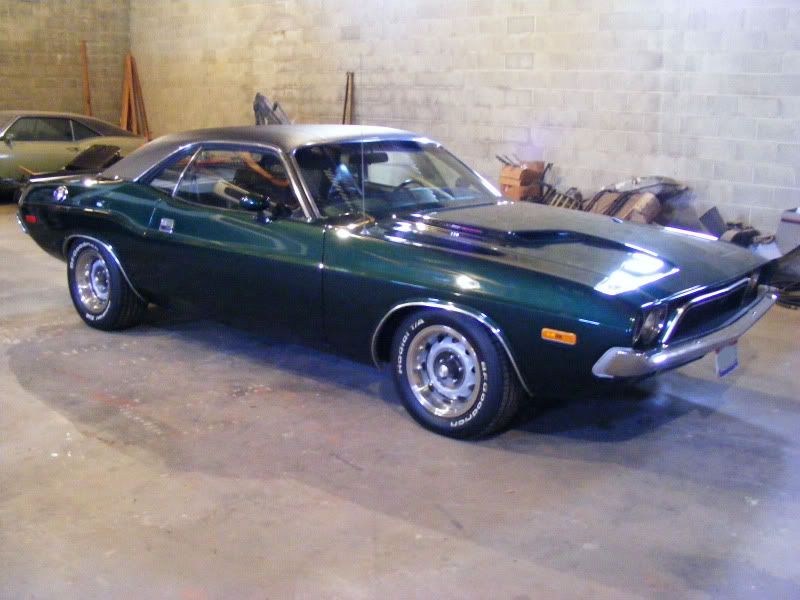

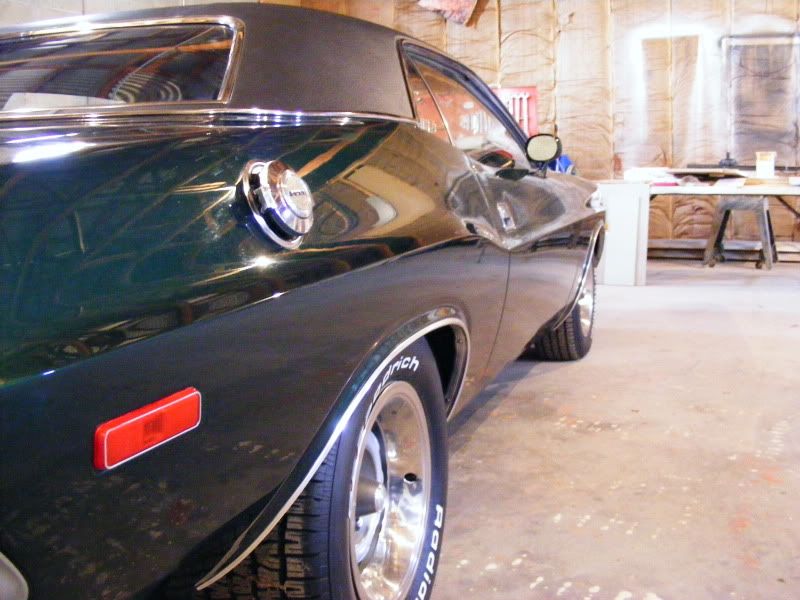

Just for the sake of a peek; the `73 Challenger below belongs to the body guy above who is inspecting the quarter. It runs the factory 360 with a 4-speed and an 8 3/4&quot; rear end. It's been restored from the ground up, and my barely marginal photography skills do this car absolutely no justice. This thing's sweet.

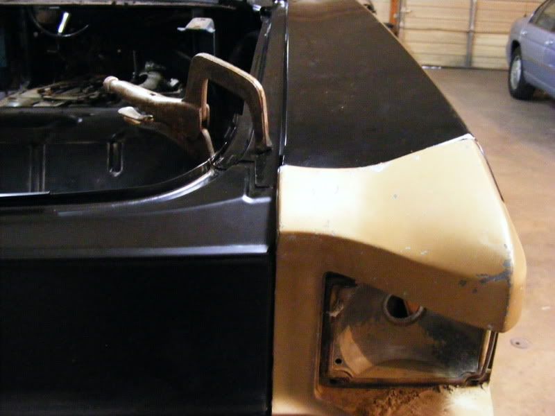

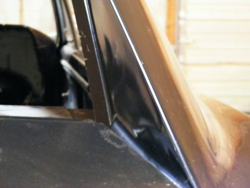

The passenger quarter being trial fitted; there are a couple of issues the body guy pointed out that will need to be addressed.
There are some ripples on the window side of the C pillar that weren't spotted on initial inspection.

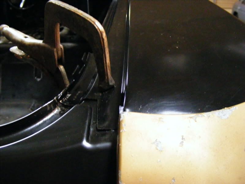

Body guy says he can hammer and dolly this out, not that big of a deal. Issue #2 isn't going to be as easy to address, but body guy assures me he can handle it. There was also an issue with how the quarter panel trunk gutter rail was lining up with the gutter on the rear body panel, but a small relief cut alleviated the issue.
Note where the quarter extension meets with the trunk edge of the quarter; the trunk edge starts out nicely from the C pillar, but once it gets to the quarter extension, it is rolled out towards the outside of the quarter panel which leaves about a 1/16&quot; to 1/8&quot; gap.

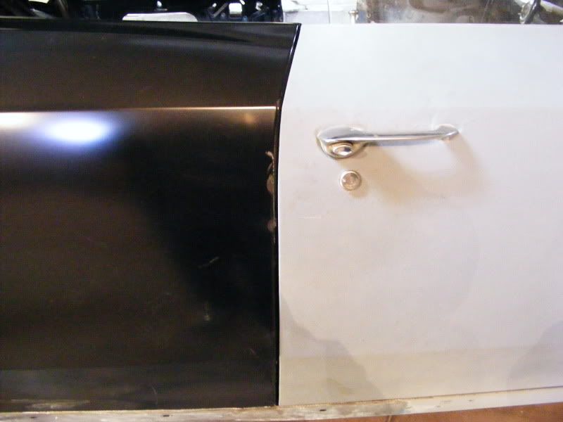

The panels line up nicely in the door jambs.
There are also some fitment issues with the rear deck filler panel, but until the drivers side quarter is trial fitted, we won't know exactly what is causing the issue. Again, the body guy says it's nothing he hasn't battled before.

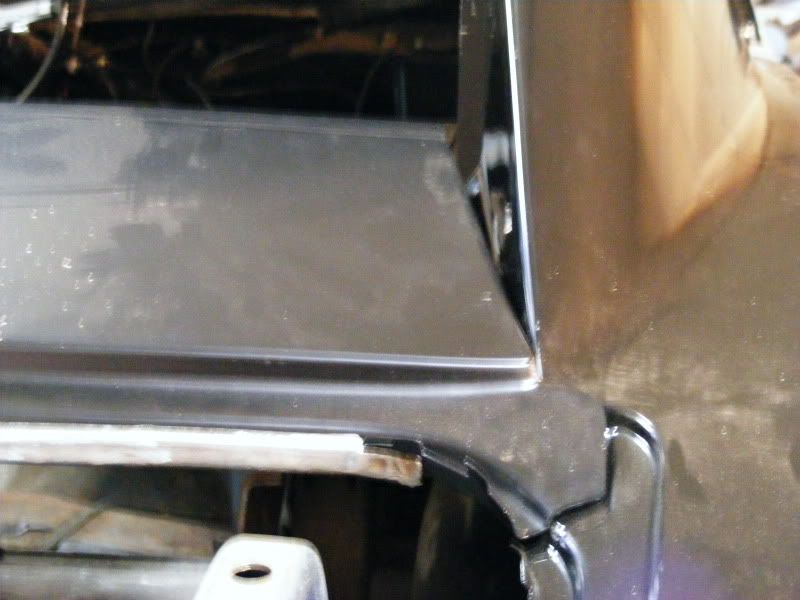

This is all the further it will go into place w/o somewhat excessive &quot;coercion&quot;.

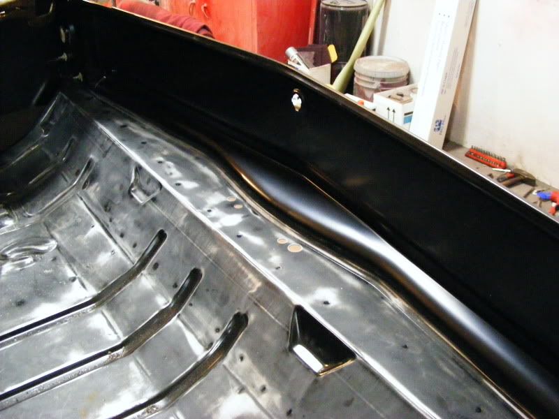

There were some issues with the fit between the rear body panel and the trunk floor, but after bringing up the center of the trunk floor, the panel appears to line up fairly well.
So here's the informal assessment from the body guy so far:
<span style="font-weight: bold"><span style="text-decoration: underline">-Trunk floor:</span></span> So-so. There are apparently two different trunk floors being made for these cars, and naturally I inadvertently wound up with the lesser-quality of the two. Tip for anyone looking at buying one of these trunk floors--look for the one that has the spare tire hold-down bracket and jack mast brackets welded in place already.
