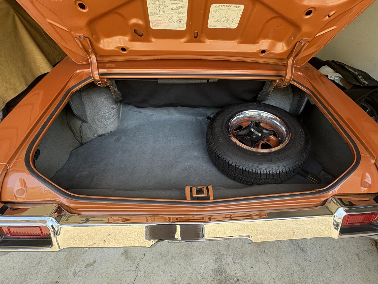

Pulled the back seats and looked under the carpet. No broadcast sheet found. Did some more vacuuming and cleaned the trunk. It looks just as solid as the rest of the sheet metal other than having been resprayed with the wrong trunk paint. The dark patches are pieces of the rubber mat's backing that were stuck to the floor.

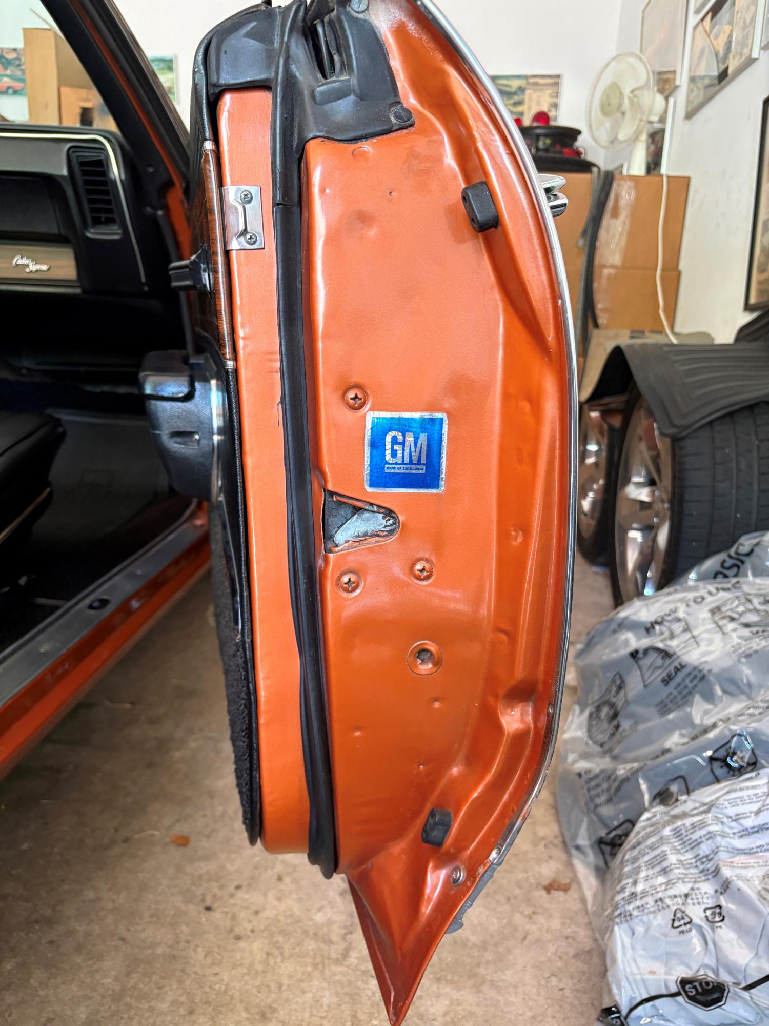

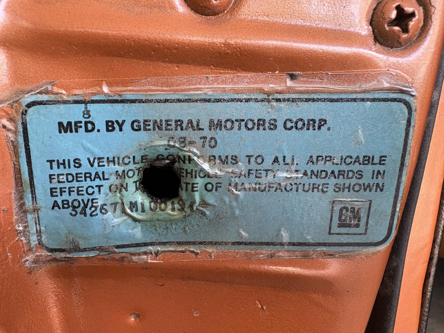

Is this normal? Looks like they applied the factory door jam VIN sticker over a plastic body plug. I was able to gently pull the plug out and verify the VIN but that's crazy. The other side has a similar plug that has paint over it, I assume from the 1995 repaint.

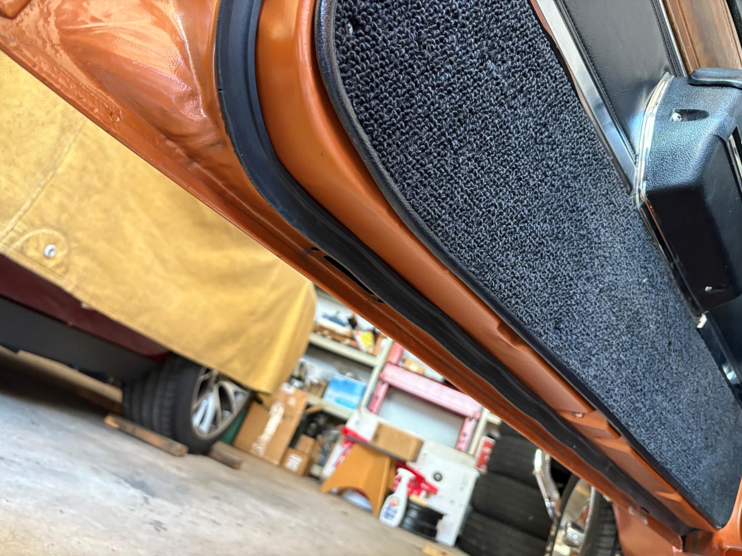

BTW, the undersides of the doors are beautiful. No door-skin seam swelling anywhere.

No, that's like a Ziebart plug for rustproofing, but likely another brand. Never seen that before being placed right into the VIN decal.

Yeah, I thought so. Absolutely insane choice of location to drill a hole. Now come to think of it, my black 1972 Formula Firebird from Canada has a hole drilled in the same exact spot (in both doors): right through the VIN label. Must be a pattern of insanity occurring above a certain latitude line.

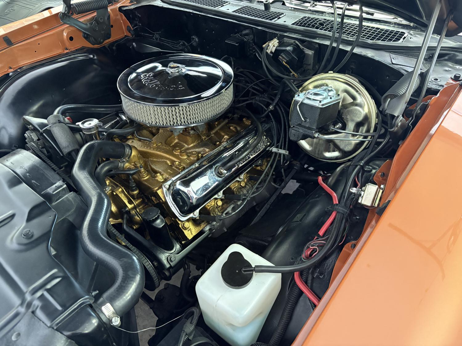

More mission creep. :-)

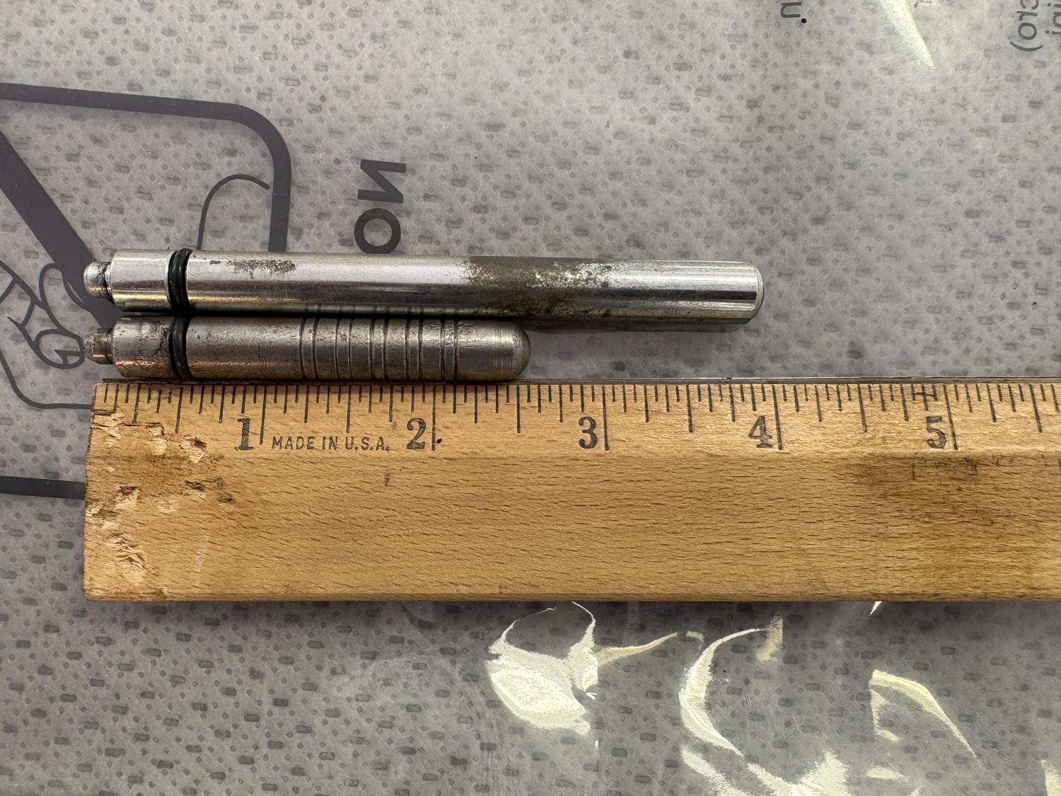

Replaced the generic master cylinder with something more correct and not seeping from the rear seal. Had to dig through my parts to find the correct push rod that comes out the front of the booster since the one in there was waaaay too long for the stock style master cylinder. (2-9/16" versus 4")
