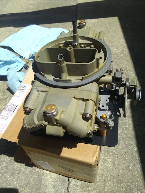

Update: Engine Done. studded 2 bolt 454, 077 heads, 198 intake, 4296 carb
