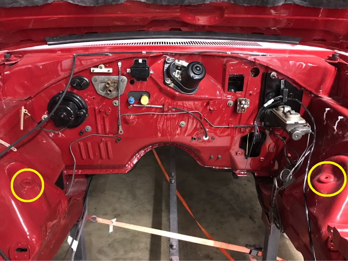

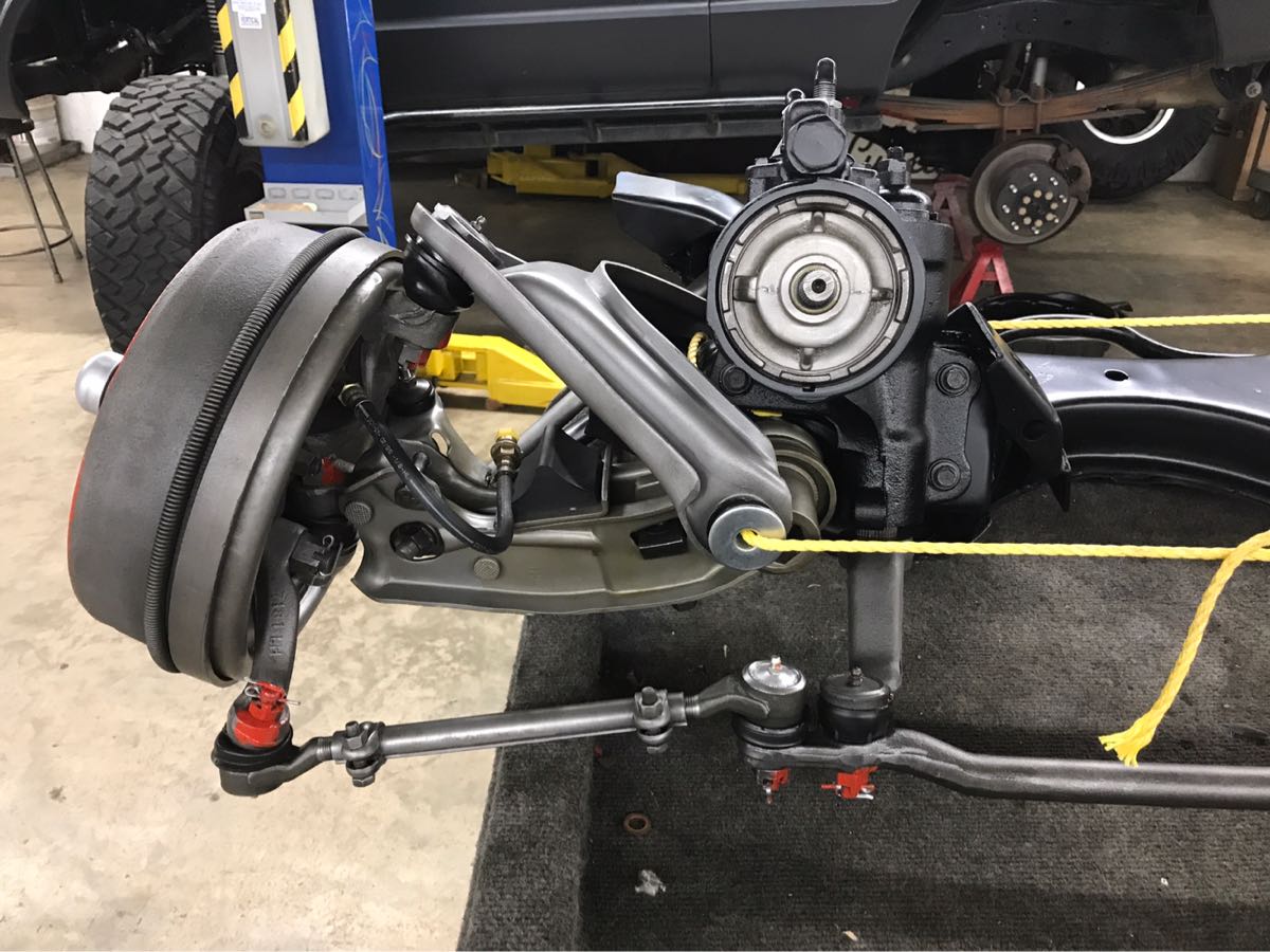

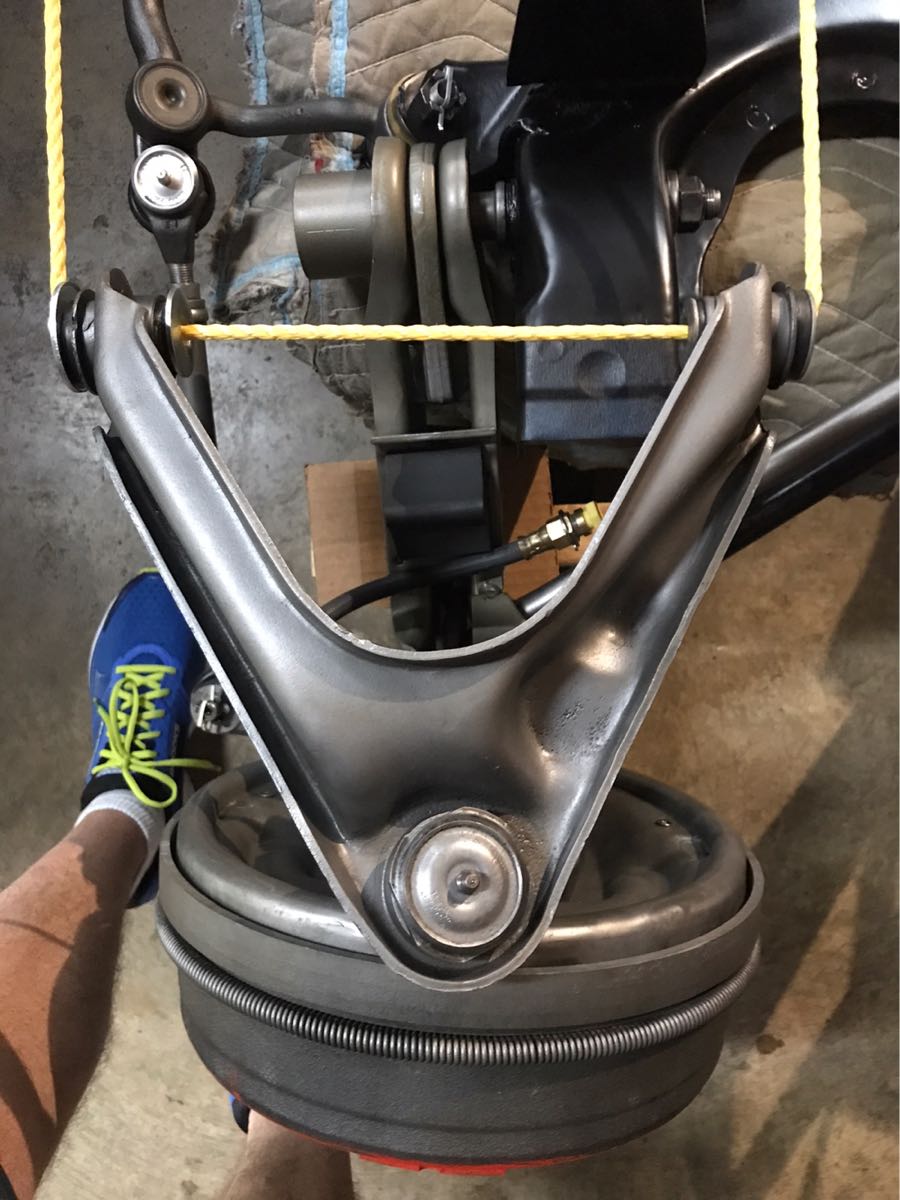

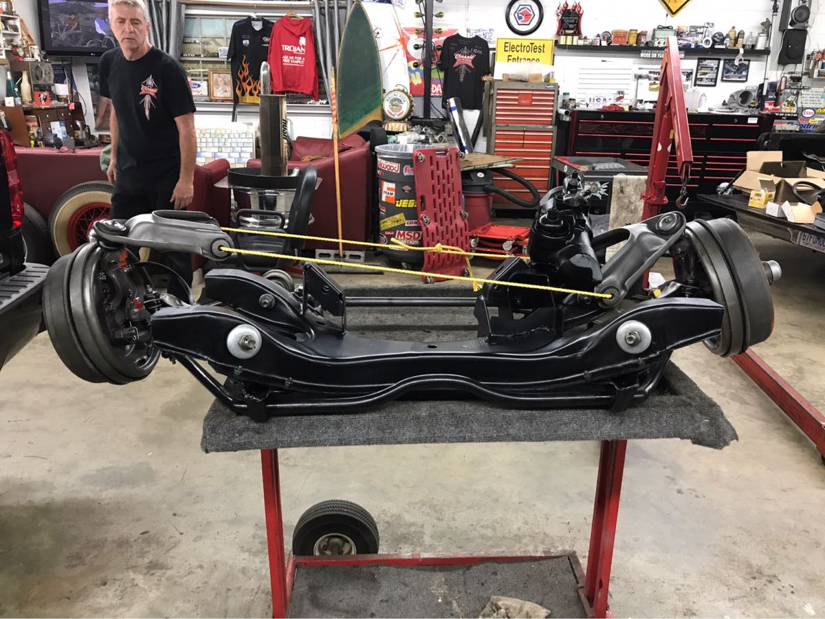

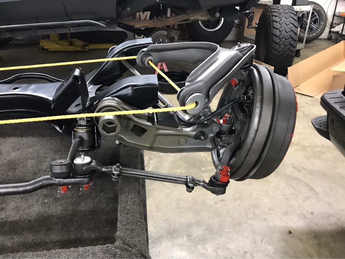

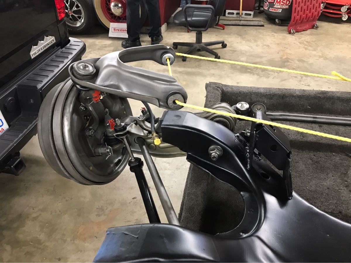

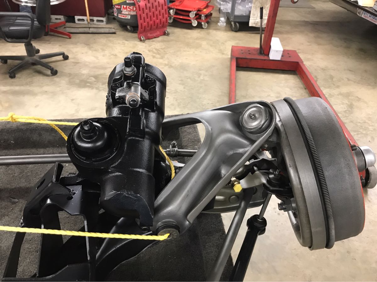

You might want to install the upper control arms to the Body/inner fender structure before you drop the body onto the subframe. The weight of the drum already attached to the A Arm might make installation difficult.

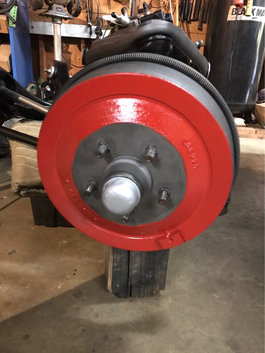

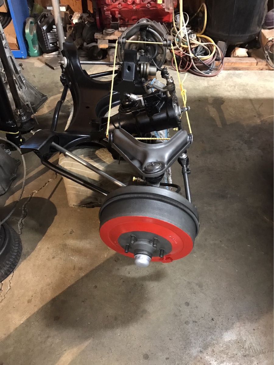

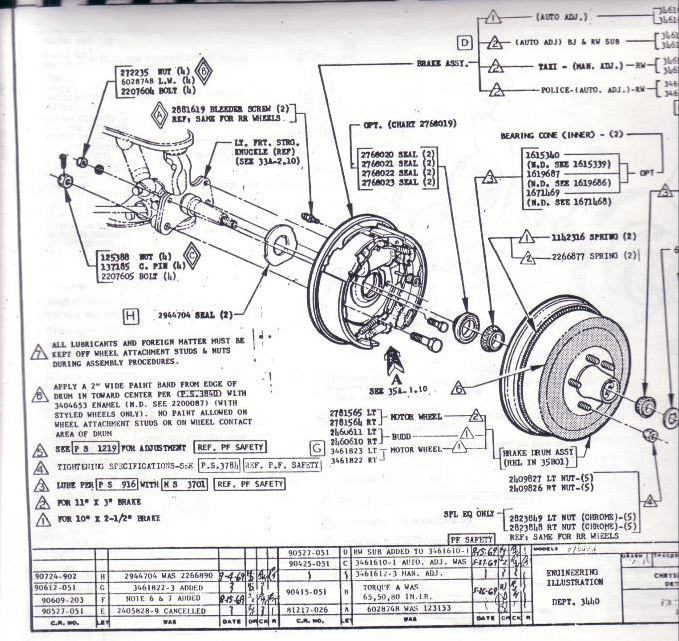

Looking good! You did good on the brake drums. They were not painted on the mounting surface or the wheel stud area. See attached factory document.
Looks great! Keep up the good work!

Originally Posted by A12pilot View Post
Lawrence,
Cheers
Dave
Dave, thanks for all the help thus far. Your knowledge is impeccable. Sure I will be bugging you more in the future!!!

Yes.... and I think you'll find for every ONE example that you find, you'll find 10,000 done correctly. That's the document that says how it's supposed to be done, man. He's going for what was correct. That's what's correct

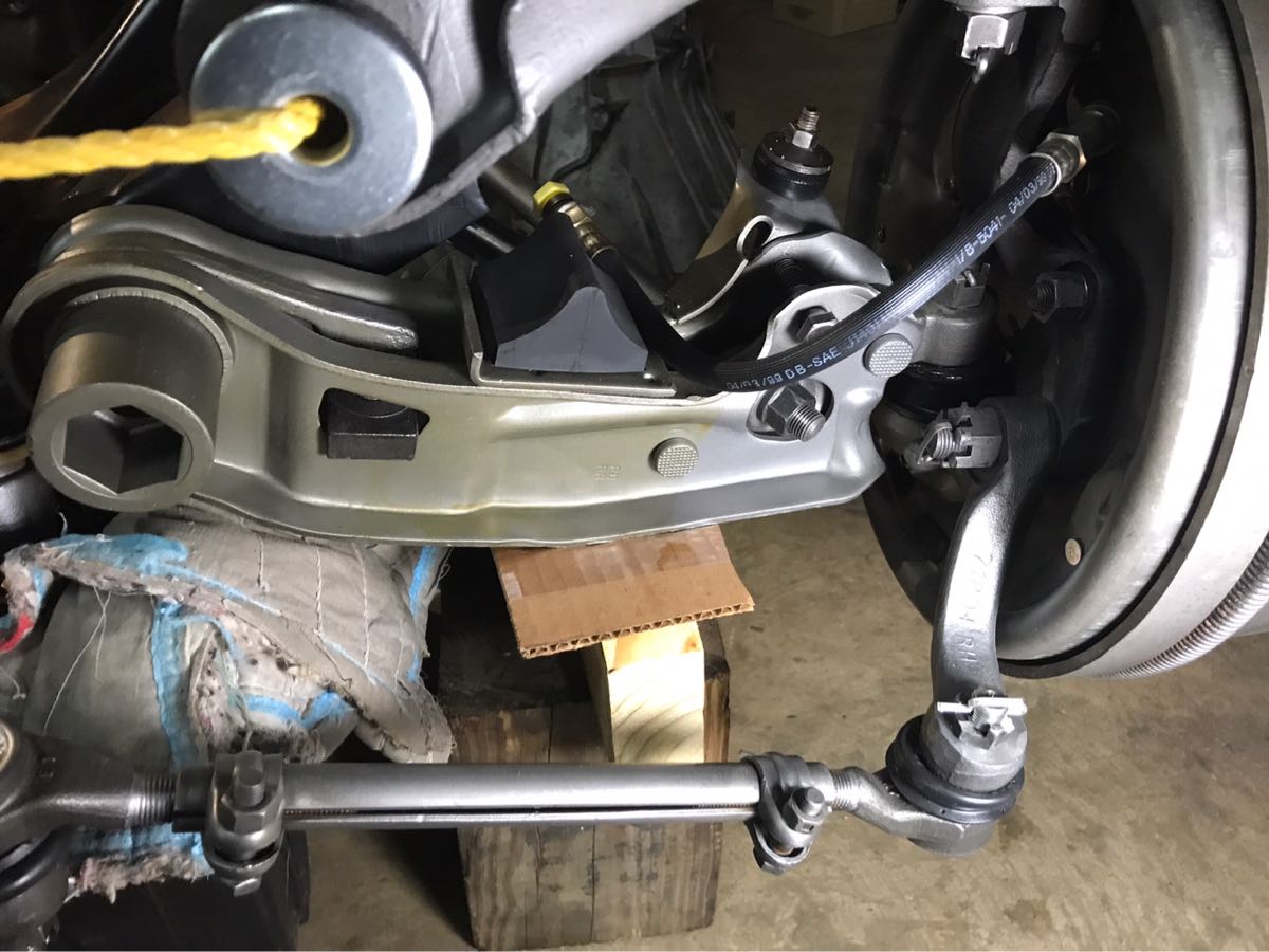

Thanks guys. Yea I was not so happy with the spray cosmoline I used. That is three heavy coats. I may see if I can spray more on the lower control arms for more apparent coverage.

Exactly, Steve! We all know there were always exceptions to the rules when it came to "Get that car down the line!" You're always safe with how it was "Supposed" to be done, unless your individual car shows different and you can show that. Every brand has it's individual nuances...and seems Mopars take the cake!!!

Now....lets see the ever so popular "drop" of the car onto the k-member!!!!

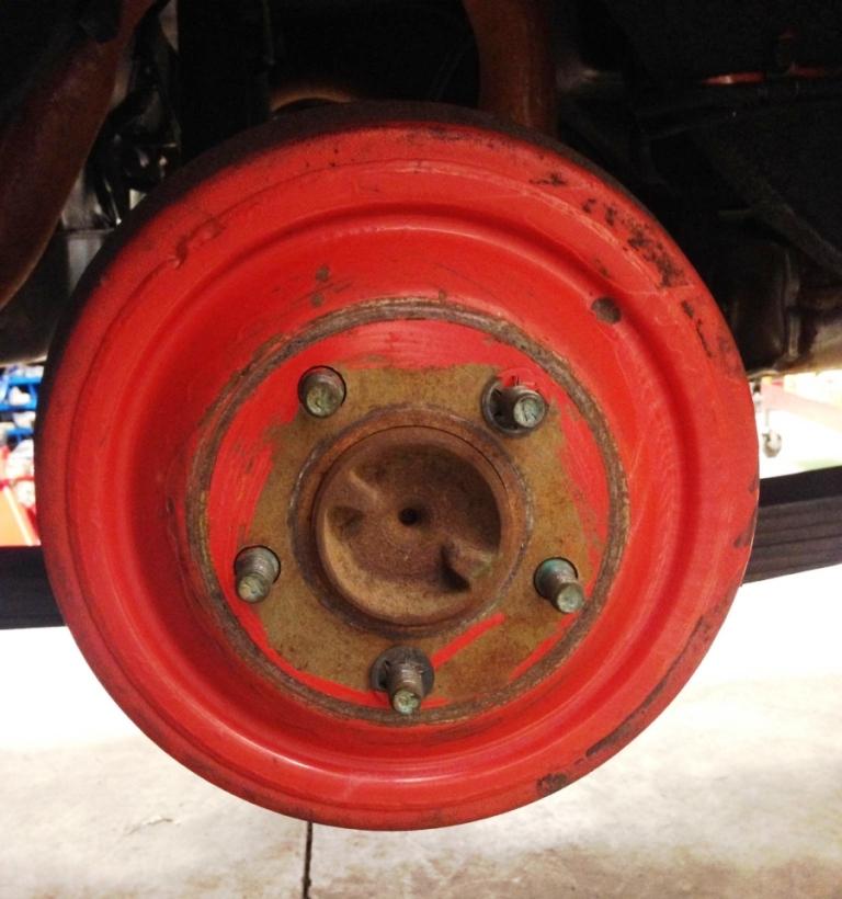

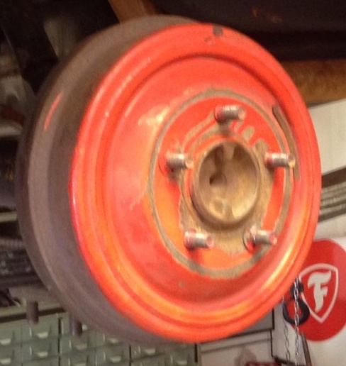

My original drums on my Bird
Does the car have steelies or road wheels? No drum red paint on steelies - just on "styled" wheels.

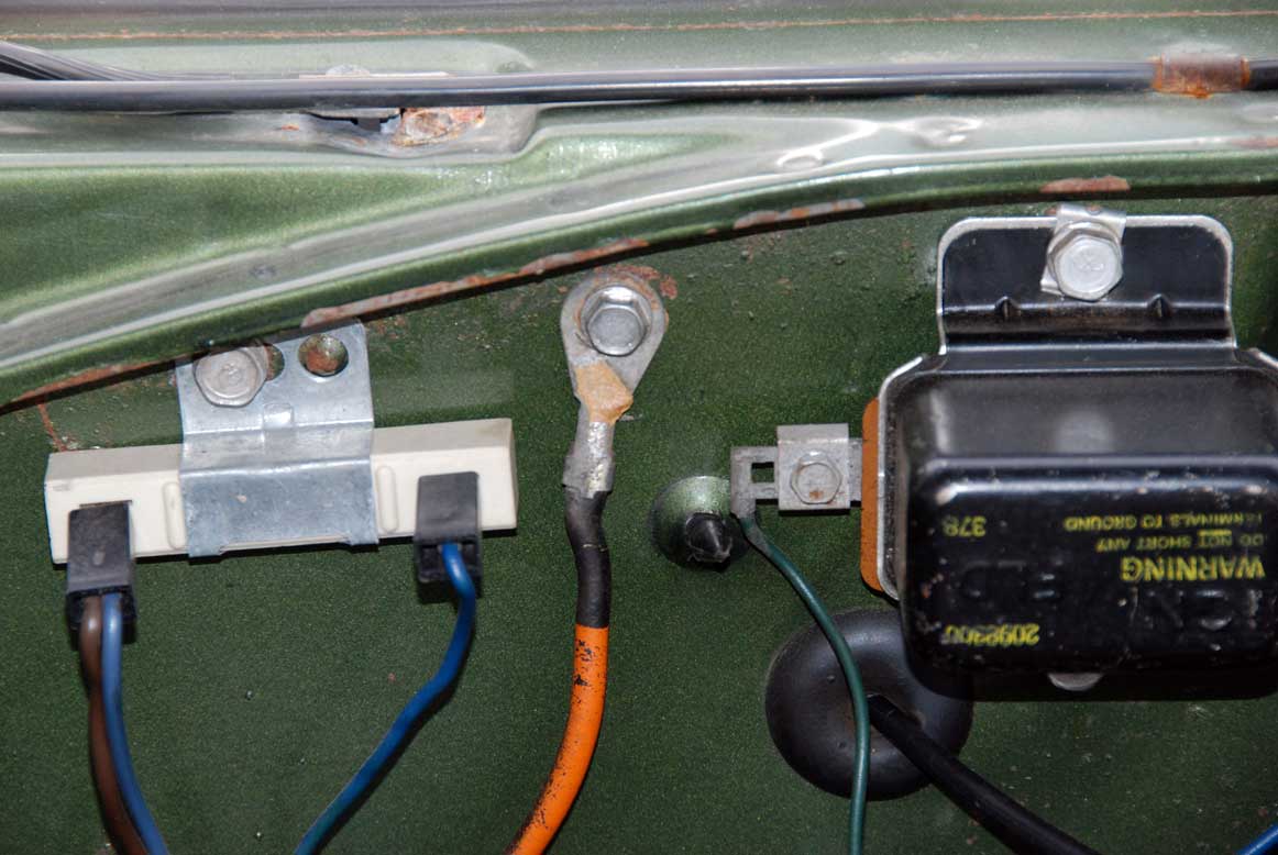

The engine ground strap (rear) was on the engine when it was painted and the terminal end was masked off....from my GTX
