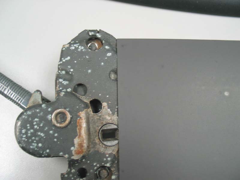

Lynn, I was looking for the Binks #200 internal mixing cap and started talking with the guys from "CATechnologies", a group of guys that were at Binks and started their own company. They were really helpful and knew quite a lot about multicolor paints. I bought a Lynx L100C with 1.8mm-200 internal mix air cap gun for $241. This gun with internal mix cap has to be used with a pressure pot. I tried it today and it works great. I am now getting the pattern and correct size aqua splat with Johns paint. The only original paint I have is my trunk lock to compare to and I posted a picture. Also pictures of the spray equipment and sample. My grey primer background could be a shade darker. George

One other question. You sample looks like three colors, but the latch looks like it only has two. Am attaching pics of original paint on a trunk divider, which admittedly probably didn't get covered quite as well as the rest of the trunk area.

Lynn, John Berlage's paint does not cover like the original paint did. Or if you did spray it on to totally cover your primer you would end up with too many aqua splats. I have asked him for the MSDS sheet to find out the make-up of the black tar like product but he won't give it up. I think if you could thin out the black and get it to spray evenly it would work a lot better. I don't like the black splats that you mentioned. The trick is to spray on and match a primer to the background color with the correct sheen. The back ground color also was thick and had a texture to it so you have to apply it accordingly. I bought some paint with I think the correct color and flatness that I was going use as the back ground color. I will spray it today and report back. George.

Lynn, In you picture above you mentioned that was the paint on your truck divider. Is that the cardboard piece you are referring to? George

Yes, the original cardboard trunk divider. It was in the car when they sprayed the trunk. Fisher body installed the rear seat, so I am assuming that divider and the rear seat were in place when the trunk was sprayed with the spatter paint. Same with the package shelf, but I haven't seen any where they painted high enough up to get any on the package shelf. No trace of the red oxide on the divider, so obviously installed after the primer, before the spatter.
Regarding the aqua spatter. Seems like most of what I see doesn't have enough of it. Can you post a pic of one you considered too thick with aqua?
Thanks again for all your work.
