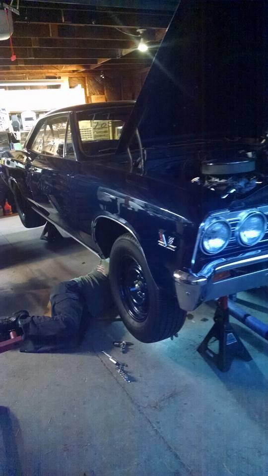

I had some help tonight--Eric &amp; Martin (Orange GTO and black `66 Chevelle, respectively) stopped by to help get the car buttoned back up. Eric took a pic &amp; posted it to Facebook.
