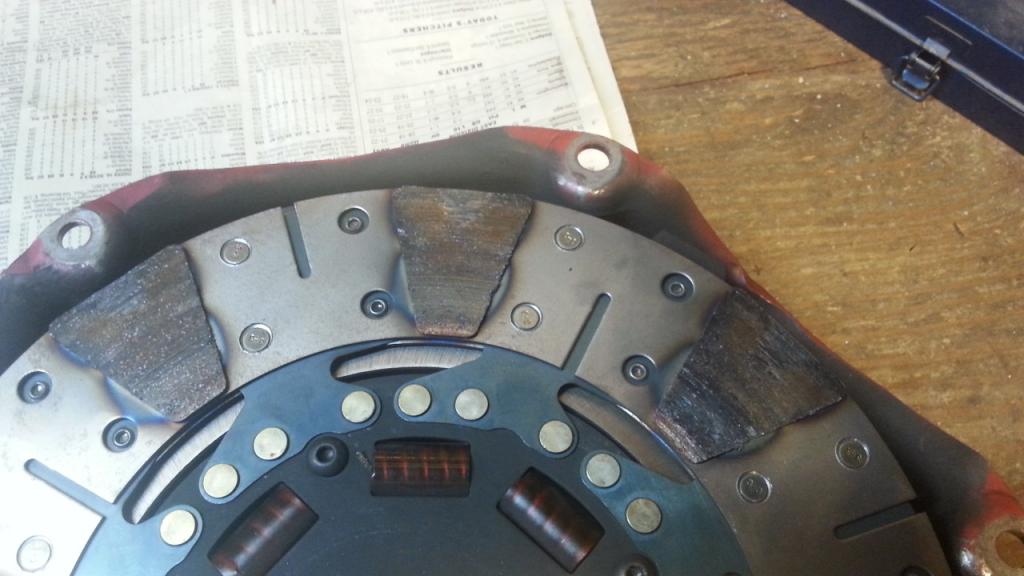

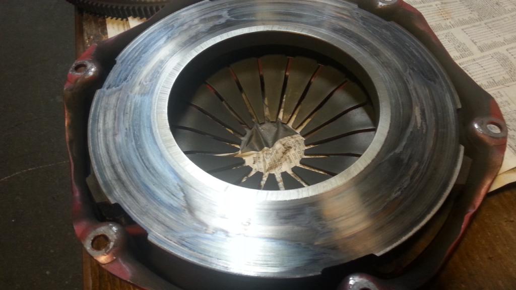

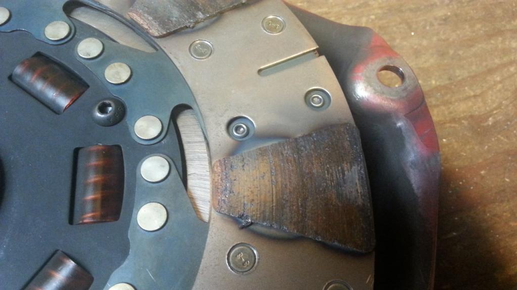

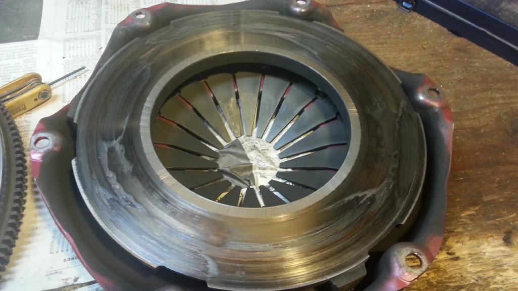

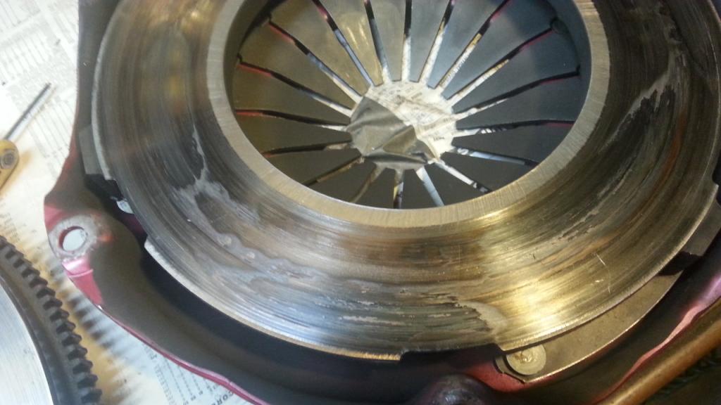

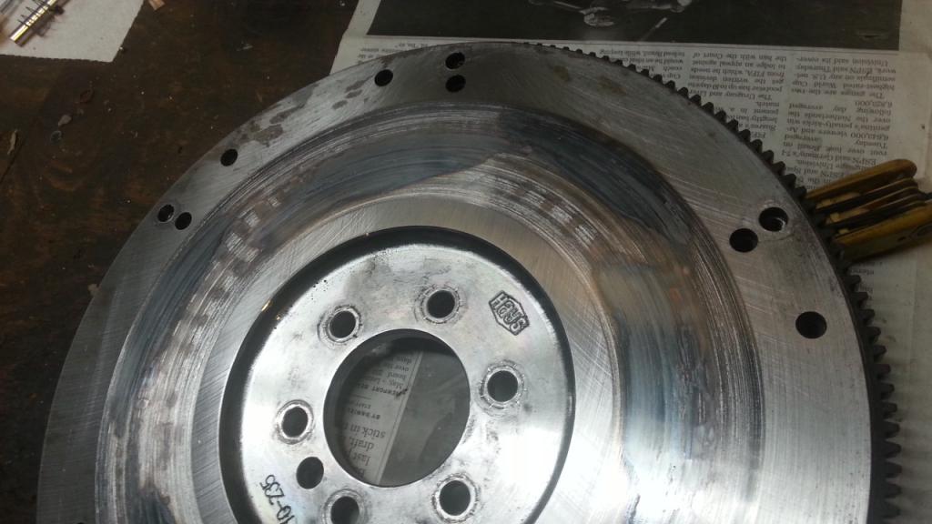

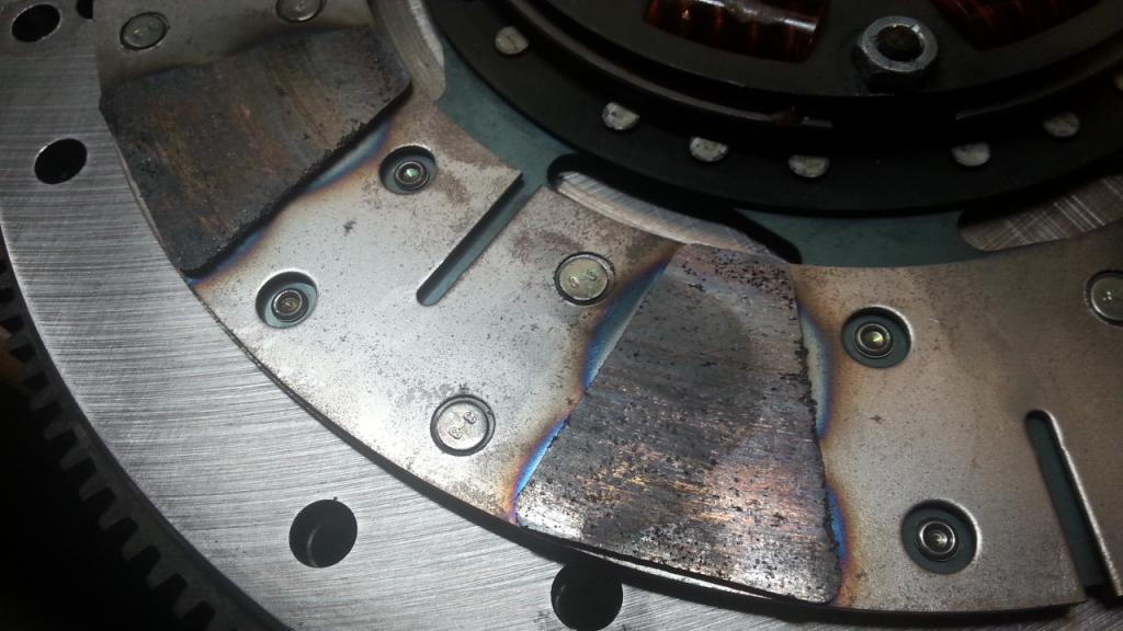

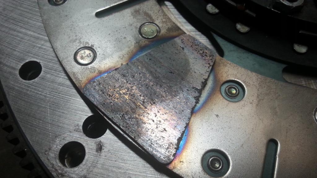

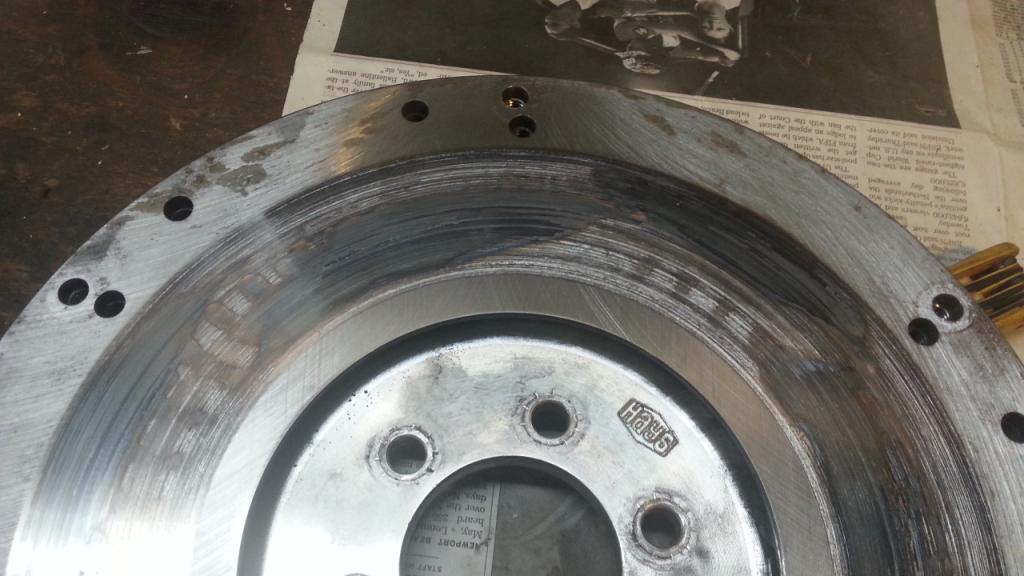

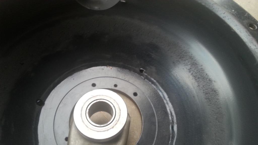

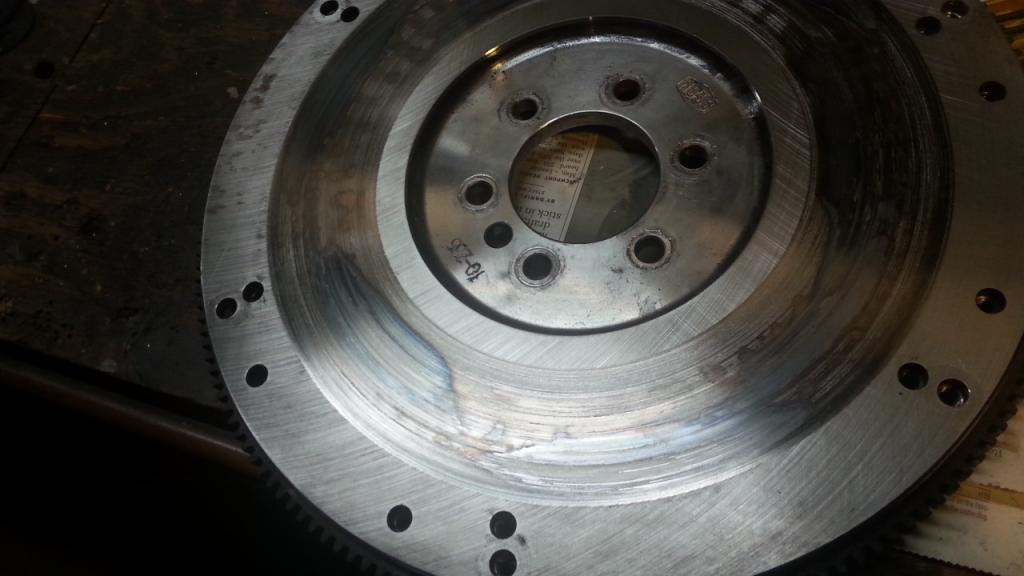

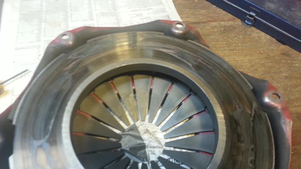

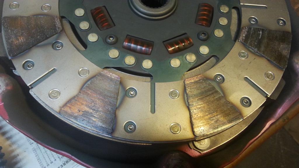

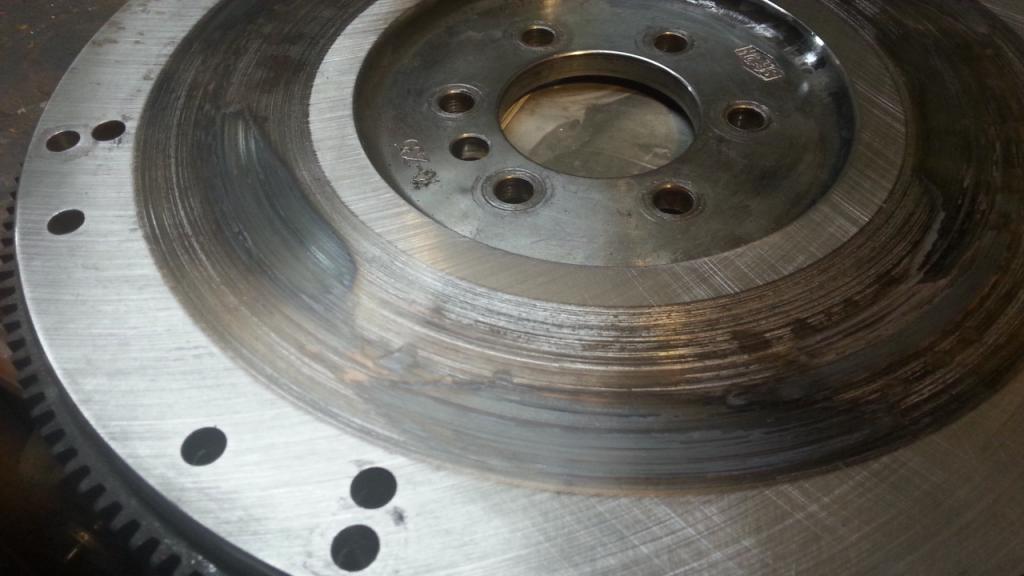

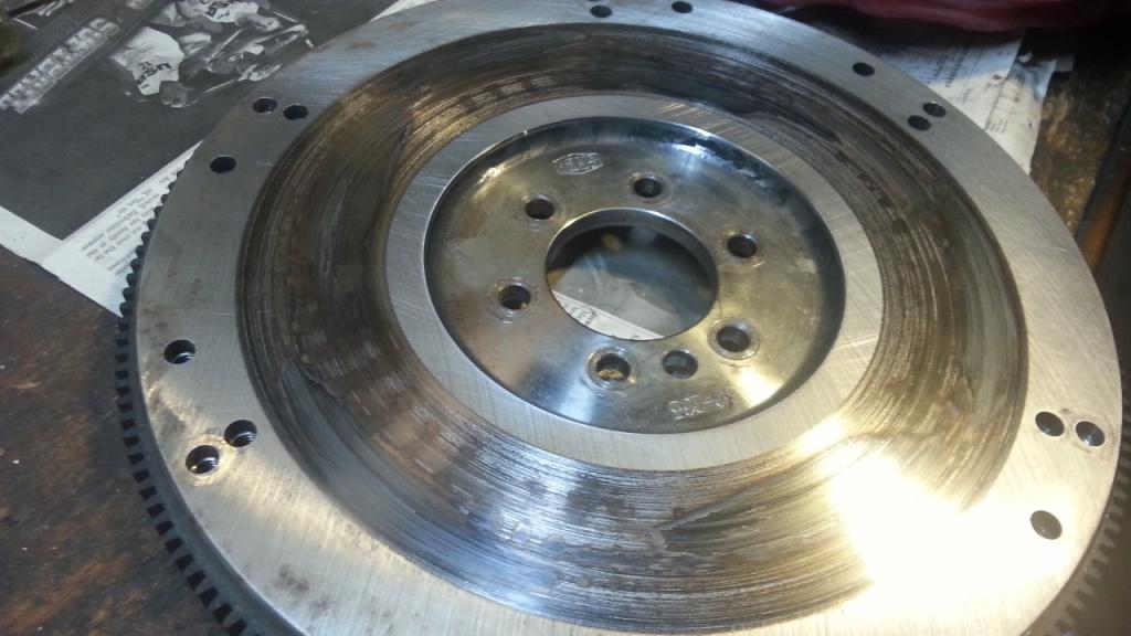

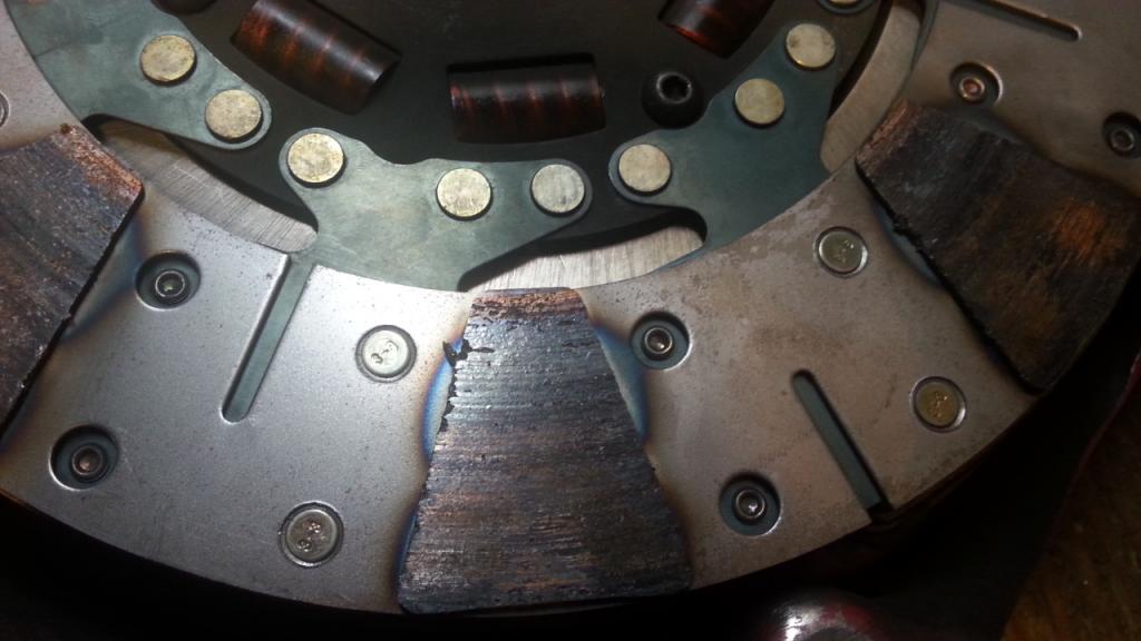

Lest anyone think I was bullshitting about driving through the clutch or trying to make excuses for the cars performance--or lack thereof so far:
Can you say &quot;carnage&quot;? You can <span style="font-style: italic"><span style="text-decoration: underline">literally</span></span> catch your fingernail in the grooves and transferred metal on the flywheel.
The disc measures a full .030&quot; thinner now than when I first installed it--most of that is embedded around the inner circumference of the bellhousing as seen above.
This clutch is supposed to be good for 650+ HP and use with slicks.
I'm so disgusted with this right now it's not funny.
I'll decide what to do early next week.

Except it likely is rated for less hp than Eric is currently making. Doesn't appear to be have a manufacturing flaw.

I spoke to Ram last week. When I explained the situation, the guy was like &quot;Yeah, with your power &amp; weight, you're past the limits of that clutch.&quot; Would've been nice if the tech that I spoke to the last time I went through this would've told me that instead of recommending this Powergrip HD.
Paul;
This clutch is &quot;rated&quot; at 650 HP--I'm just over 600 at the moment. Obviously you can't just go by HP rating, vehicle weight has to be taken into consideration as well...as my situation clearly demonstrates.
