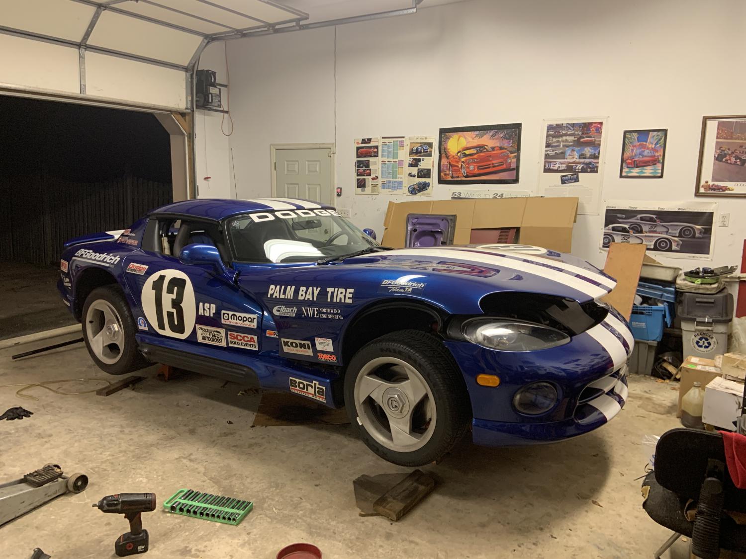

Here's the suspension details. The factory installed, fixed spring, Koni shocks were sent back to Koni in 1993 and they installed the adjustable spring perches for aftermarket Eibach springs.
I have been on the phone with Koni and Eibach this week trying to find the correct spanner wrench for adjusting the spring heights in case I ever want to mess with the settings. Back in the day I uses a 5/16" drill bit inserted into the adjuster hole in order to spin the spring perch. Not too easy with 500 lb rated springs. Neither company makes the wrenches so I had to search to find an old style round tip spanner for a 82mm perch. It should arrive tomorrow. All the modern perches now employ a square adjuster slot and use a flat, hook style wrench.
FYI, In 1996, the Gen 2 suspension replaced everything you see here with forged aluminum control arms, different shock/springs and a totally different articulation geometry that made the car much easier to keep in a straight line and much more forgiving to newbie owners. It was a night and day difference. They also added airbags, roll up windows, and actual door handles on the outside of the car. Simply preposterous, I tell you!

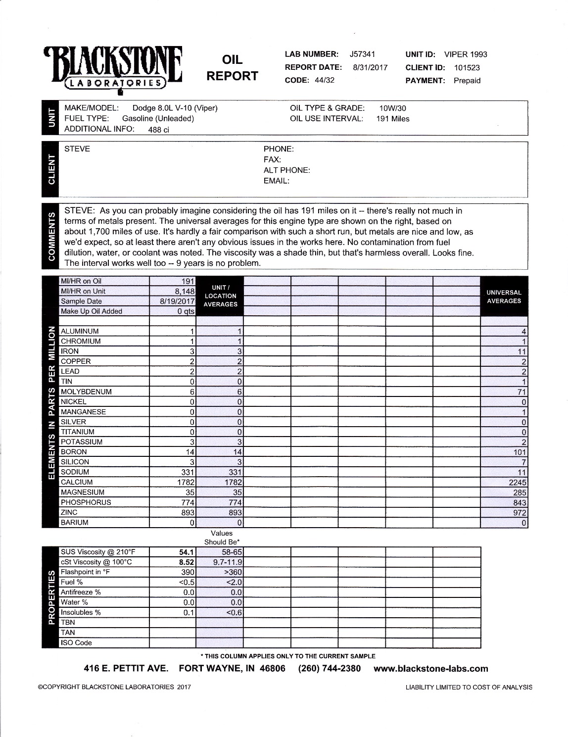

I got the transmission oil analysis back from Blackstone. Looks good for 27 year old Dexron (Torco Synthetic version that I filled it with around 1995). I guess I changed it just in time as it just hit the .1% insoluables level. :-)
Waiting on the rear differential and engine oil results next.

And I finished the engine oil change I started over the weekend and sent off the sample to Blackstone.
It had 5-year old Valvoline traditional 10W30 with around 500 miles on it from the last change in 2017. I went with Mobil-1 10W30 this time. These big engines take 9-1/2 quarts to fill. And I used a Wix 541085XP filter. As far as I know, it's the best filter there is on the market.
