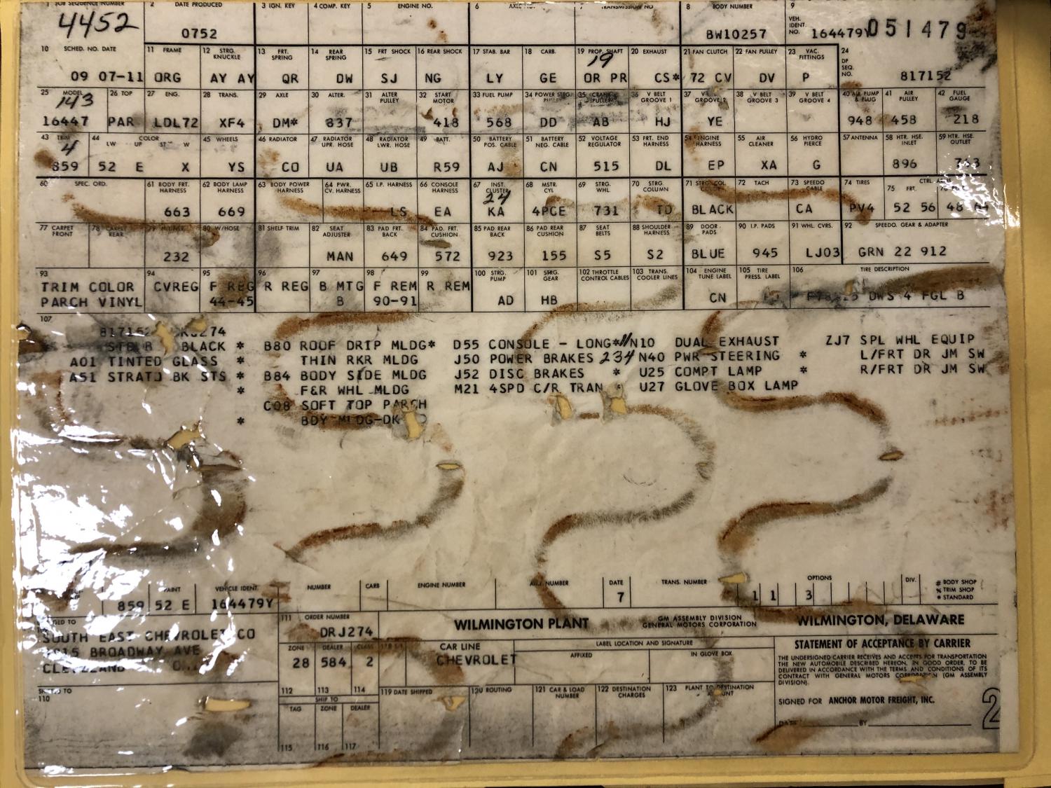

Here's the window sticker for the 1 of 1 known "L89" 68 Chevelle SS.
Old 01-03-2021, 09:25 PM
Posts: 6,348
Thanks: 1,636
Thanked 1,946 Times in 943 Posts
Also 1 of 1 with "Powder" steering

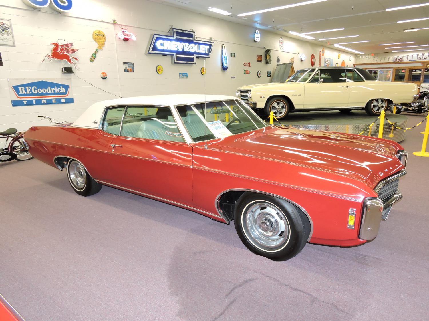

Here is a picture of the 69 Impala SS L72 along with its window sticker and build sheet.
