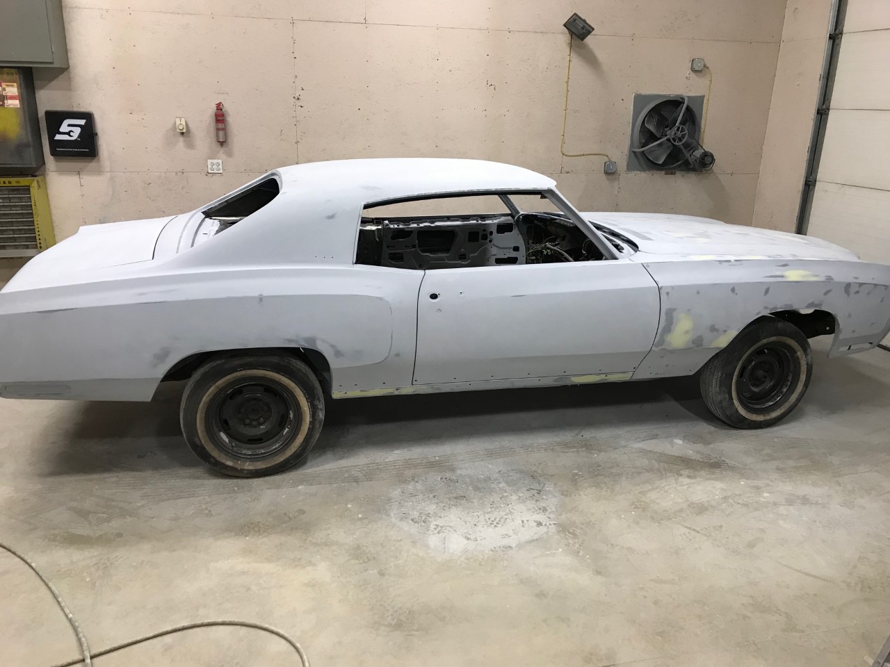

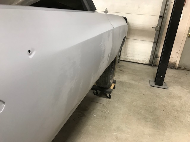

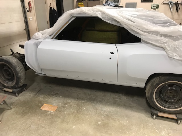

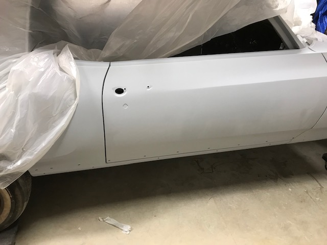

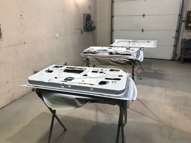

First round of overall blocking complete. Another coat of high build primer tomorrow. Once all the panels are to my satisfaction I will disassemble for final top coat. Jeff wants the front end all rebuilt so while I have it all apart I'm going to detail out the engine bay.
Looking for the next project.

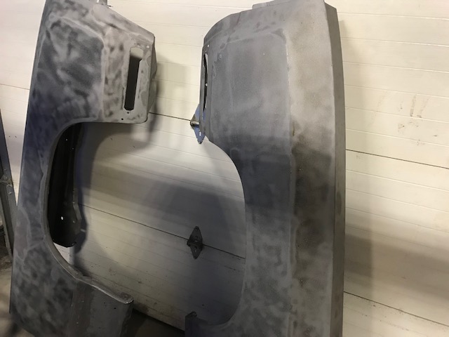

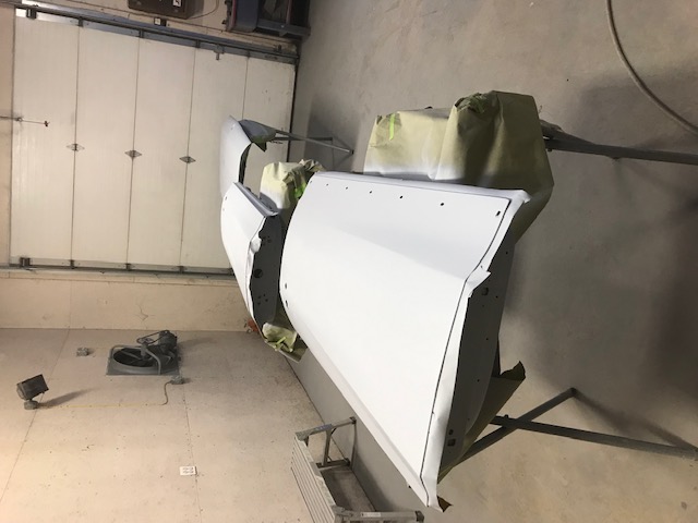

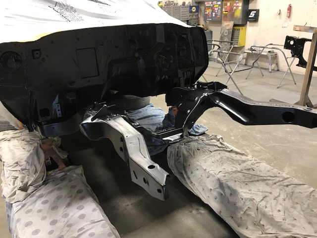

Been a busy month. The disassembling of the front end, degreasing and sand blasting all the small parts sure does take a lot of time. Epoxy primer was applied last night, top coat tonight.

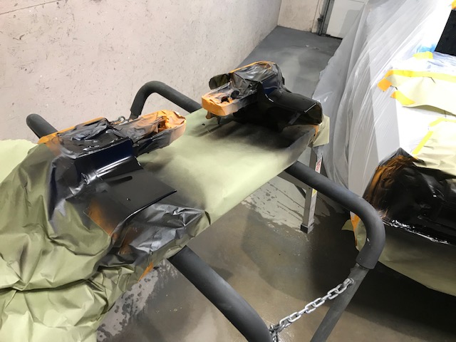

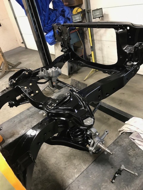

The front end is all back together. I'm just waiting for the backing plates and caliper brackets from the platter. Power bucket seats have been installed. I applied some color this weekend. Medium blue to the interior and blacked out the rear tail panel like the 71 SS.

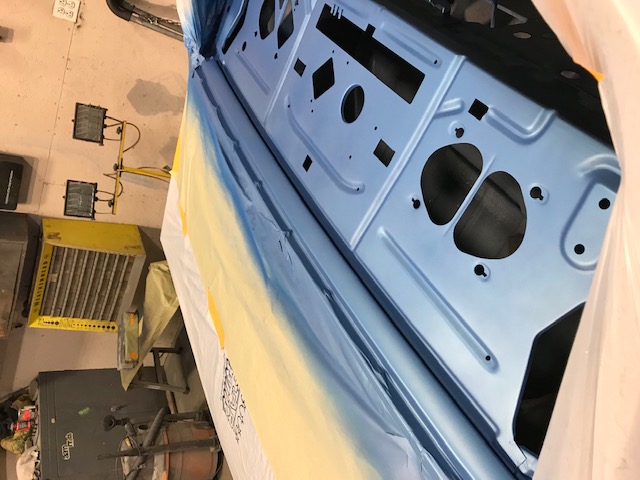

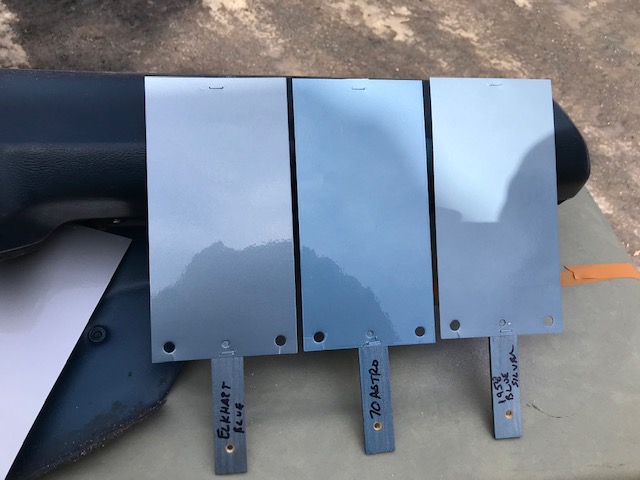

The painting process has started! ASTRO BLUE!

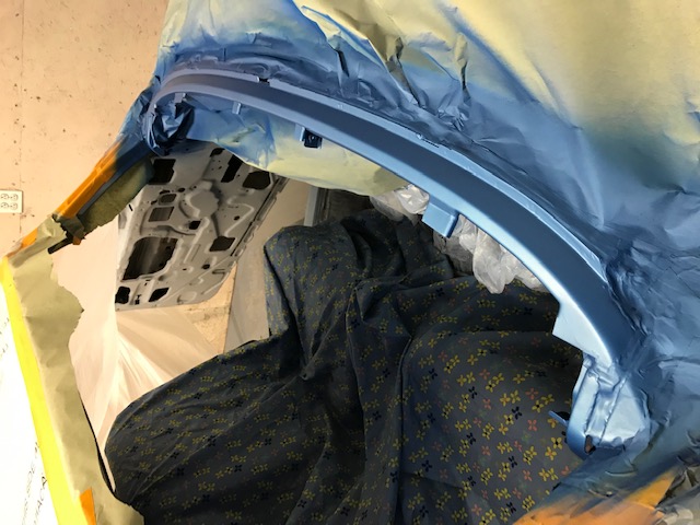

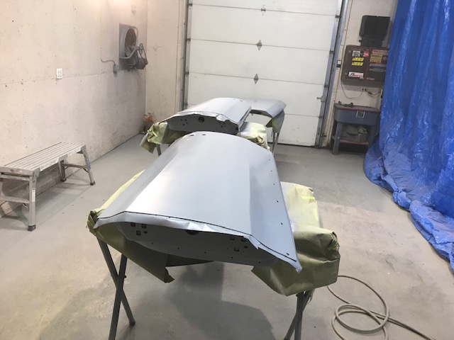

Body painted! I stretched my arms 2" to reach the center of the roof. Some big panels on this car. Used just about 1 1/2 gallons of base color and a little over a gallon of clear to cover all the panels.
What paint system/brand did you use?
