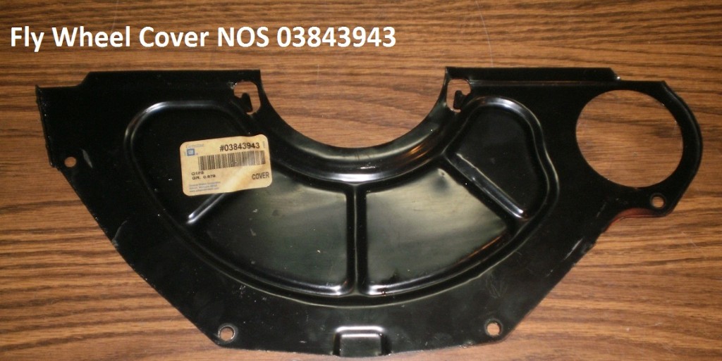

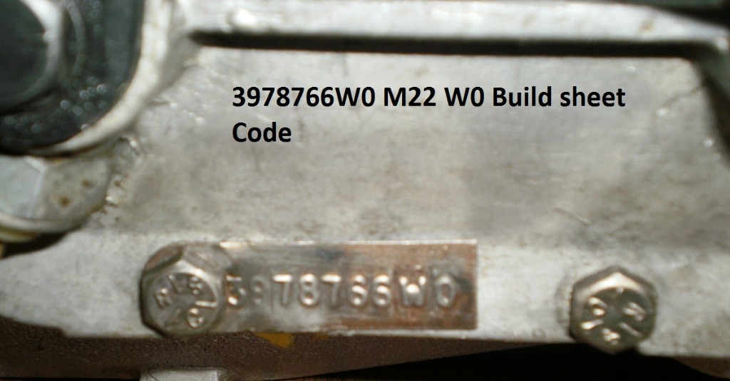

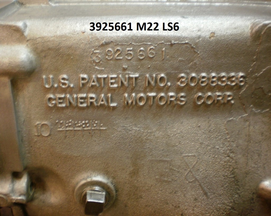

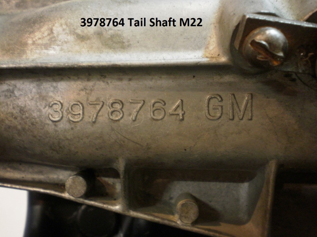

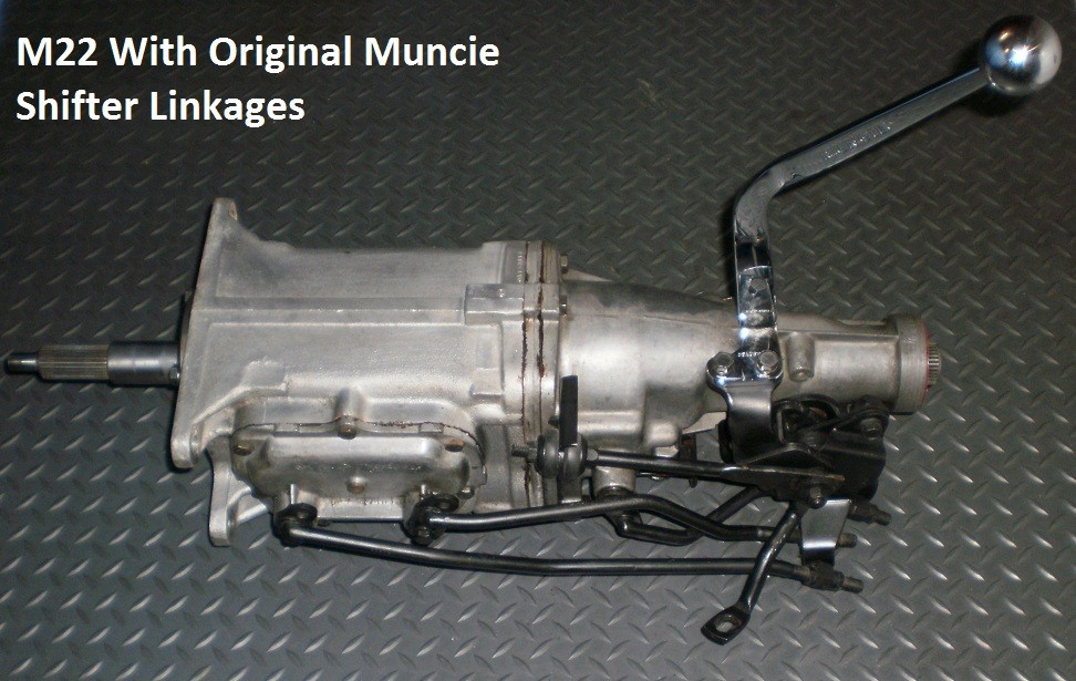

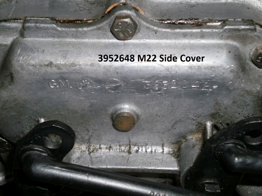

Next is the Transmission.
I was thinking on using a Center Force Clutch package for my M22 with 11" Clutch and 26 Tooth spline.
The one i took out of the car has no identification as to what company the Clutch package was but it did run well.
What are you guys running for your M22 as far as the Clutch assembly goes. I will be going with a new Clutch/Pressure plate/pilot bearing and bushing as it makes sence to have a new unit go along with a rebuilt Motor.
Here are photos of the trans etc...

one more photo.
Note :: The transmission has the original Muncie shifter and rods.
Yes i know it sucks but it's there and i will leave it alone.
The Hurst assembly is a much better shifter but i kind of got used to the old Muncie and it is nice to have it original. [img]<<GRAEMLIN_URL>>/smile.gif[/img]

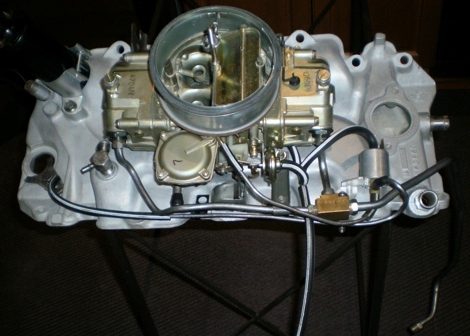

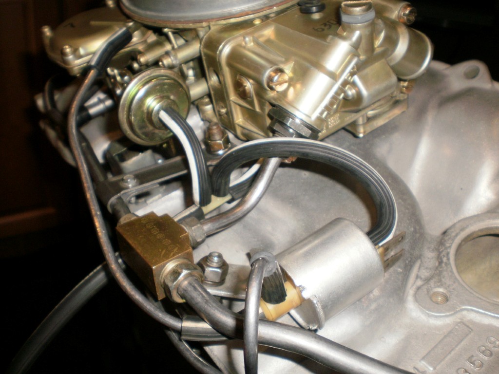

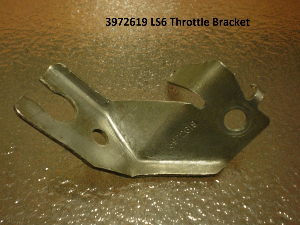

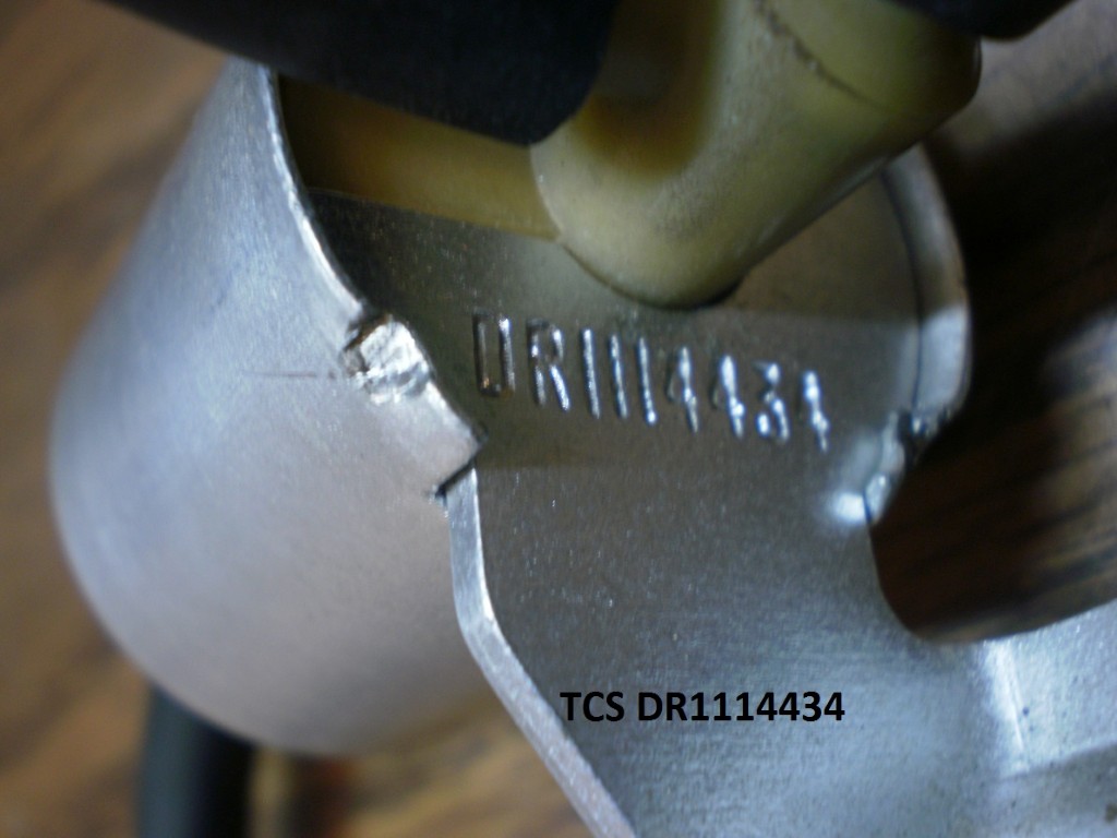

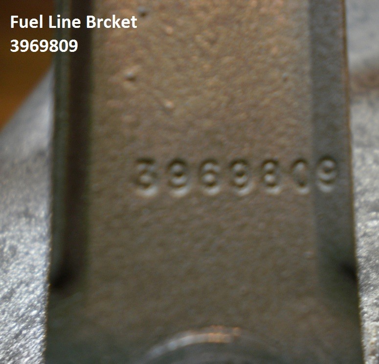

Today i routed my TCS vacum lines and i had to make the top pipe from scratch as it was missing for some reason.
I had plenty of pipe and hoses kicking around so i made it myself.
I think it came out rather well.
Below are photos just incase someone else has to do this for there car. It sure is a lot of small parts to hook up.
Also included photos of the other cool stuff that hooks up to the fuel lines etc...
I pre fitted everything today to make sure its all good.

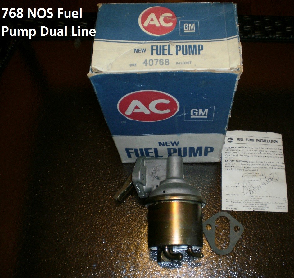

Ran out of room for the photo of the NOS fuel pump.
Here it is along with other small stuff.

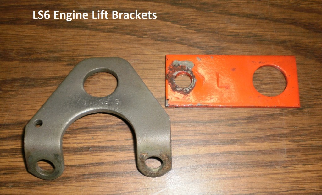

Does anyone know what the number is on the engine lift?
A few of my numbers are to pitted to read properly.

Nice parts/pics..those aren't LS-6 specific engine lift bkts.,as all 1970 Big Blocks used them.

<div class="ubbcode-block"><div class="ubbcode-header">Originally Posted By: Mr70</div><div class="ubbcode-body">Nice parts/pics..those aren't LS-6 specific engine lift bkts.,as all 1970 Big Blocks used them. </div></div>
Thanks Rick,
I figured out the part number for the front lift which is 3969829 [img]<<GRAEMLIN_URL>>/biggthumpup.gif[/img]
These would be used for all the Big Block Motors like you said.

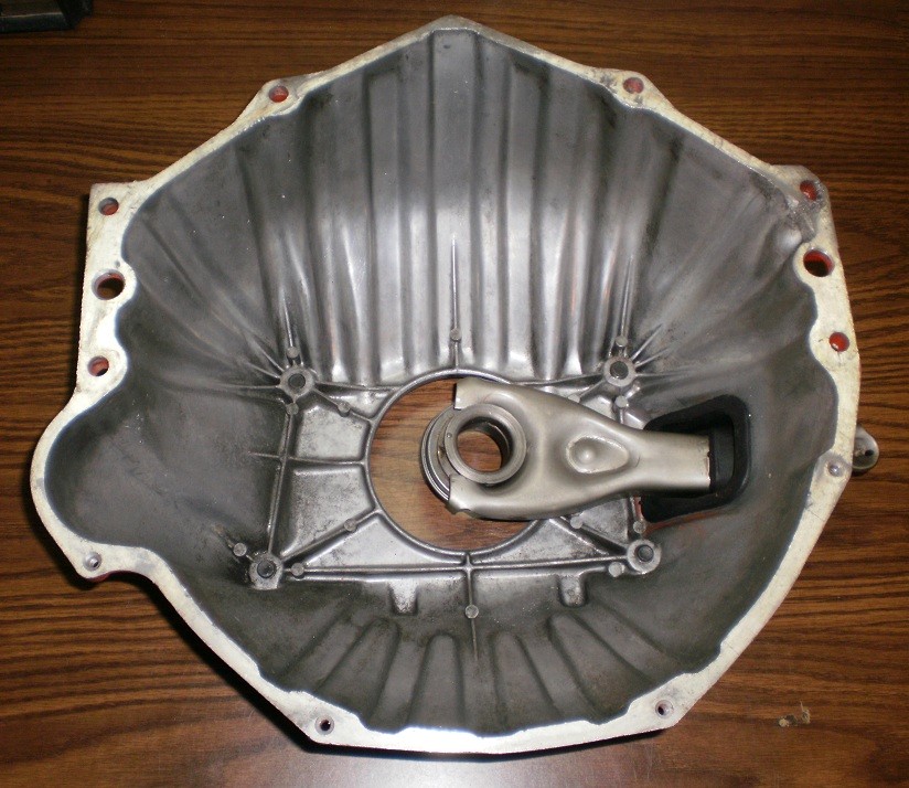

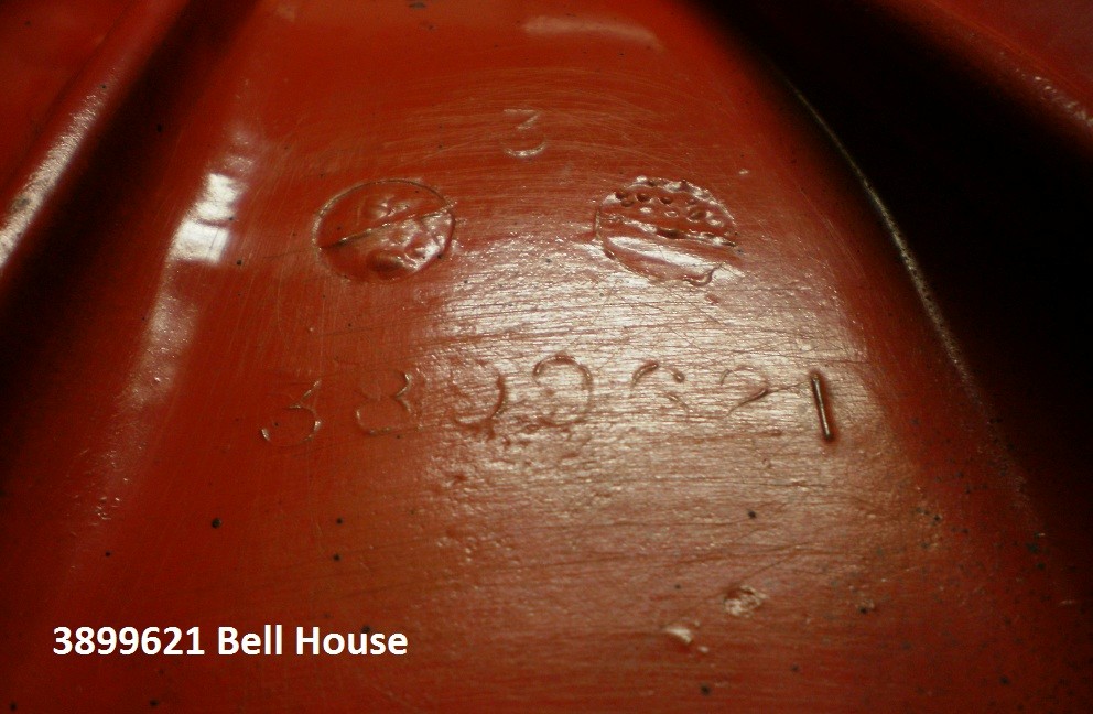

Good detail shots! Send the bellhousing to Jerry MacNeish and having him reskin it. Shoot it half orange with a dusting of overspray onto the other half.

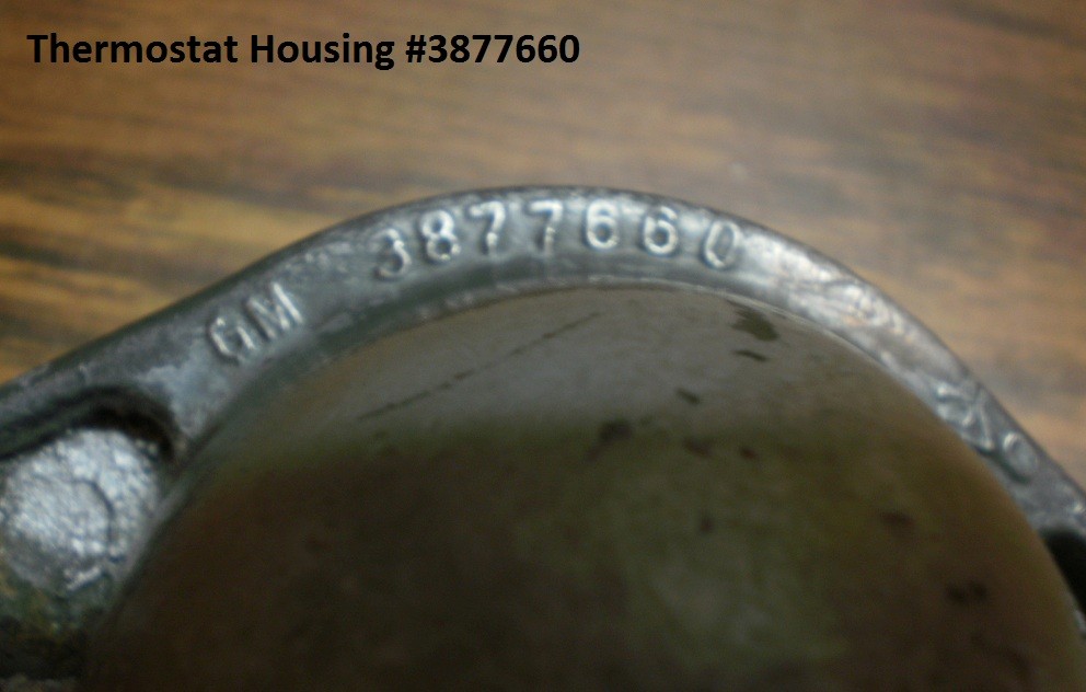

The 660 thermostat with #s on the base of the unit is for a pre 1968 Hi-Po Chevy. Your #s should be on the neck on the thermostat. I have a late one if you'd like to trade?
