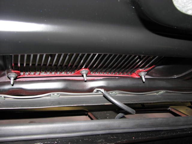

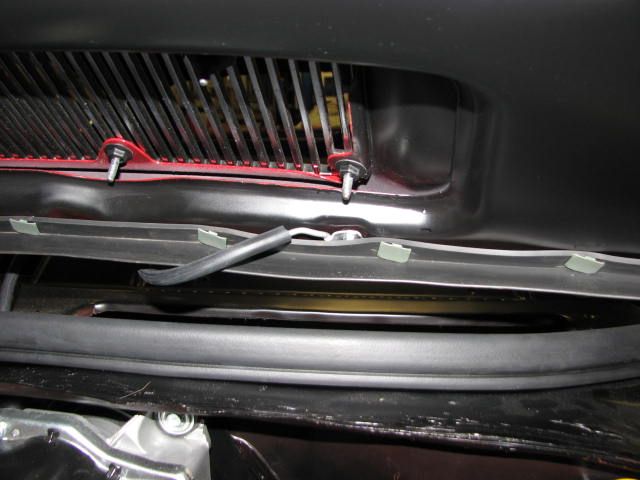

Rick how do you get the window washer squirters in the hood

Let me know if these photos do not answer your question and I will take others.
