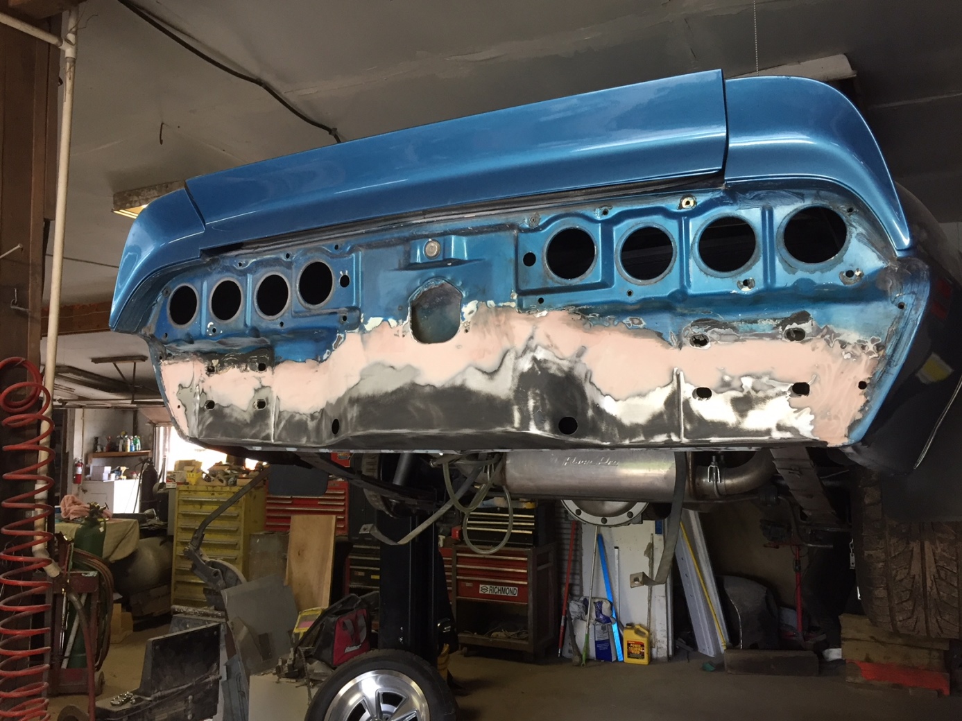

Today's progress on the rear panel. Should be in primer tomorrow and hopefully painted blue on Monday. And after all that work, it's all gonna be hidden behind the tail lights and the body colored rear bumper assembly. But at least I'll know it's all fixed now. :-)

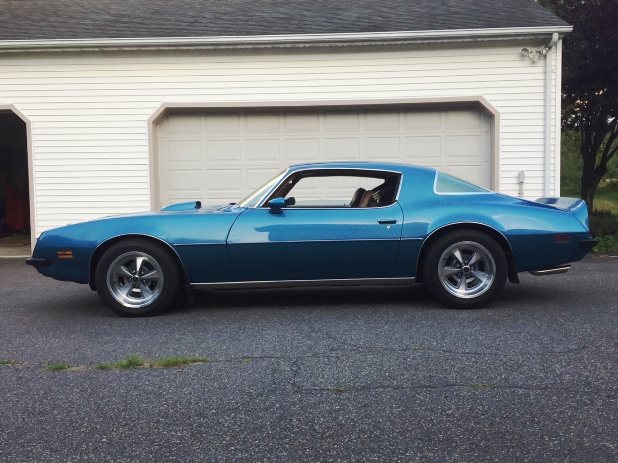

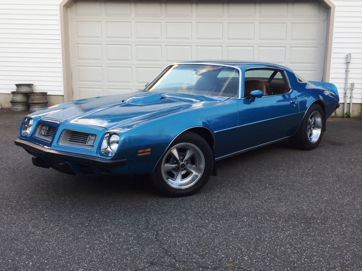

Spent the weekend reassembling the back end of the car. I had pulled the new leaf springs I installed last spring in order to get them de-arched one inch to drop the back end down a little bit. The week before, I had swapped the original set of rusty leaf springs back in for the week it spent at the body shop getting the rear panels installed. That gave me time to bring the springs back to Stengel Brothers Springs in PA to get them worked on. They have a special press that can squash the leaf pack down to a specific measurement. Worked like a charm.
I then spent yesterday swapping in a new set of front coils since the one inch drop that I ordered for the custom springs was not enough. They built me a new set at half price that were 1-7/8" drop.
New fender lip height is 27-1/2" front and 28-1/2" rear. Before these new modifications, it was an inch higher on both front and rear.
Here is how she sits now. I think the stance is just right for this set of wheels now. They fill the wheelwells nicely. Though if I had it to do over again (again) I would get a slightly smaller set of front tires instead of running the 255/50x17s all around. Maybe a 235/55x17 front.

mockingbird812's Avatar
Location: Dayton
Posts: 14,424
Thanks: 917
That sits real nice!

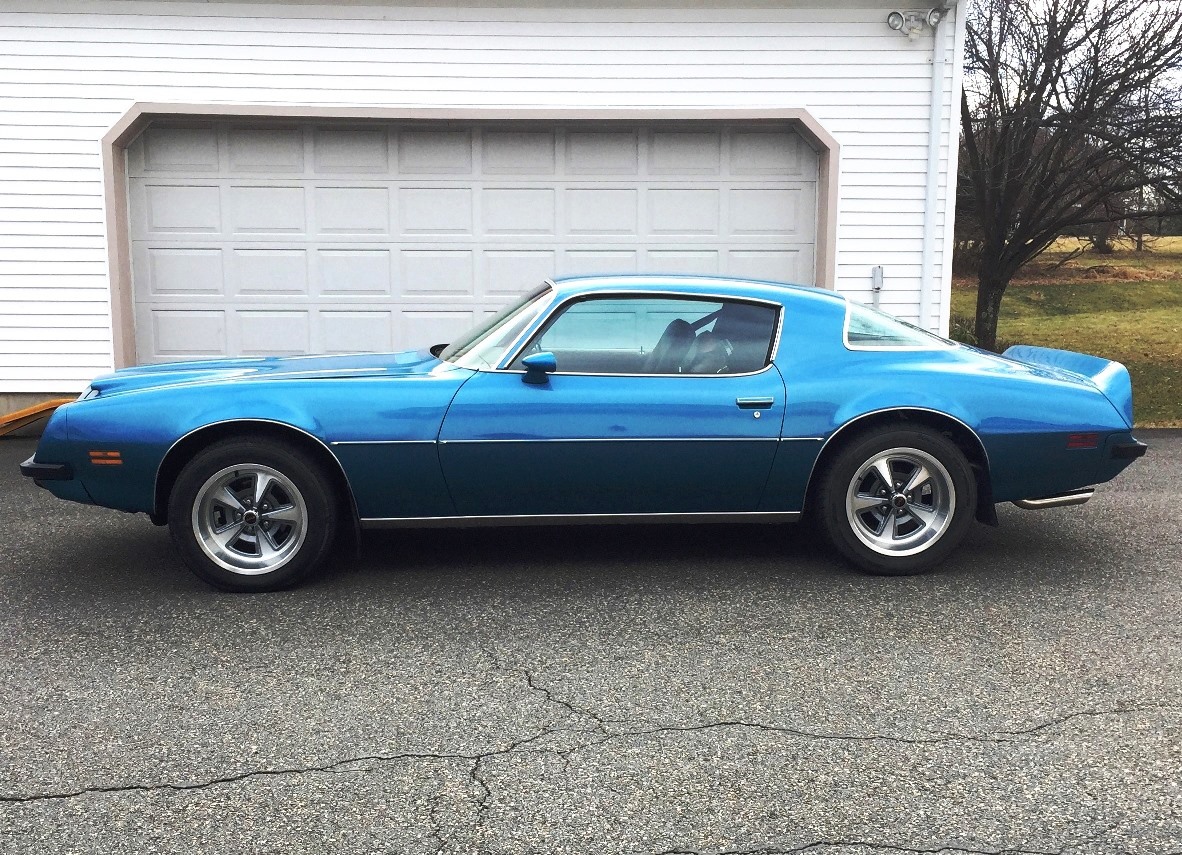

Old 07-06-2018, 01:08 AM
njsteve's Avatar
njsteve njsteve is offline
Join Date: Nov 2003
Location: NJUSA
Posts: 8,513
Thanks: 11
Thanked 3,064 Times in 934 Posts
This was what it looked like before this weeks "adjustments". An inch makes quite a difference...

Old 07-07-2018, 03:15 AM
9999 9999 is offline
Join Date: Mar 2013
Location: Central California
Posts: 61
Thanks: 38
Thanked 9 Times in 7 Posts
Absolutely perfect stance. That car looks like a dream, Steve.

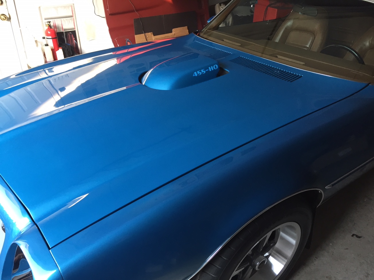

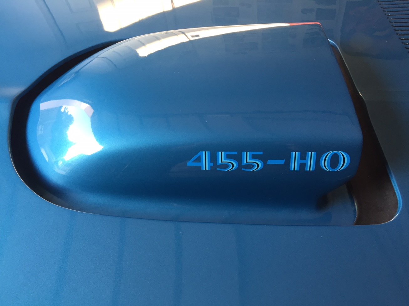

I finally found a shaker decal I liked...and it is actually for a 1975! These came on the 455 powered Trans Ams that were available in 1975 with a low compression 7.6 to 1, 200-horsepower 455: the same one in the big family sedans. It was a 455-HO in name only.
But the decal looks cool in the three-dimensional, blue color that accents the car's color.
And since the 1970 455 block in the car has parts from a real 1972 455HO inside it, I guess no one will really complain that it has twice the horsepower as an actual 1975 455-HO. :-)

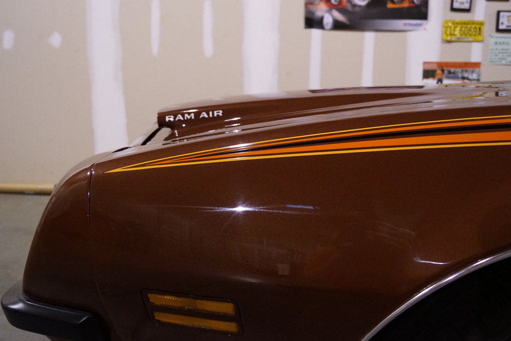

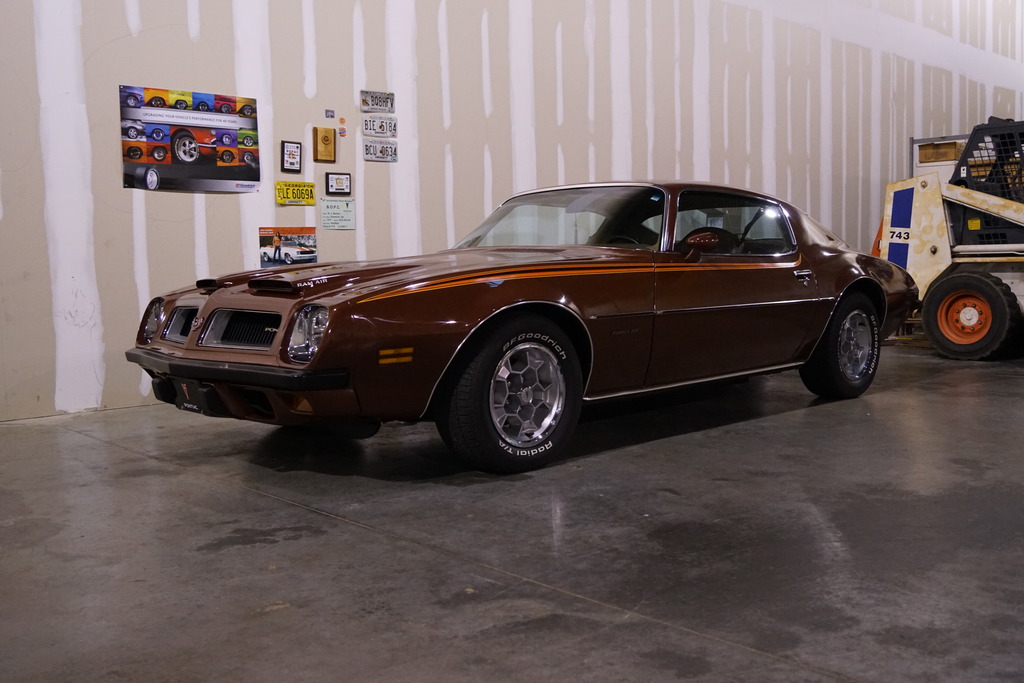

Now I'm wondering how the 1973-75 tri-color blue, fender accent stripe would look on the car. They were available on the base Firebird, Esprit, and Formula. Anyone have any photos of the blue version of the stripe? Here's a couple photos of a '74 maroon car with the orange tri-color version of the stripes.
