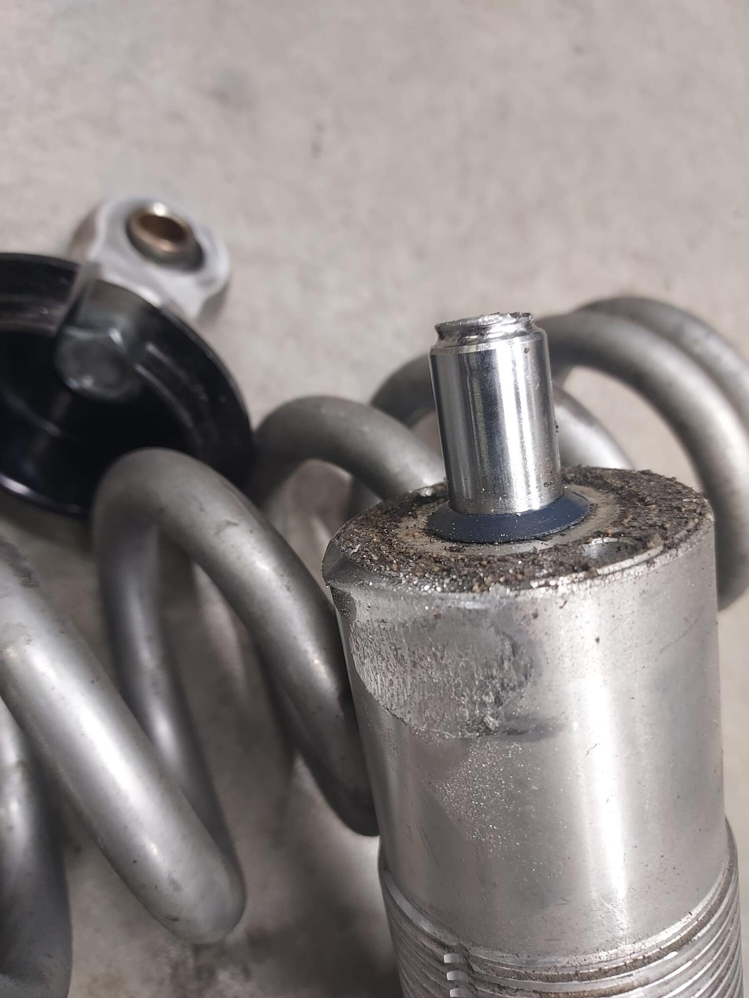

Another day, another broken part... An unknown bind occurring at full compression snapped the shaft on my LF coilover. Damage to the shock body occurred from driving home with it flopping around inside the spring... I didn't realize it was broke, thought it was just a blown shock. Only decently fast way around a right-hander was to be real smooth with the brake, settling it down on the bumpstop before turn-in, and trail braking to keep it on the bumpstop through the middle of the corner.
There was a spot on the frame where the spring was rubbing inside the pocket on full compression. When I checked my clearances, I did not remove the bumpstops, so I think it interfered only when the bumpstops were compressed. I can't remember if I re-checked clearances after changing lower arms either... I did the Chicane mounts in 2019 and replaced the SPC lowers with the beefy new version in 2020. Spring making contact with the frame was putting side load on the shaft. I am NOT blaming the parts for this failure.
