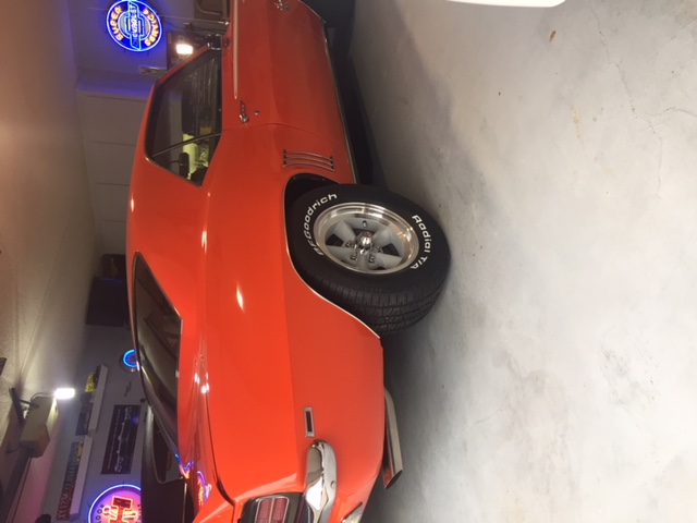

I am looking to replace some tires on my 69 Camaro SS/RS with some bias ply. Right now I am running 215/65/15 in front and 255/60/16 in rear on SS wheels, 15/7 in front and 15/8 in rear. I am wanting the same size tires but in bias ply. I was looking at F60's in front and G60's in rear as a possible option. Need to be around 26" tall in front and 27" tall in rear or close to this.
Anyone running these tires sizes in bias ply on a 69 Camaro? Wondering if F60's will rub in the front? Wish Firestone would make the Wide Oval in a G60 radial. They just don't have a lot of options yet. So looking at the Goodyear's....
