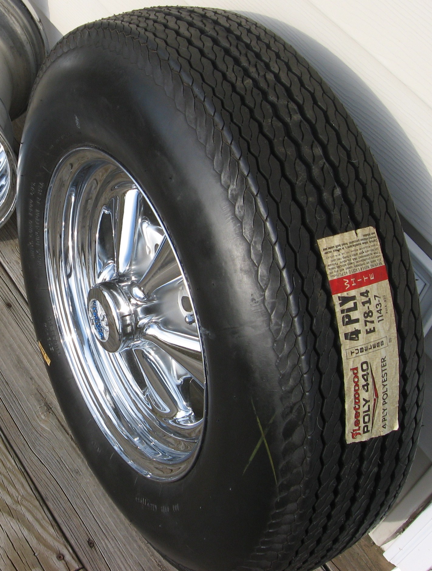

original 14x6 NOS sometime late 70's..with painted lug nut pocket
