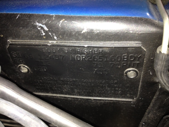

Trim tag picture added. Call or email me if you are an interested buyer. I won't go into detail on the car through the forum.

Seems that if this were me I would want to clear the air in writing and have all of these questions answered.
FYI: One of the questions that was asked about your &quot;unrestored&quot; camaro was if it had spoilers originally. The front and rear spoiler were added. That option would be next to X33 on the trim tag and would read D80.

No D80 on the trim tag of an 02D car. that didn't show up on the tags until later. The car could have the D80 option, but it would not be on the trim tag.

Just an FYI. I spoke with Spencer last week and discussed why it was clearly not an &quot;unrestored&quot; car based on the pics. I had hoped/thought he would have modified the ad to reflect that the car had been restored at some point. As with any purchase let the buyer beware. I think at this point we are beating a dead horse.
