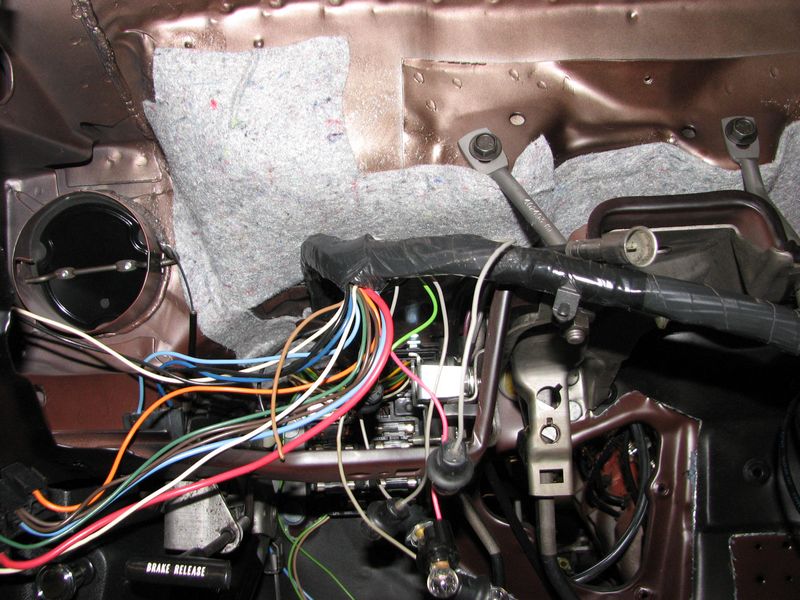

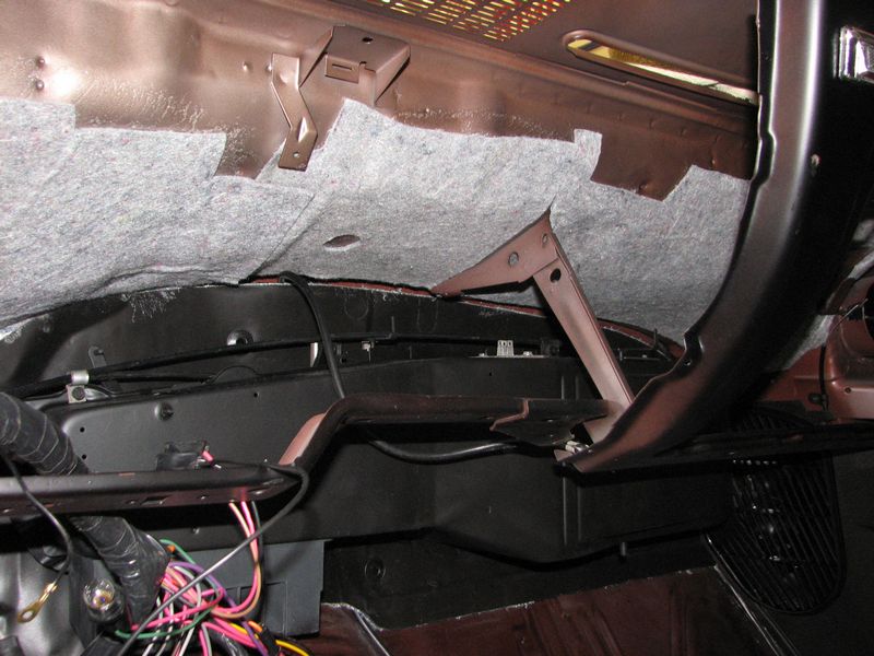

Installed some small misc pieces last night and tonight such as the underdash insulation. Thanks to Mark P for supplying me with the templates to make the insulation as mine was beyond hope. What I used is not the correct material but it last better than anything else and does the job.

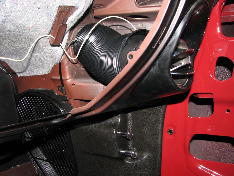

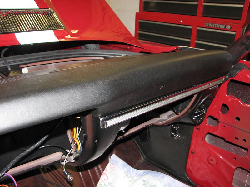

I also installed the right side vent assembly and dash pad. This IS the original dash pad and it cleaned up as good as NOS so I was very happy I did not have to locate one of them!
We also spend several hours sanding and polishing the original antenna and installed it back on the car. Looks much better.

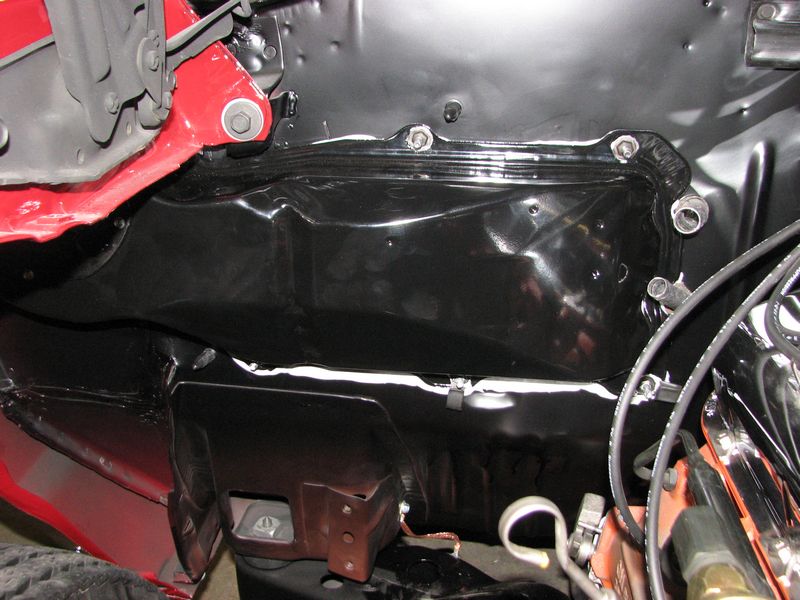

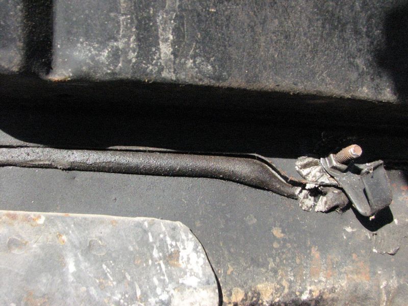

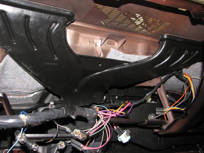

I had installed the heater box cover several days ago and it again kept me awake. I used some grey rope caulking identical to what was originally used but was very unhappy with the results as they just did not match the original so I pulled the cover back off and this time used a tube latex caulk putting an excess on so that it would ooze out like the original. The old caulk looks black due to oil and dirt contamination but is very much grey when looking at the back of the original cover where it was protected. The new caulk looks white in the photo due to the flash but is actually a darker grey. With a little drying time it will match the original perfectly. This time it worked and I will be able to sleep tonight.
