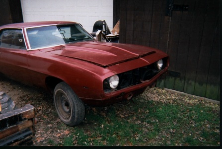

I got a couple of pics...cars is not yet at my place - at a frinds house - I have the title.
Pic 1

I got a couple of pics...cars is not yet at my place - at a friends house - I have the title.
Pic 1

Default Re: COPO Camaro ID
Pic #2...the car had been sitting for approx. 20yrs in a garage until being found/removed - what ever you want to call it. I am in process of trying to track down past owners and gather as much info about the car as possible. I haven't seen the car in person yet - the pics were sent to me...the rest of the pics showed the "good stuff" - like rust spots in trunk and floor.
I'll get more/better pics up as soon as possible...
