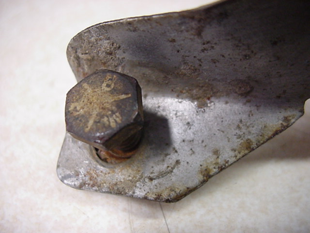

Heres a galvalized close up....
John Brown

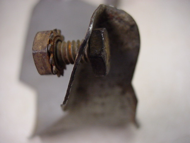

picture 2
John Brown

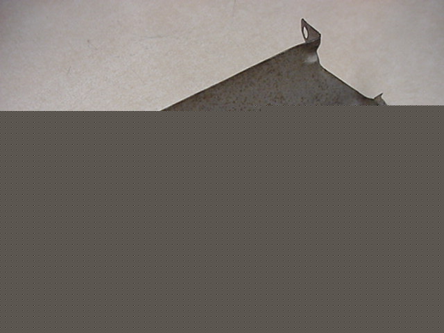

picture 3
John Brown

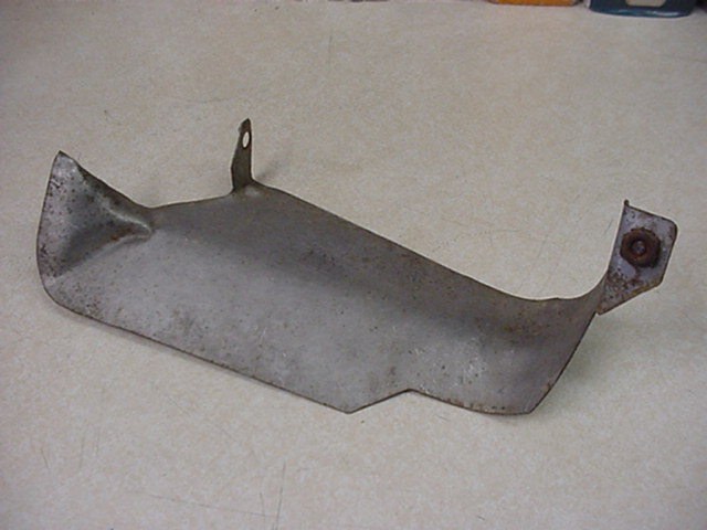

last picture..........
John Brown
  #35
Old 10-06-2004, 04:20 AM
nuch_ss396 nuch_ss396 is offline
Join Date: Oct 2004
Location: Western North Carolina
Posts: 1,713
Default Re: 69 big block starter heat shield
John,
Great images of the shield! You-da-man!
What car & build date did this shield come off of?
Galvanized steel- huh? So much for the stainless steel
only issue? I wonder why some were stainless and yours
is not. Production use vs. replacement item perhaps?
Anybody care to chime in on that?
Steve
  #36
Old 10-06-2004, 04:42 AM
John Brown's Avatar
Location: South Bend, Indiana
Posts: 2,820
Thanks: 455
This is a swap meet treasure. The guy I got it from had no idea what it came off of. He was just cleaning up his garage. I was glad to help him out.
John Brown

  #38
Old 10-06-2004, 05:43 AM
NCGuy68 NCGuy68 is offline
Join Date: Mar 2003
Location: N. Carolina, Wake Co.
Posts: 677
Is the shield stainless or galvanized?
Its a no-brainer!! Galvanized steel is magnetic, stainless is NOT. Use a simple magnet if in doubt.
Keep in mind that GM always used two different part suppliers to avoid interuption at the final assembly plants. Its possible that some cars got stainless and others got gavanixed.
Craig S.
"I saw Elvis At 1000 Feet"
John Force.
  #39
Old 10-06-2004, 09:02 AM
bbdon bbdon is offline
Join Date: May 2000
Location: Santa Rosa, CA, USA
Posts: 382
Some kinds of stainless steel are magnetic, others are not. My heat shield certainly seems to be stainless, it is nice and shiny and has no rust or pitting. But it attracts a magnet too.
  #40
Old 10-06-2004, 09:11 AM
Steve Shauger's Avatar
Administrator
Location: Long Island, NY
Posts: 5,650
Thanks: 2,715
Thanked 9,233 Times in 1,844 Posts
Yes some stainless is magnetic, it depends on the nickle content. I believe 304 stainless is non-magnetic.
