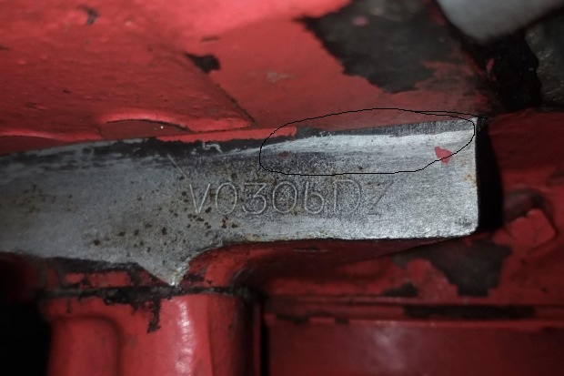

I would like to hear from Kurt on the engine pad. I think it looks good, but I don't have the resources he has. Has Jonesy chimed in here? He has a pretty good database of stamps as well.
I think guys are seeing some discoloration (circled in the pic below) and jumping to the conclusion that they are grinder marks. I see all kinds of discoloration on pads that are not painted. I don't see where it has been ground out and restamped.

I dont see that this pad has been ground out. I think something was wiped on there to try to make the numbers look more readable.
The engine pad stamping looks just like similar V0306 stampings I have. I think its legit.
The transmission stamping looks fine also.
I have yet to see the rear axle tube stamping.
02D went into March. If you have a large enough database of cars you can see this and the dates on drivetrain components. This was not the norm.
I know of other cars built 02D that were built quite a bit after this one. That is not normal either.
I think I will just be quiet about revealing anymore than I already did.
I know Kurt has seen the POP and says thats okay too.
