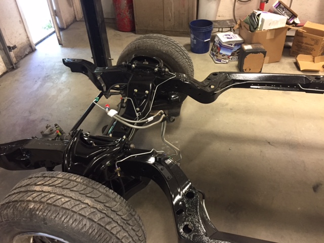

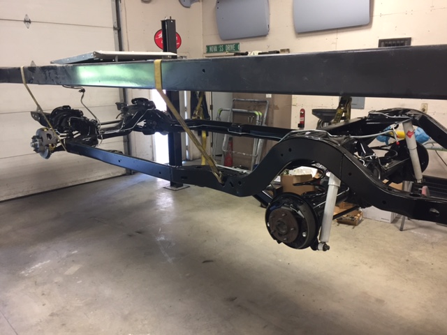

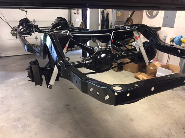

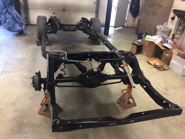

It has been about a month since my last post. Frame is completely assembled and ready for the body. Once back together I will start the front end body work and get some color on it. It's coming along. I feel I have worked out all the problems the last body shop created for me hopefully its smooth sailing from here on out! Not a concourse frame the owner will be driving this car. I feel it cleaned up nicely.

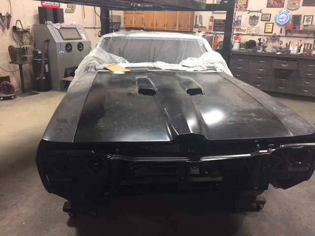

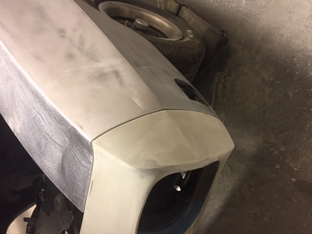

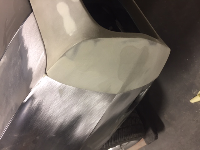

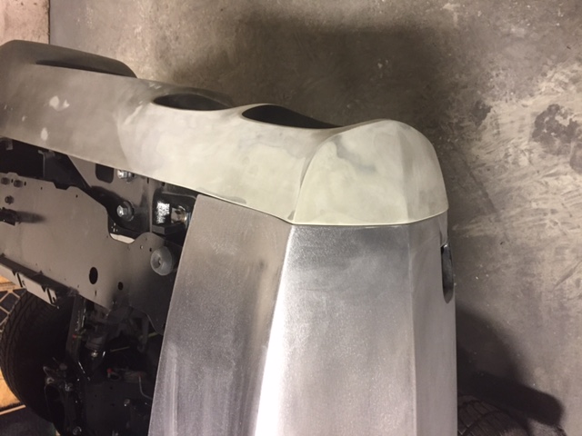

Time to start mocking up the front nose.
Looking for the next project.

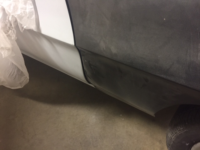

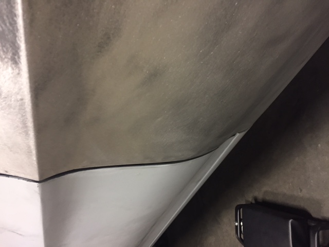

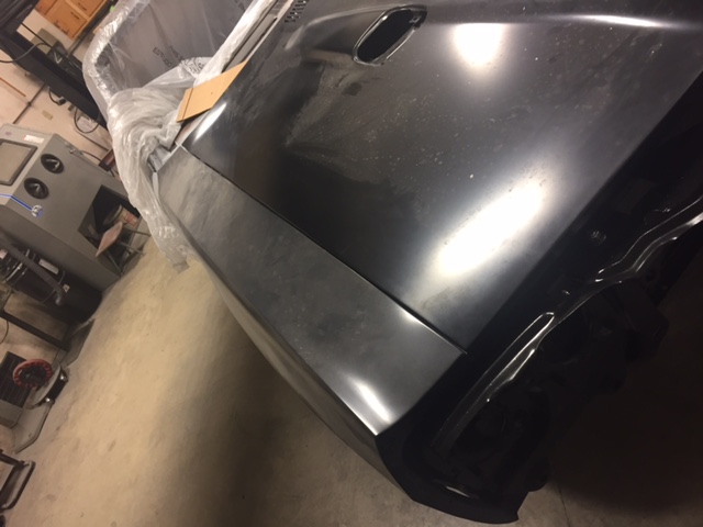

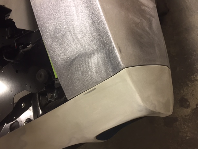

First round of test fitting the new sheet metal. Overall fitment is OK, but you know all this aftermarket sheet metal needs rework to get all the body lines to line up. The hood actually fit real nice it was the fenders I will have to rework. The door to fender radius is way off you can see this in the one picture and when I fixed it. I had to drill all the spot welds along the fender edge relief cut the sheet metal, pull it out, and re-weld.
Now when the rubber nose was on the car the top edge of the fender was way to high but was fine at the hood edge. I had to drill out all the spot welds along the front of the fender and push the top edge down and re-weld it to the inner frame of the fender. One fender completed in just about 6 hours. Lots of test fitting to get the fender to line up.
