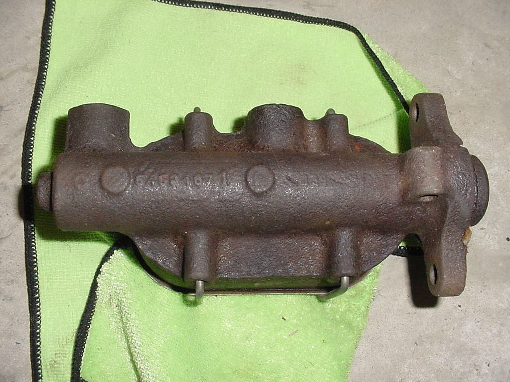

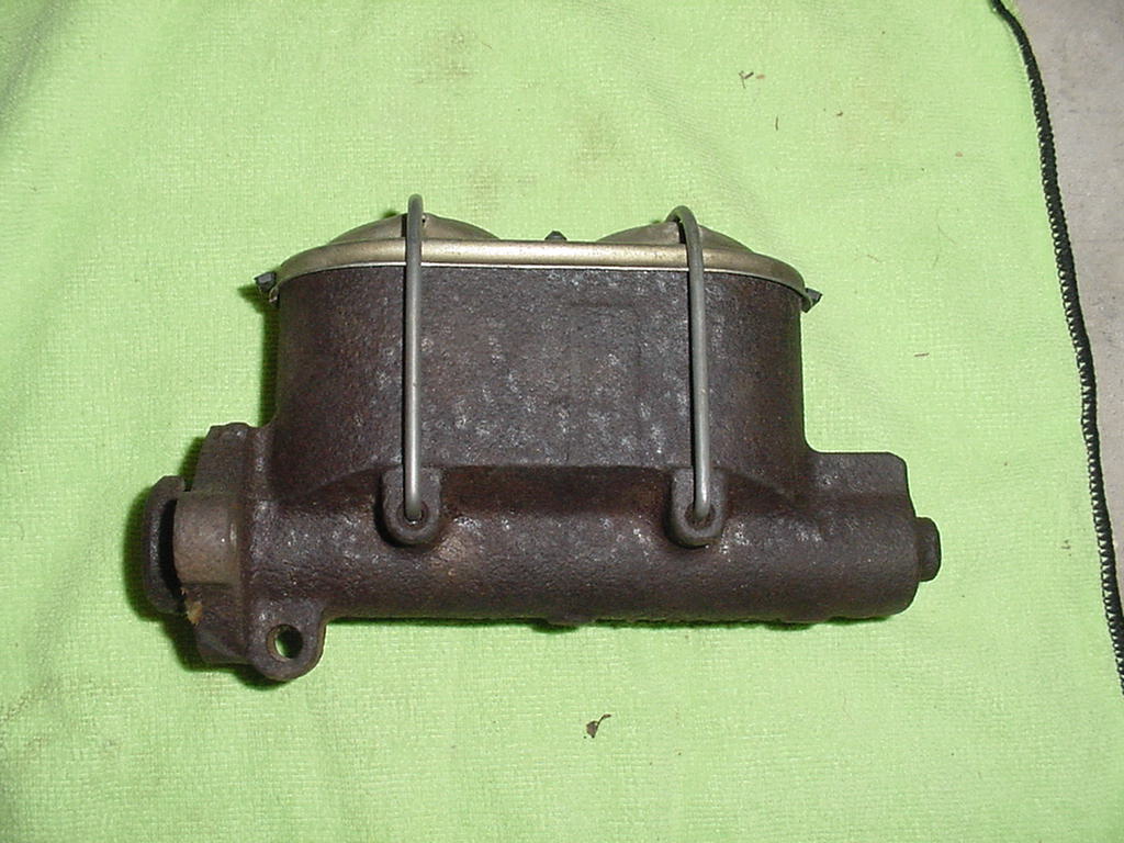

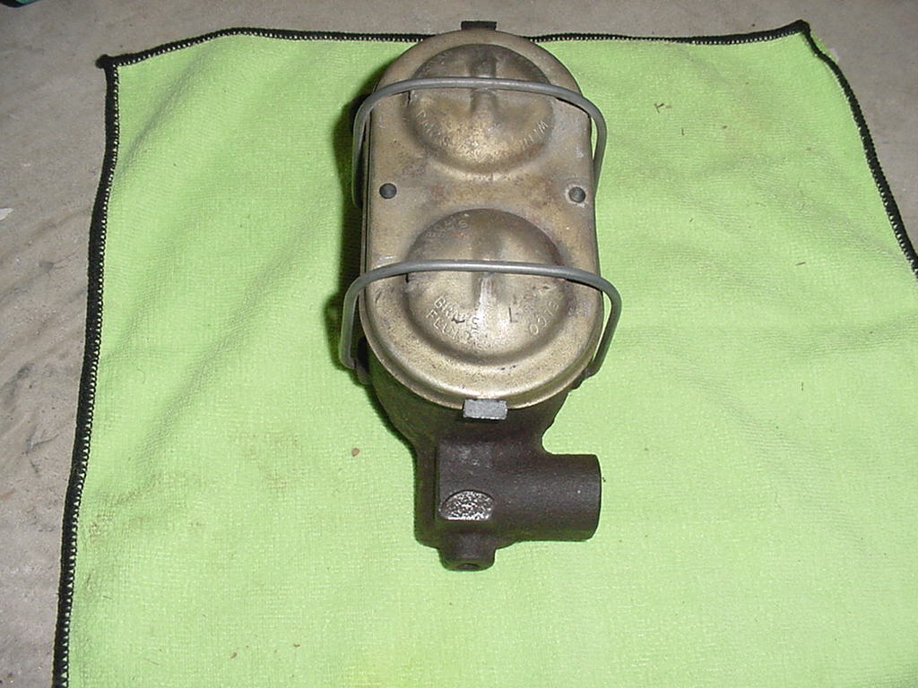

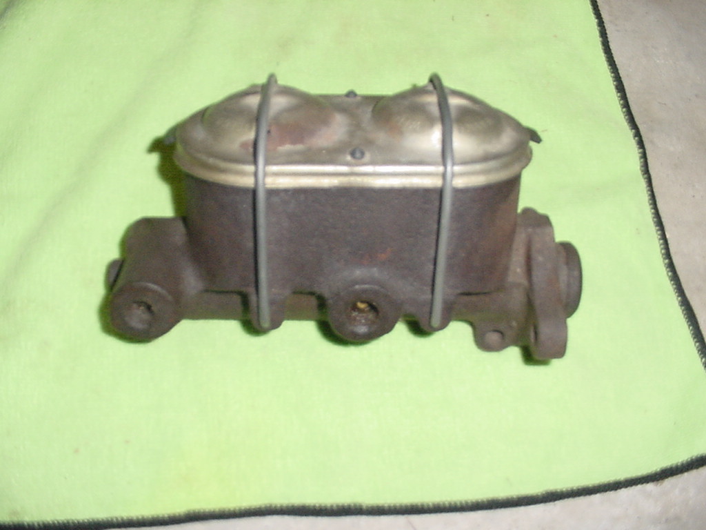

Hi is this the correct master cylinder I need for J52 brakes has part # 5459467 can not read the letter stamped on flat part
  #40
Old 02-01-2014, 04:46 PM
67 Nova Boy's Avatar
Join Date: Dec 2009
Location: Lansdale, Pa.
Posts: 3,342
Thanks: 18,891
Default Re: 1967 Camaro with j52 option
Yep...that is the one. Code will be "AD" 1" bore and no bleeders.
