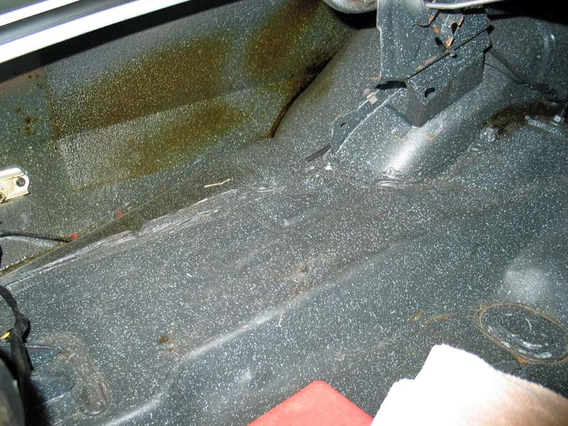

I have done several searches and (surprise suprise) get conflicing answers. Not in a huge hurry, but am putting my car together. It isn't 100% correct, but pretty darn close. Only 27,000 miles, but far from a survivor. The only thing it survived was a couple of teenager owners who beat the crap out of it. 08A car if it matters.
Very few mods, although I am doing some day two "bolt ons" that could be easily removed (headers, traction bars, bolt on subframe connectors and the like).

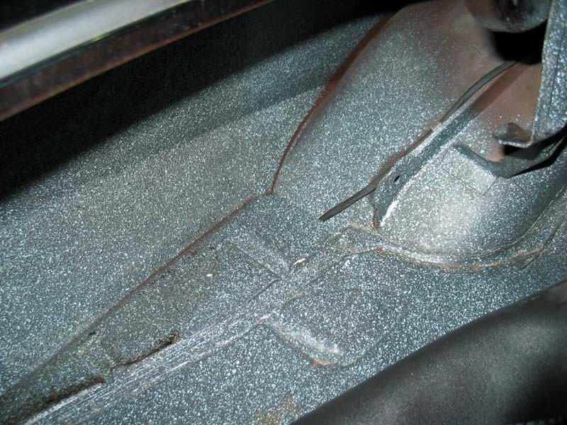

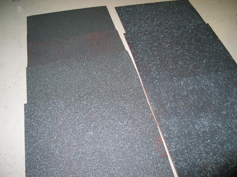

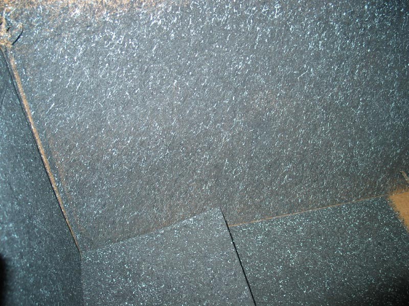

I have some of my original trunk paint still showing. Not sure how to replicate it.

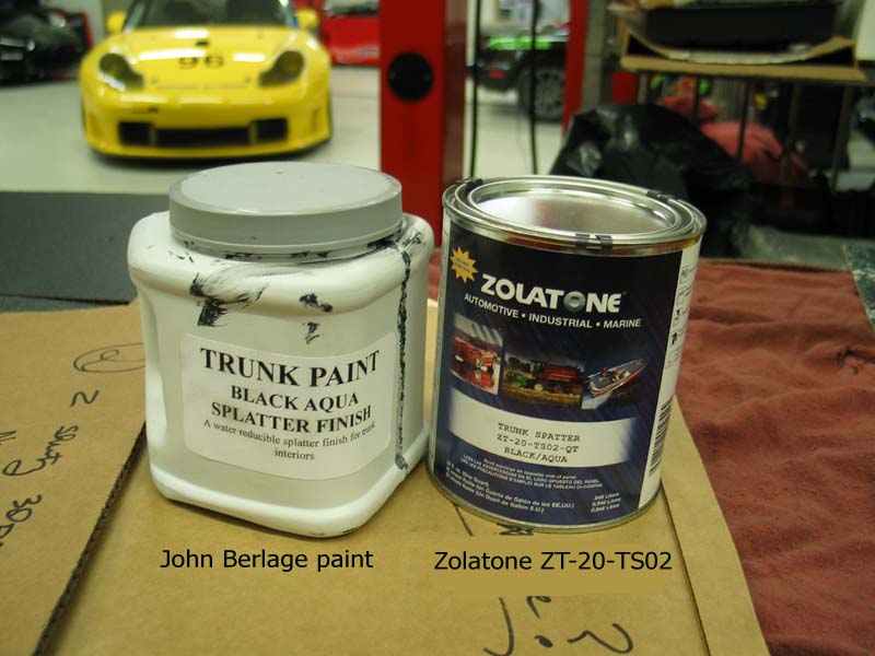

What are you heavy hitters using for trunk paint on higher end cars? My understanding is that no rattle can alternatives are worth a darn.
BTW, I had asked about the sound deadener a while back. The 3m Body Schutz worked great to replicate the factory sound deadener in the wheel wells and trunk area on the quarters(although I did not get quite the same squared off look in the trunk. But the build up is dead on.
