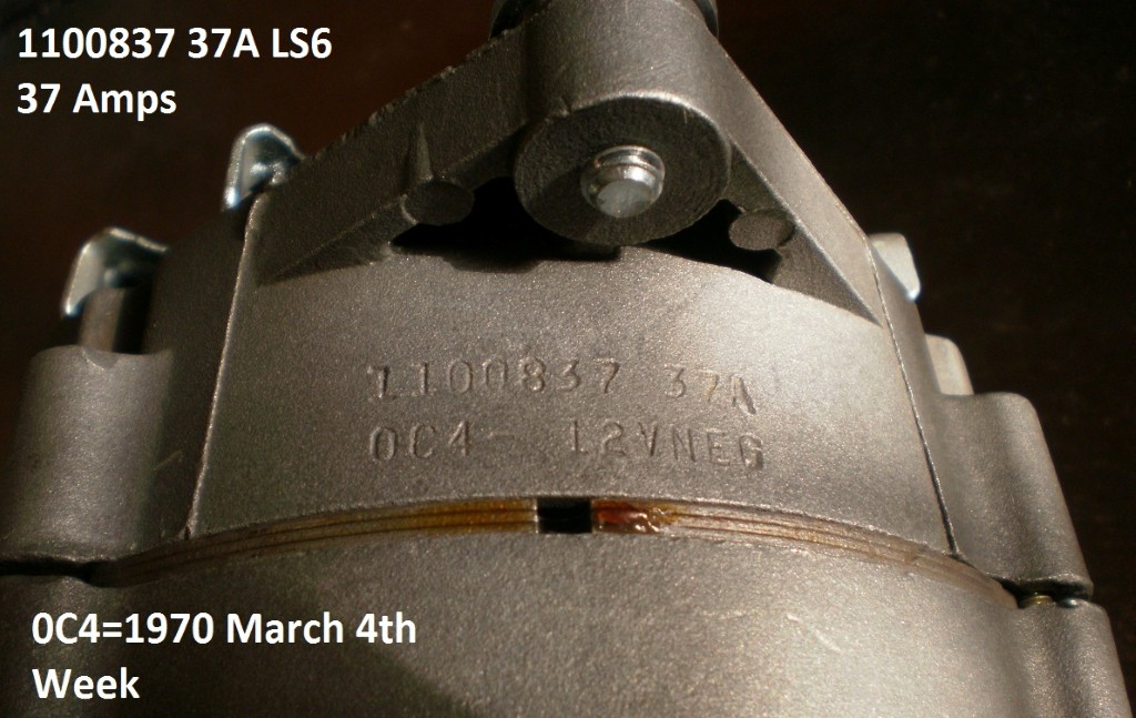

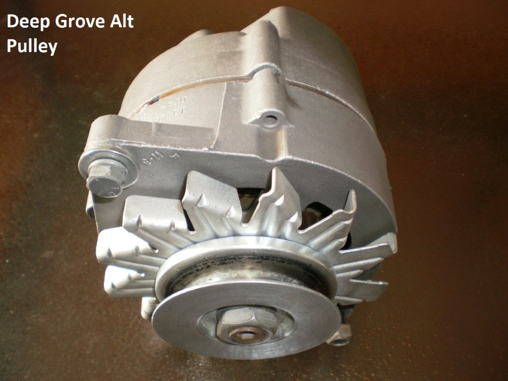

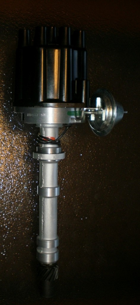

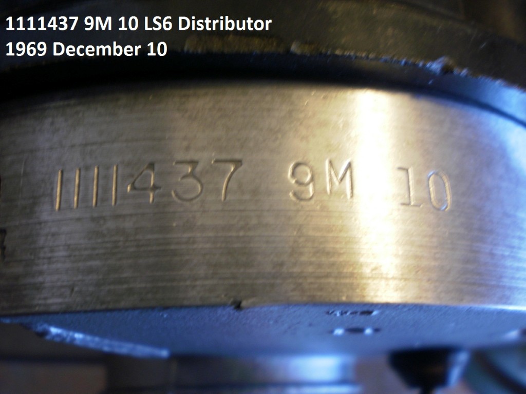

Here is the original Distributor restored by Jeff Dotterer with certificate.
Also photos of my Original Alternator.
Yesterday i was busy restoring the Wiper Washer Motor which came out fantastic,i will post photos later of that piece.

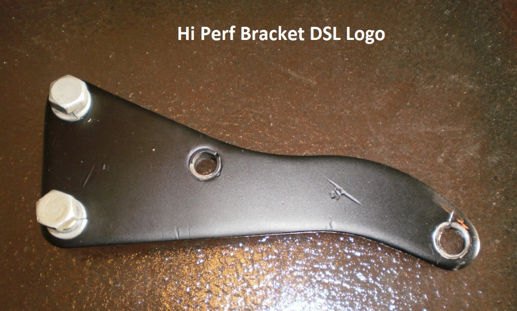

Question, Does anyone know what the &quot;DSL&quot; logo means on the Waterpump to Alternator bracket?
Also why does this bracket have a special fitting in it,is it a support hole for the smog pump?

Question, Does anyone know what the &quot;DSL&quot; logo means on the Waterpump to Alternator bracket? </div></div>
digital subscriber line
<span style="font-weight: bold">its a bushing, so the alt. belt lines up.</span>

Thank you Donnie and Steve for that Info.
