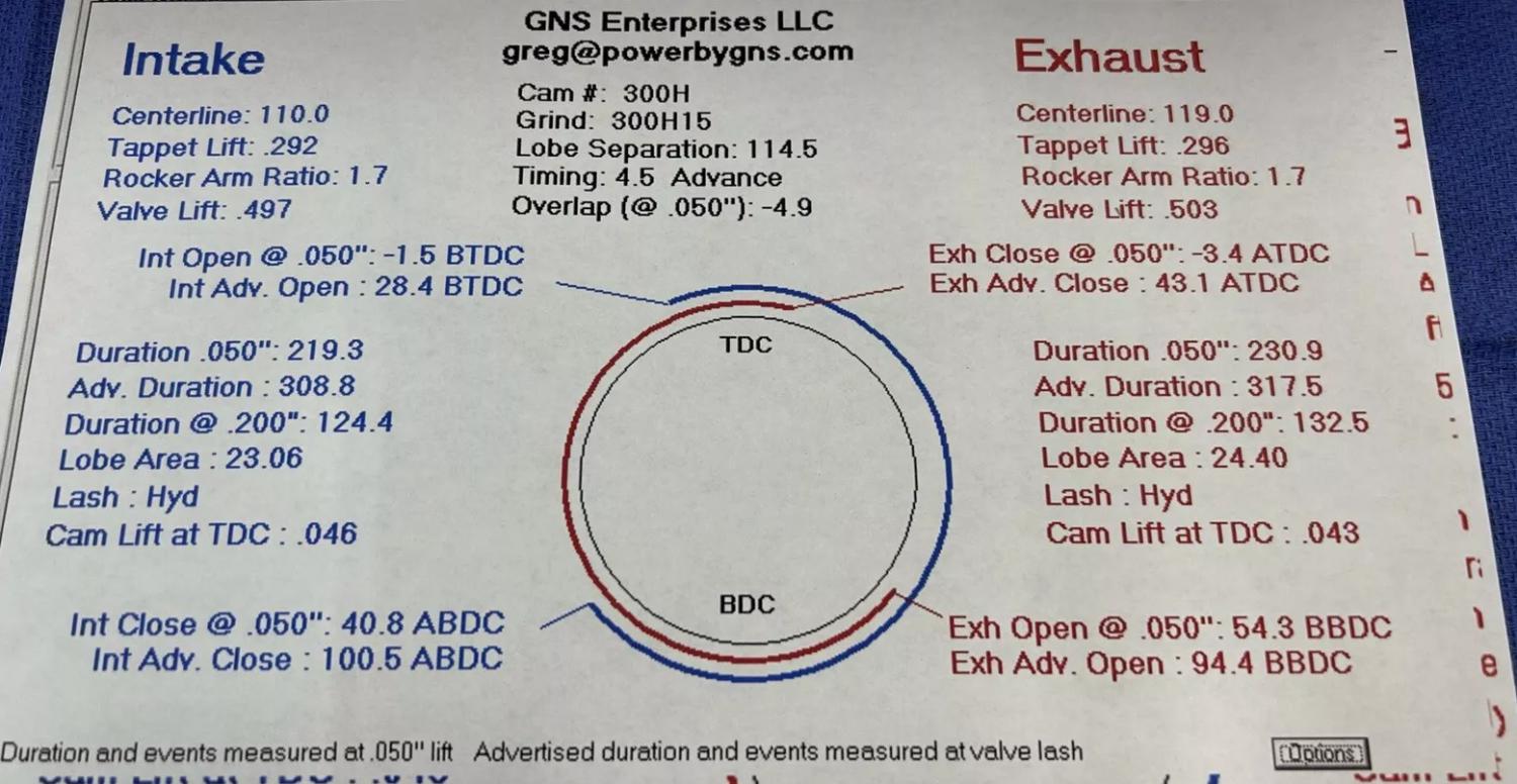

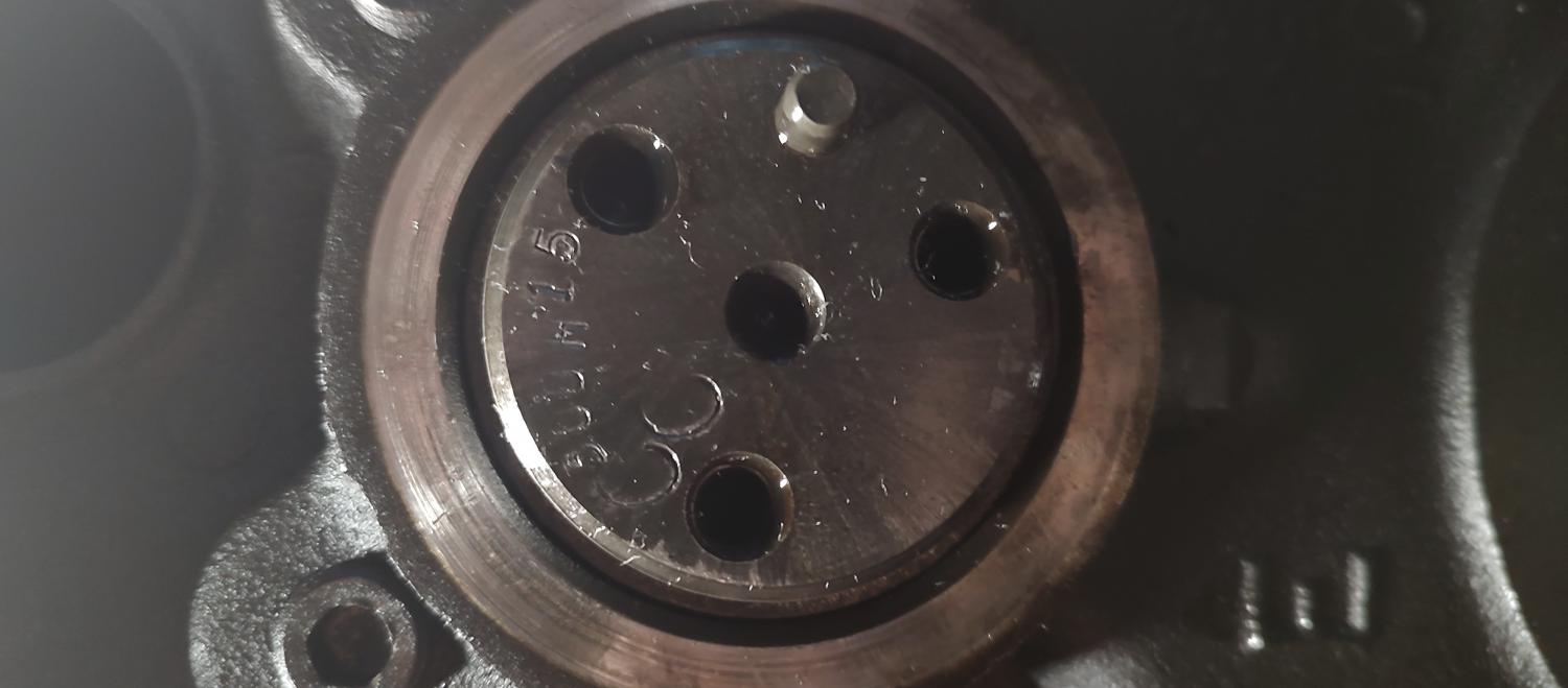

I pulled the timing cover. The cam is not a 305H, it's a 300H. Much, much milder than I thought. Compare this to the 305H's .575 lift and .253 duration @ .050 and a 110 LSA versus the 300H. It doesn't look like this grind is available anymore, either, so I'm not 100% sure what I want to do.

That looks like a nice street cam. If you can swing it, a roller conversion would be the best insurance against cam failure again. I'm sure there is a cam that is close to, or a copy of, this grind, If not others have called Erson cams and had one made.

There's an NOS one on eBay and I'm really, really tempted to pull the trigger. I'd imagine a vintage, never used one would help circumvent the issues going around with softer cams, no?
