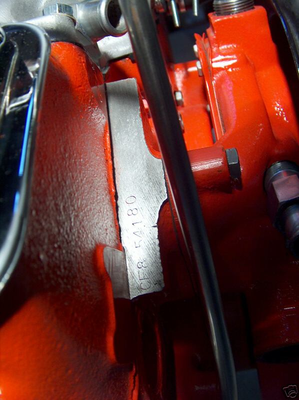

Is this a CE restamp?
Pat Railsback
67 0-1 Camaro L35/M40/3.07
it looks nothing like mine!

NCRS does not treat CE blocks any different than any block. The casting number must be correct for the year of the car and the casting date must be before the build date of the car to avoid a point deduction, period. If you have a '67 big block Corvette, the casting number needs to be 3904351. A 512 block would receive a 350 point deduction if it had CE stamped on it or if it had JE (435 horse L71 motor). They don't care if the motor was replaced by GM under warranty two years after the sale of the car or not. If you had a warranty motor that was replaced in a '67 Corvette six months after it was purchased and the block carried the 3904351 part number, but the casting date was three months after the build date, you receive a 175 point deduction. There is no special treatment for a CE block or a block with no stamping at all.
It's a very simple and fair set up. I'd be upset if some guy showed up with a '69 Corvette with a block dated one year after the build date of the car (CE block) and he received the same lack of deduction as my original engine '69 Corvette.

I might be wrong but under the current judging standards would a warrany CE block not be considered second tier to a correctly dated restoration block with a non conforming block pad? I don't think anyone is advocating the CE should be excluded from conventional judging standards as it is obviously a non original component. We can leave that can of worms to the block restamping industry. What would be the detrimental impact of embracing the reality of the CE block and incorporating its specific characteristics into judging standards? I believe it would bring some nice examples to the show field. Under current conditions why waste the time and energy?
