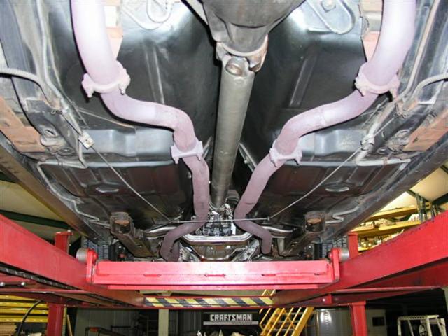

Its one thing to choose to install repro parts instead of popping for expensive NOS or original stuff, but I have to take issue with the parking brake cables. If the builder of this car routes these below the exhaust system (yes he did), you gotta wonder what else might he might have messed up.

At the expense of not knowing what I am talking about. I thought the parking brake cables did route below exhaust system. I also thought the 5-spoke SS wheels came on the early production Camaros and were stopped around the same time they stopped the chambered exhaust. My biggest pet peeve would be the gauge package with out the clock otherwise it looks like a nice car.

Brake cable routing.....

OK, guess I was off on this one. I need to get some more sleep :konk:

OK, just realized that I'm so used to looking at Chevelle undercarriages that I was expecting the cables to run between the floorpan and exhaust on this car, which is the case on Chevelles but apparently not on Camaros.

I won't get into all the junk wrong with this car, you guys have covered alot of it, E cables are indeed routed wrong.
